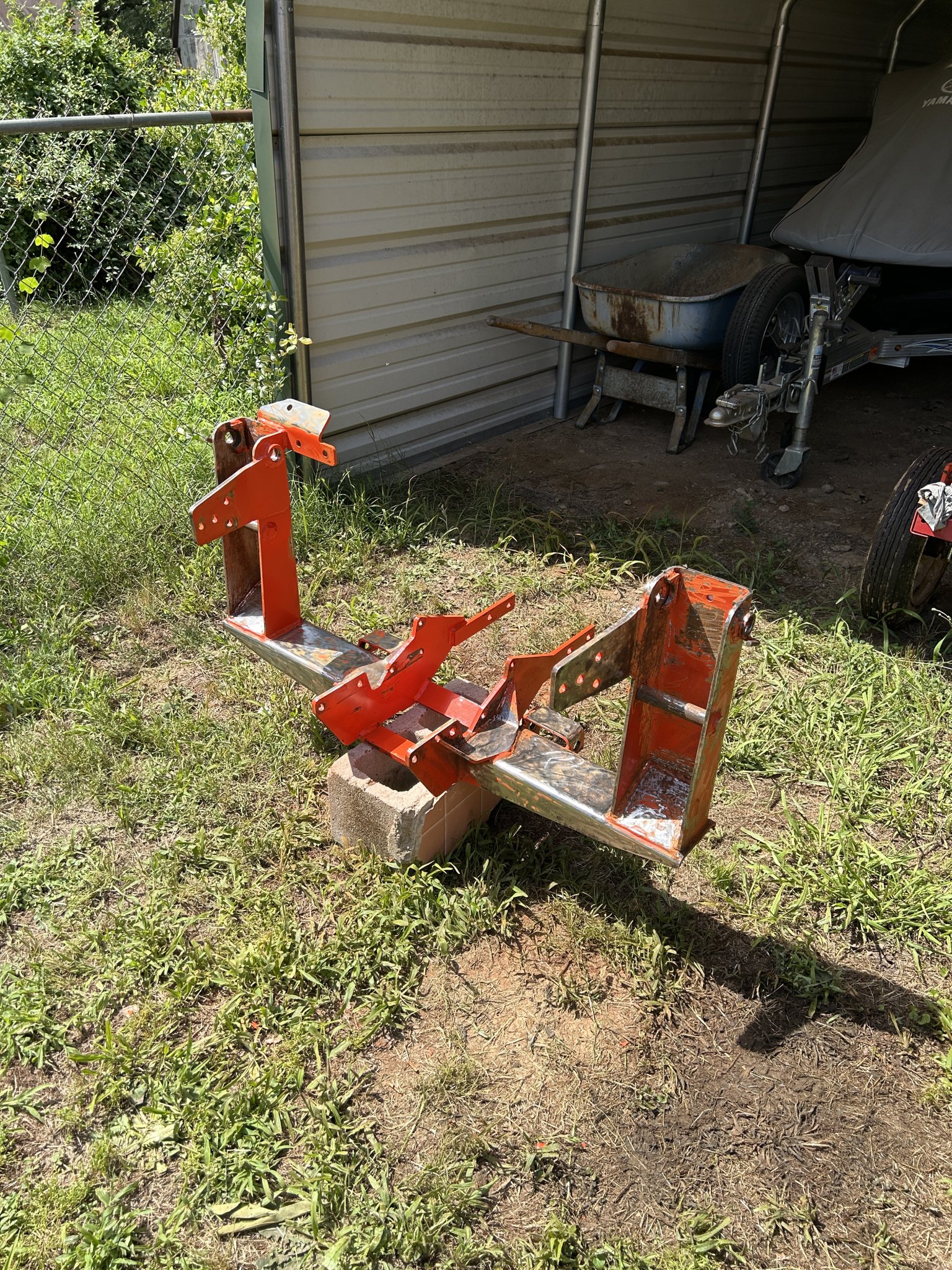

I need to do some paint removing on loader bracket/brackets, as there is alot of peeling , rust going on. once i get that done, i'll re-paint it kubota color ( if i can find some ? ). then get it mounted onto my b2100 frame. lower pic's is my b2100, i've put many of hrs and cash into fixing the hydro unit on her, then tires, rims, reg.rec, ignition switch, battery, engine oil, hydro oil, few seals, air filter, fuel filter, pretty much brought her back from the field it was sitting in when dead ?!.

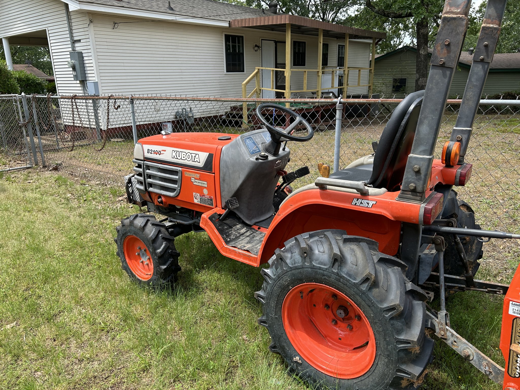

update: got the b1700 in the shop, started tearing it down. nasty valve cover !. but..if ya look real close at the pic of the front valves, what stands out ?..i seen it right when i lifted the valve cover off...the intake and exhaust valve rockers are not even on the push rods ?!!!. is this from something bad down in the engine ?, or..is this something common on these old engines ?. the two pic's of the fuel injection pump area, sure has a lot of fuel around there. would this be caused by the front cylinder not firing from no compression ?.

kinda forgot, lol..after getting the rockers all back to where they were suppose to be ?, set them..she fired right up..and sounded like it should sound ?. if this is all that was wrong with it ?, i scored big time. PO claimed blowby, low compression on cylinder #2 ?, not sure if the front cylinder is # 2 ?, but it sure don't help when you have a dead cylinder !..lol.

thank you wolfman for the info !. will run that test sunday. as for the find and fix, it was pretty easy to spot the rockers off the push rods and valve springs once i removed the valve cover. i'll post results tomorrow on the injector test, i sure hope this was the problem all along?, if it was ?..then yes..i scored a home run on this tractor.

i was in the process of tearing the engine down, was told it had blowby, # 2 cylinder was low on compression ?, soo..i started by removing parts to get the rocker arm cover. when i lifted it off, very first thing i seen was the front rockers were not even on the push rods ?!. well..i can see why it was '' so called low on compression'' alright ?, dead cylinder !..lol. it wasn't cylinder # 2 though. i put the rockers back on the push rods, adjusted them, crank it over..she fired right off..sounded much better than it was running.

i spent the past couple days removing the loader off this b1700, its sitting in the back yard, waiting on me to install it on my b2100. i want to clean up some rust spots on the mounting brackets that bolt to the frame, and give it some fresh paint before i go installing it.

update: ok, got the loader mounting bracket all washed down, grinded the bad rust, paint off, then sprayed it down with kubota orange, sheshh..25 bucks a can from the dealer ?!. used one can so far, gave it a nice good base coat. will hit it again later on. here it is after the grinding, then some painted pics. got the b1700 engine oil changed, engine oil filter changed, hydro oil and filter changed, had to order the air filter, and that pesky odd o-ring that goes on the deverter block under the cap that has 2 bolts that cover the deverter block. did all that, then started in on this part of the b2100 loader work.

Looking good. Before you know your long awaited dream will be a reality
