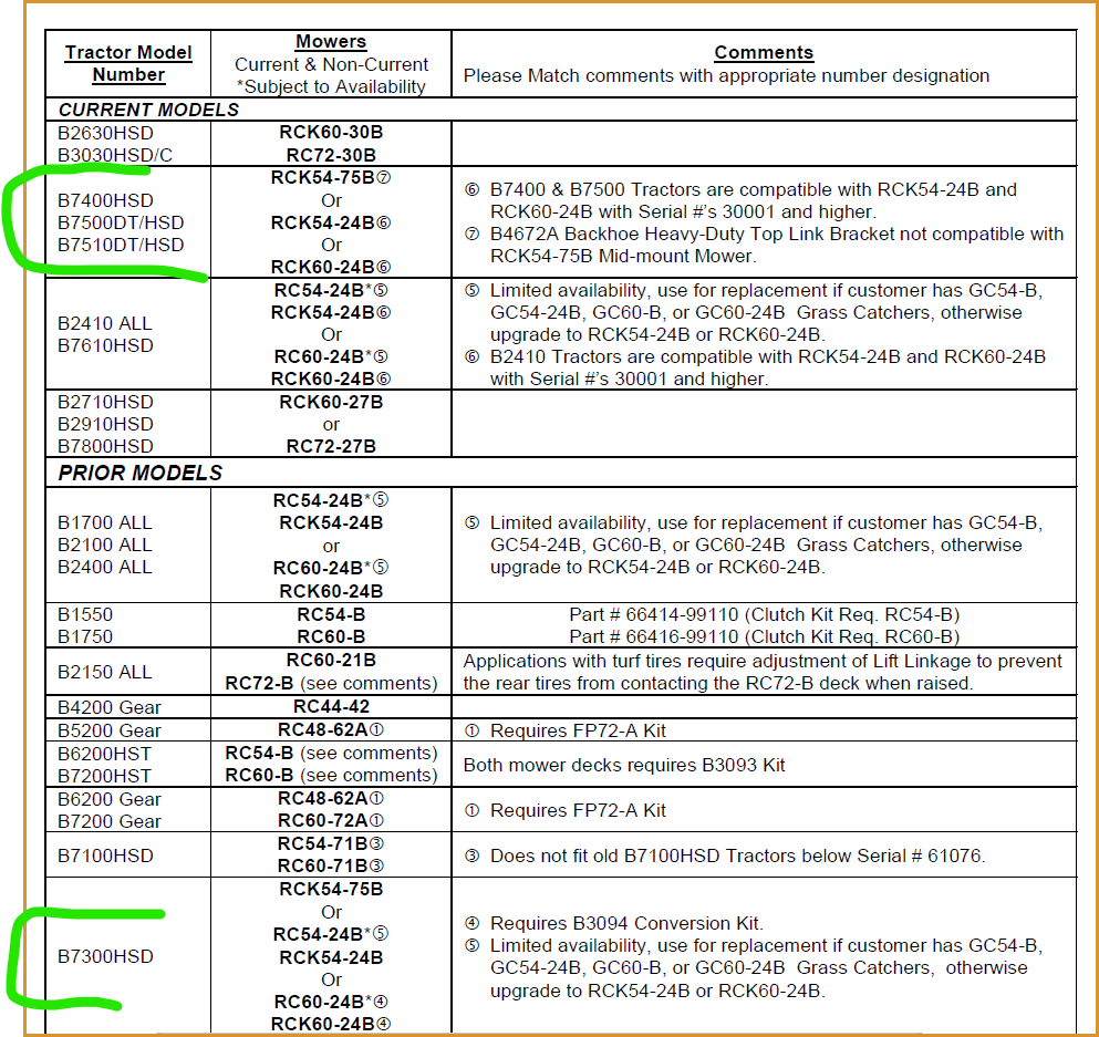

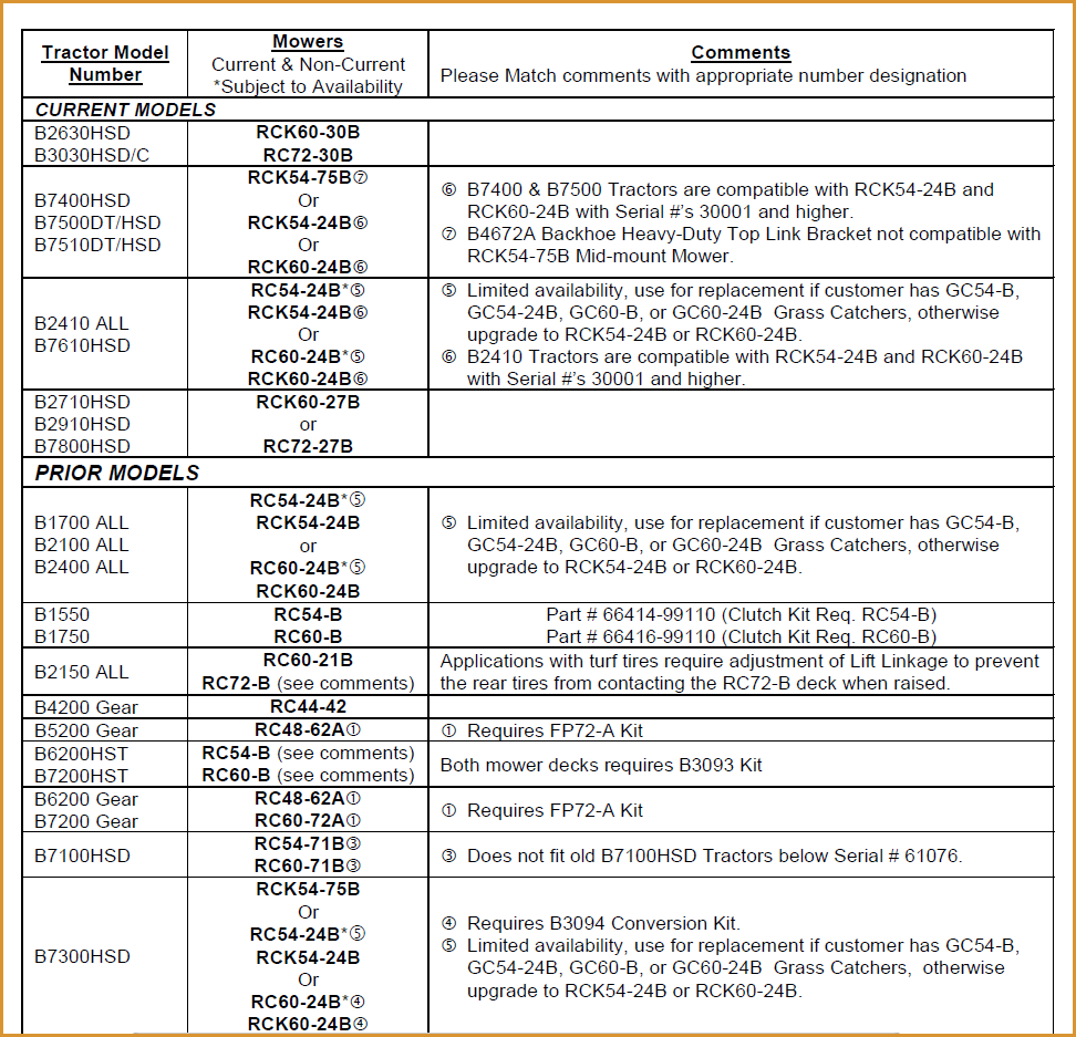

You might look at the B7510HDSD as well. Compared to your B7300 the B7510 is:
  1. Newer - B7510 was made in 2003 - 2008
  2. Has Power Steering standard
  3. Substantially more engine and PTO HP (1000cc vs 700cc in the B7300)
  4. Has nearly identical wheelbase of 59"
  5. Weighs 1367 pounds (vs 1312 pounds for B7300)
  6. Has same size front tires
  7. Has bigger (9.5-16) rear tires
  8. Often for sale with the LA-302 loader - somewhere around $10k here
The B7510HSD has only a two-range hydrostatic tranny, like your B7300. I use low for FEL work, and High for most everything else - no issues.
This site has a good summary of all the specs of the Kubota tractors:
Also, the B7510 was offered with the RCK-54 mower - maybe the same as your B7300?
