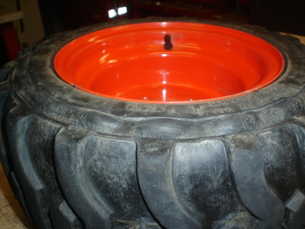

Had great plans to work the BX23S all weekend long until I spotted this....
... 19 ( yeah I counted them) soft huge pimples on the left front...arrgh..., so I checked the right front...sigh... same problem just not as bad.
Kubota dealer says, sorry ,out of 1 year warranty( by 3 months..) but contact tire mfr....
so I had to buy 2 new tires and rims( cheaper than tire only).
So, I have 3 days of work to do, today, as rain is coming for the next.....
sigh,
dbl sigh.....
Anyone else have this weird pimple thing happen ??

Underinflated maybe? Looks like cord slip from overloading / under inflated

I've had it happen on trailer tires before. Was told they were over loaded or over speed.
Relocating from Ontario to Nova Scotia cost me a few tires. Mind you it was probably 5-6 trips over two years, and 110km speed limit warmed them up a little!
As far as yours, like flip said probably underinflated. If you have new tires and rims on the way, run them till they blow. You've got nothing to loose. Just be extra careful with heavy loader work, if a tire blows with your loader up it will get unstable in a hurry. They could surprise you how much longer they might last.

I've never seen it before but as suggested I'd probably just run them until they quit. If you're careful you should be fine, most tractors don't travel at highway speeds.

New tires and rims are now installed, old ones had 21-22#...what the sidewall says. Only have 218 hrs on them( 16 months ols..). Obviously no highway speeds..... Only hauled bucket loads of pony poop, mulch and topsoil
The new ones are same brand/make so I'll look real careful in the sidewall for info like 'max load #### at ## PSI'.
There's a 1-800-number I'll try calling tomorrow..(rain day).

I had the same issue with 1 of my front tires also ( beyond warranty). Continued maintaining the air pressure and kept using it until it finally leaked too bad. The other front tire (maintained at the same psi and load use) showed no such bumps/pimples. I believe the bumps/pimples are a manufacturing issue - after I dismounted it and cut it apart it appeared there was a cord/ply separation problem.
I found a pair of Kenda 18/8.5-10 6ply tires for replacements (will support 35 psi and 1000 lb load each), haven't had any front tire problem since.

Hmm...you've got me thinking now. The 'factory fresh' tires are only rated for 860# each and I'm wondering just how much weight we can actually, safely carry and NOT exceed the 860# limit of the tires ? While most of my bucket loads are mulch or dirt, I do haul patio stones and gravel around. I know the loader can proably lift more than the tires will safely carry. It'd be nice to know the REAL load limit. While the loader can lift 4 patio stones, perhaps the tires can only carry 2 or 3 ?? Anyone every see THAT number ?
In the meantime, I'm going to see about those Kenda tires or something comparable.

I believe they are Kenda model K514 tires. I got them off ebay, $95each.
Be sure to check the ply ratings close as they come in both 4 ply and 6 ply. I looked them up and the 6 ply is rated @ 36 psi and 1115 lb load.
You may be correct that the 4 ply don't handle the load as I was moving a lot of gravel, sand and also some loader capacity size logs. As I stated earlier the Kendas are holding up great, don't even squat under load.

My neighbor and I refer to those bumps as tumors. I suspect they are caused by all the loader work since I have another neighbor who has no problems with the tires only difference she hasn't mastered filling the loader bucket yet. Don't feel special the neighbor who shares the tire issue has a JD,, he and I have somewhat of a competition going to see who uses the most front tires in a year, he's ahead of me, must be because the JD has a 53" bucket to my 48" .

Put tubes in them and keep on running them until they are worn out. The bubbles come from poor tire quality allowing air to escape into the different layers of the rubber. Tube will contain that air. Eventually the tire will give out but way lot cheaper than buying new tires and rims.

The effects of heavy loader work on tires can be offset with the appropriate 3pt ballast.
I would definitely send pictures to the tire manufacturer asking for support.

so far no reply from 'Garden Master' , teh mfr of the tires...
guy at Kubota Canada is trying to figure out the ACTUAL 'payload' I can carry with my BX23S. even though the loader will lift 700#s, tires only good for 1720# and BX23S weighs in around 3,000#... Yeesh, this should be real simple for Kubota to figure out. If I had a 1,000# weigh scale , I can do the math in 5-6 minutes....

update : Kubota Canada is reversing the charges ( $250) for the 2 new tires/rims I bought last week ! I still haven't heard what the 'payload' weight my BX23S can carry but at least I'm getting new tires/rims for free !! I'll have to put the 'bug in their ear' later this week. I just got 2 BIG dumptruck loads of top soil delivered and that'll be 100s of trips back and forth next week, after the rain comes tonight...sigh...

I wonder if putting tubes in would actually help but my gut says no...

edit: Kubota says the BX23S will carry 750# minus bucket weight(150) so... 500 # of dirt or steel payload !! When I get time, I'll build a 1,000# scale and SEE just what weight is on the fronts.

Those bumps are factory defects and Ive seen them on cars too, right from new. If you caught them right away you might have argued enough to get a new tire replacement under warranty but even then it would have been a fight. Trying to get tire manufacturers to honour warranty is like getting 3 tab shingle manufacturers to honour their warranties.

I didn't waste my time trying to get warranty on a 1 year old tire, for 76 bucks and 10 minutes at the tire machine problem solved. Inspection of the failed tire showed exposed and frayed cords on the inside of the tire about 3 inches long in the area of the fail. Sometimes it's just easier to take the path of least resistance.
