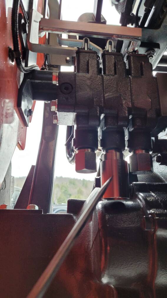

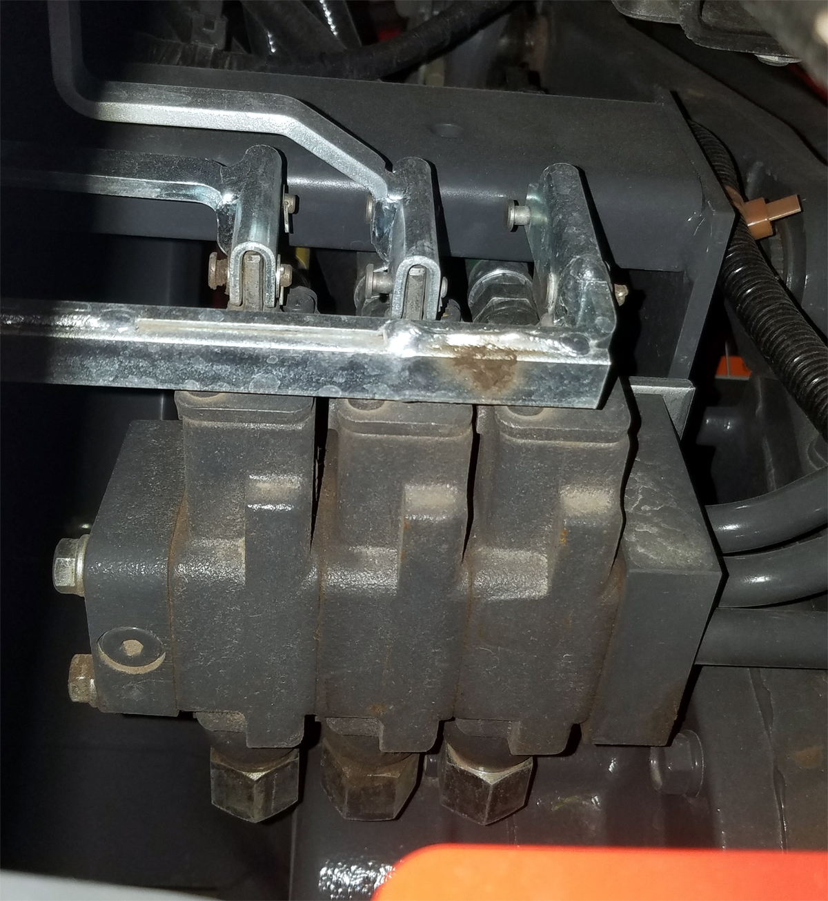

On the MX, only 2nd and 3rd can have float. The valve has a big ol nipple on the bottom that would hit transmission/axle if put in the 1st position.
My 3 are all spring center.

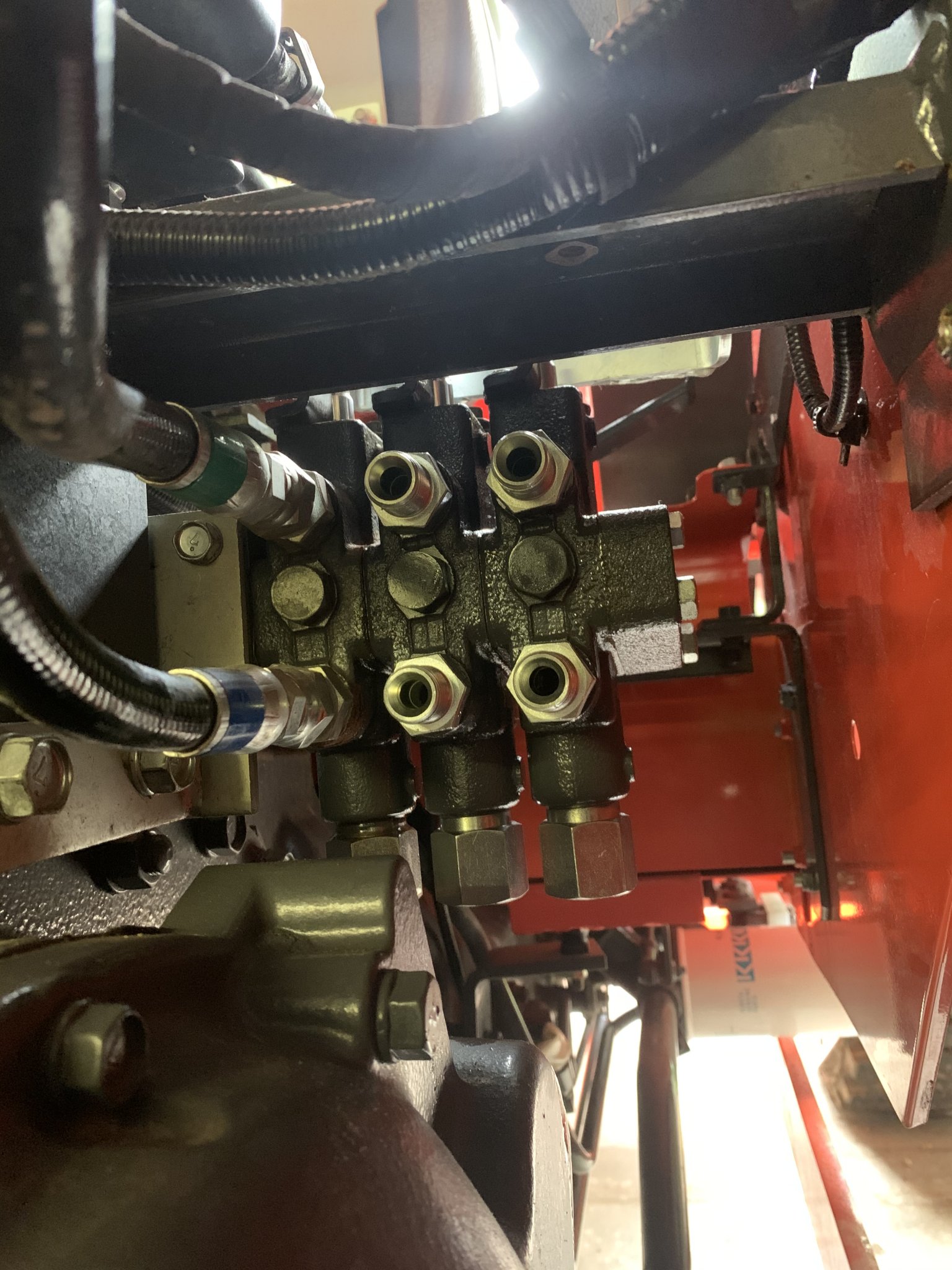

This is the view of the rear remote valves from the other side. All shown are spring center but I'm not following your point. I understand what you said but a photo showing the "big 'ol nipple" would be helpful. I've looked for an image of the float valve that will be installed but haven't been able to find anything yet.
It's academic but interesting. I'm going to stay with having one rear remote with float on the new MX although I have half a mind to call the salesman and annoy him even more by asking him to swap out another spring center for a float, particularly since they act as spring center if needed. I like options, what can I say. 😂
The float valve I have seen, sticks out another few inches where the lower nut is on our 3.
Good ol google came through.
Thanks Matt, that's very helpful. I sent a text to the salesman asking him to add a second float valve only if it won't delay delivery and if it won't piss someone off that could delay delivery. 😂 I just don't see a downside to having two and I'd rather not have to revisit the rear remotes.

The dealer called me this morning and told me that on the MX and L60 tractors, you can only have a float valve in the #2 position. They had run into this situation previously where someone wanted to have a couple of float valves but couldn't. I asked why not #3 but they weren't sure as to why but just that it couldn't be done.
6,883
3,321
Probably no clearance for the 4th position on the spool.
