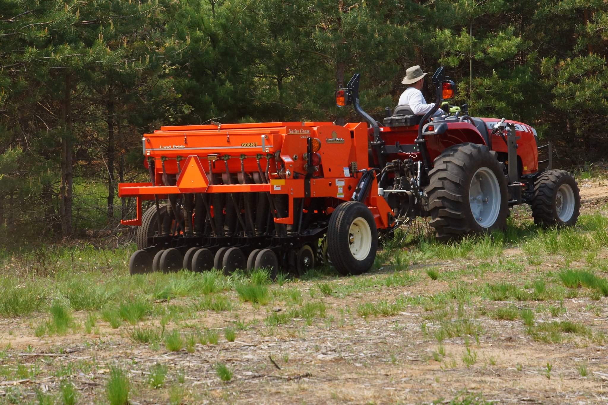

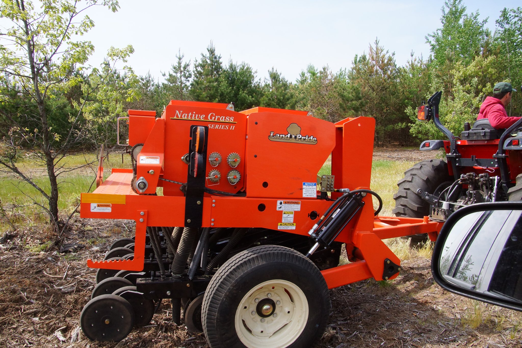

I can show you a picture of the habitat contractor that seeded my land with a Land Pride seeder. This one would seed from large seeds all the way down to the smallest and or fluffy seeds. This seeder had 3 boxes.
That's an awesome seeder, and probably a fair bit more than the Woods model I'm looking at.
I'm not even vaguely thinking of something like this, but it's in the ballpark of a new Woods.

If my memory serves the contractor mentioned something close to 40k the way the seeder was configured. He is a one man show , forestry mulches, herbicide spraying, seeding and maintenance mows native plantings. All his equipment is kept in top notch condition, he shows up at the site ready to work with little downtime. He stays booked a year out in most cases.
I have no doubt with your equipment and the way you maintain them if you decided to get into no till/drilling you would stay busy!
