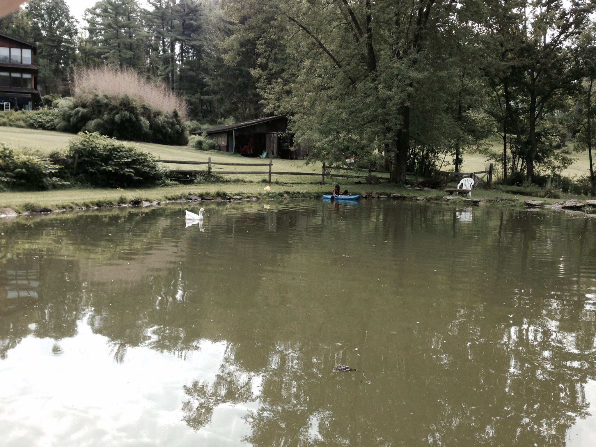

I kind of did years ago, except I had a guy come in with a tracked loader to dig the hole for me. I have a spring to feed it. And that makes a difference (probably) from what you’re planning. You don’t really mention where the water is going to come from to fill the pond.
In my case, the area was a wet spot and there are springs coming up at different points on this hillside so I figured that might be a good place. And it turned out to be OK, since it’s been there now over 20 years. But as the guy was moving the Earth he said “it looks like I’m going to hit shale. we better stop now or you might have a hole that won’t hold water”. I agreed and that was the end of it.
My pond is a bit bigger than you are planning at about 50’ x 75’ but still small and basically the concerns are probably the same. But the biggest question is where is the water coming from to fill the pond and keep it full?
Not sure this reply is very helpful, but I’m sure you can do it. But you need a source of water to maintain level due to evaporation, if nothing else, and also due to some kind of minor leakage that you may experience and cannot measure or locate easily.

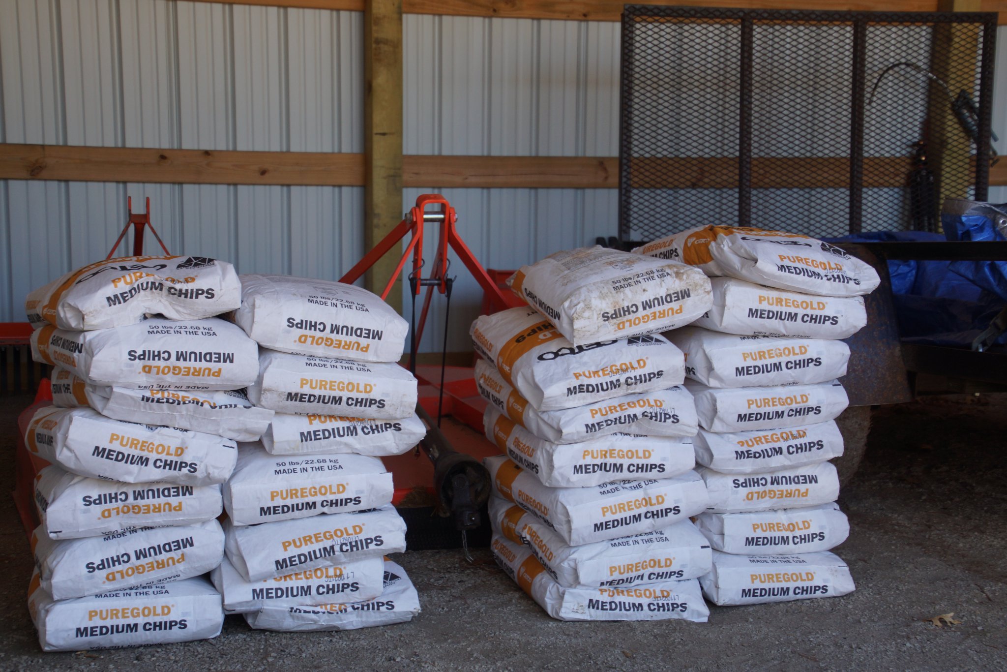

My soil is very sandy and would not have held water without bringing in 2600 pounds of sodium bentonite pellets to line it after digging with my L2501 bucket and box blade.

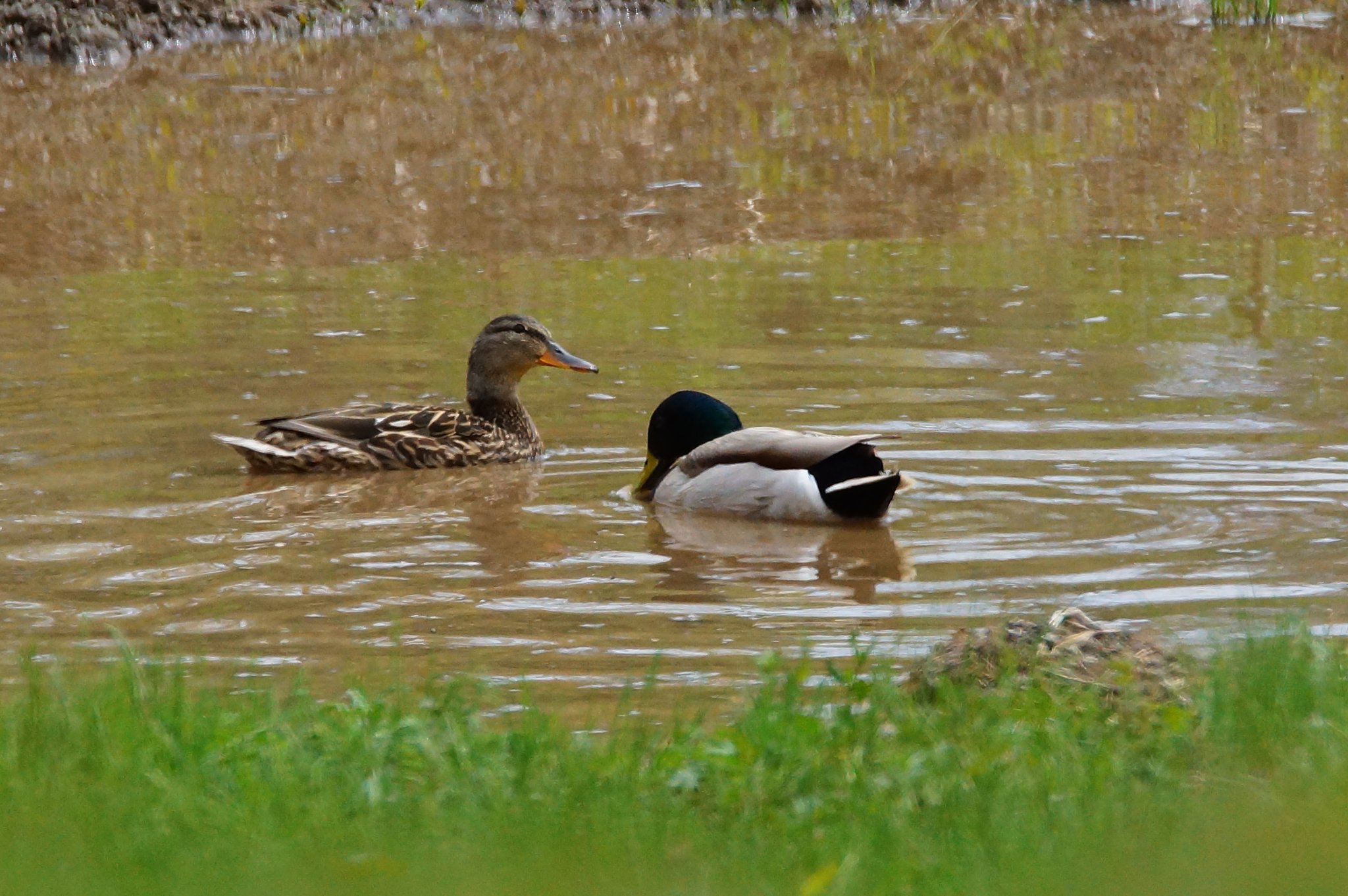

Building this small wild life pond on my property has given me tons of enjoyment and hours of trail cam videos. It was one of the most satisfying projects I have taken on. The pond started attracting wildlife long before it was filled.
