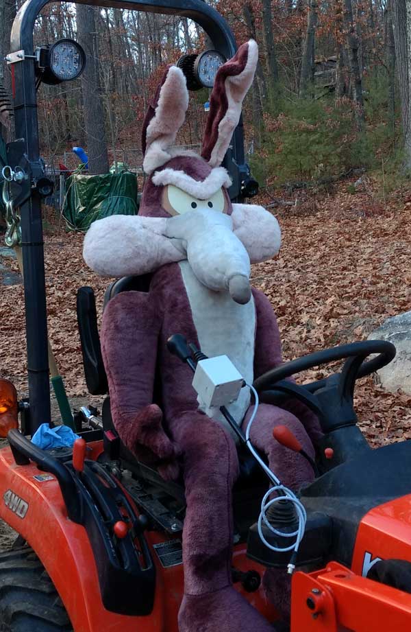

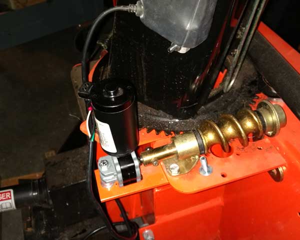

I bought the manual control blower with my BX2370. Added electrical actuators to both chute rotation and height.
height is $35 linear actuator.
Rotation is surplus seat adjust motor.
Put a 4 way joystick on FEL control arm to control the chute.

I like the way you attached the motor shaft to the worm drive screw. did you just cut off the threaded shaft on the seat motor to the needed length?
thanks
