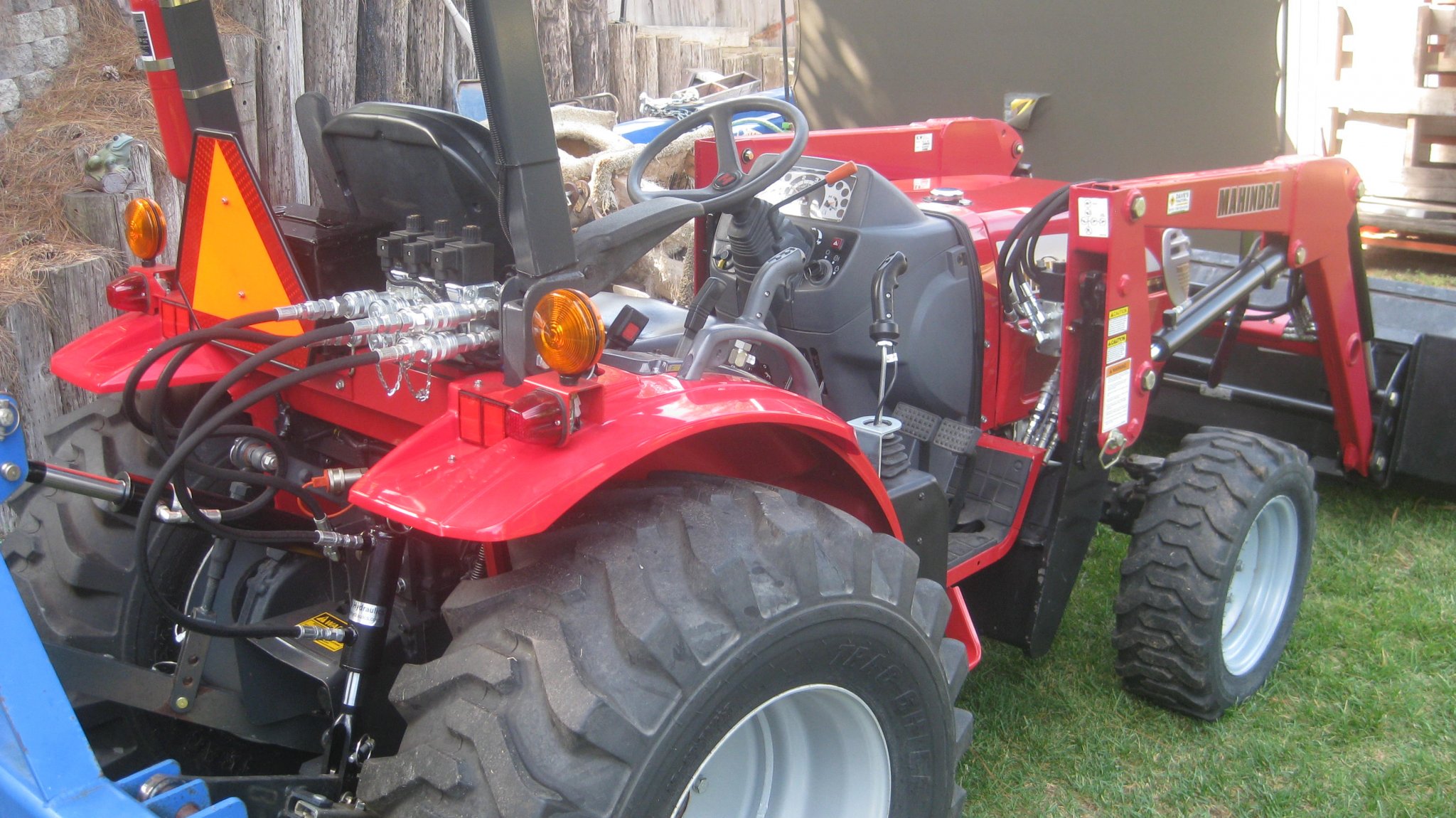

Put one of these on and you can have 6 sets of couplers to use. :cool: How many sets of couplers you need is always available, as long as you have room to mount them.
Need to keep in mind that having the hydraulic adjustments on the hitch allows you to have those adjustments for most every 3pt implement. When all the adjustments are mounted on the implement, only that implement has them.
Nothing wrong with an all hydraulic rear blade and having the hydraulic actuated gauge wheels, but would you really need the hydraulic tilt if you already have it on the 3pt hitch?? :unsure: So then you only need 5 sets of couplers to use.
