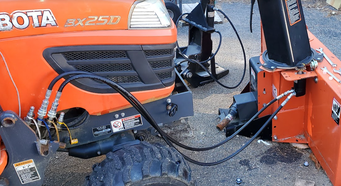

Just a little background information. I always think I can do it for cheaper than a off the shelve solution and to top it off, i have no knowledge or experience with hydraulics... With that said I will ask my question.

It mounts up great! I added hoses and attached it to my loader quick disconnects ports. The motor is only turning in one direction. if i change quick disconnects ports it will change direction.
What have i done wrong? is this not the right motor to use? Do i need to do something like purge the hydraulic lines?

I would say the spool on your loader is not suitable for controlling a hydraulic motor. Probably the bucket spool?????

I have no idea what that is or what it means. I really know nothing about hydraulics. I assumed the bucket of the loader will lift heavy items both up an down directions so i figured it would work

Motors and cylinders are different animals. Its a low speed reversible motor so a vanilla directional control valve for double acting cylinders should do what you want. The bucket spool in loader valves is not always "vanilla". Try using the outlets for the loader lift and see if that changes the behavior.

Your right, using the up/down ports work it just fine. what does that mean and is there anything i can do to make it work with the curl functions?

I think you are out of luck. The bucket spool is not going to give you bidirectional control of the motor. Easy fix would be to stick a cheap single spool valve on the loader post and use that to control the chute motor. Plumb that valve into the power beyond coming off the loader valve.

I don't know why there would be a detent but I don't think that is the problem. Lets get geeky. In all likelyhood your loader valve has a feature called regeneration on the bucket dump function.
This feature redirects the oil that would normally be going back to the tank into the oil coming from the pump and going into the base end of the cylinder. This is done to speed up the extension of the rod. and only works because the piston area of the rod end is less than the piston area of the base end. Consequently there is a differential force generated that pushes the rod out. The weight of the bucket and any material in it is being pulled by gravity and adds to that force allowing the cylinder to extend and the bucket to tip down and dump.
Now lets substitute a bi-directional motor for the cylinder. In this scenario the regeneration circuit is connecting the inlet port on the motor to the outlet port on the motor. The result is equal hydraulic pressure on both sides of the motor and there is is no area difference to generate a differential force to spin the shaft. Additionally the shaft load is a not working with gravity and is adding to the stall load. Motor can not spin shaft.

In looking at your picture I think you need to change where the hoses are hooked to. Either 1st 2 or last 2 not middle 2.

Hi again, I never did get around to buying the cheap control valve. If i do get one how would I attach it? Would i need to tie into the hydraulic line before the original control arm or would i tie in with the given four ports. If that was the case how would i activate it? would i need to control both arms at the same time? I am very lost.

The new valve is plumbed in after the loader valve:
  1. Disconnect power beyond hose at power beyond port on loader valve.
  2. Using a new hose connect loader power beyond port to IN on new valve.
  3. Connect power beyond hose disconnected in (1) to power beyond port on new valve.
  4. Install tee in loader tank return hose.
  5. Connect tank return port on new valve to tee installed in (4).
Your new valve is independent of loader valve. Using two new hoses connect the two work ports on new valve to your snow blower cylinders and you are good to go. The lever on the new valve controls blower cylinders.
