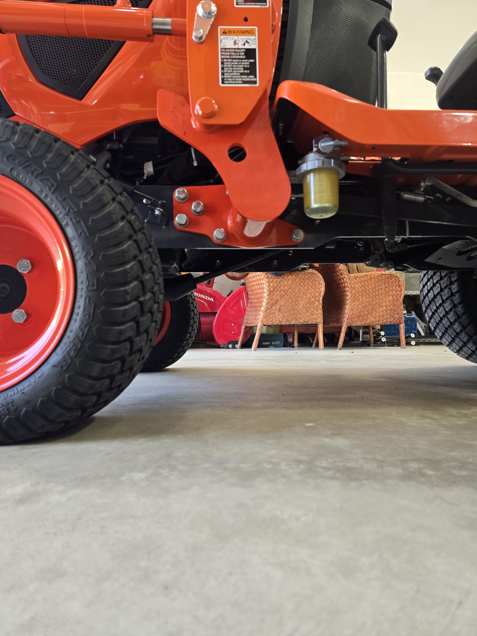

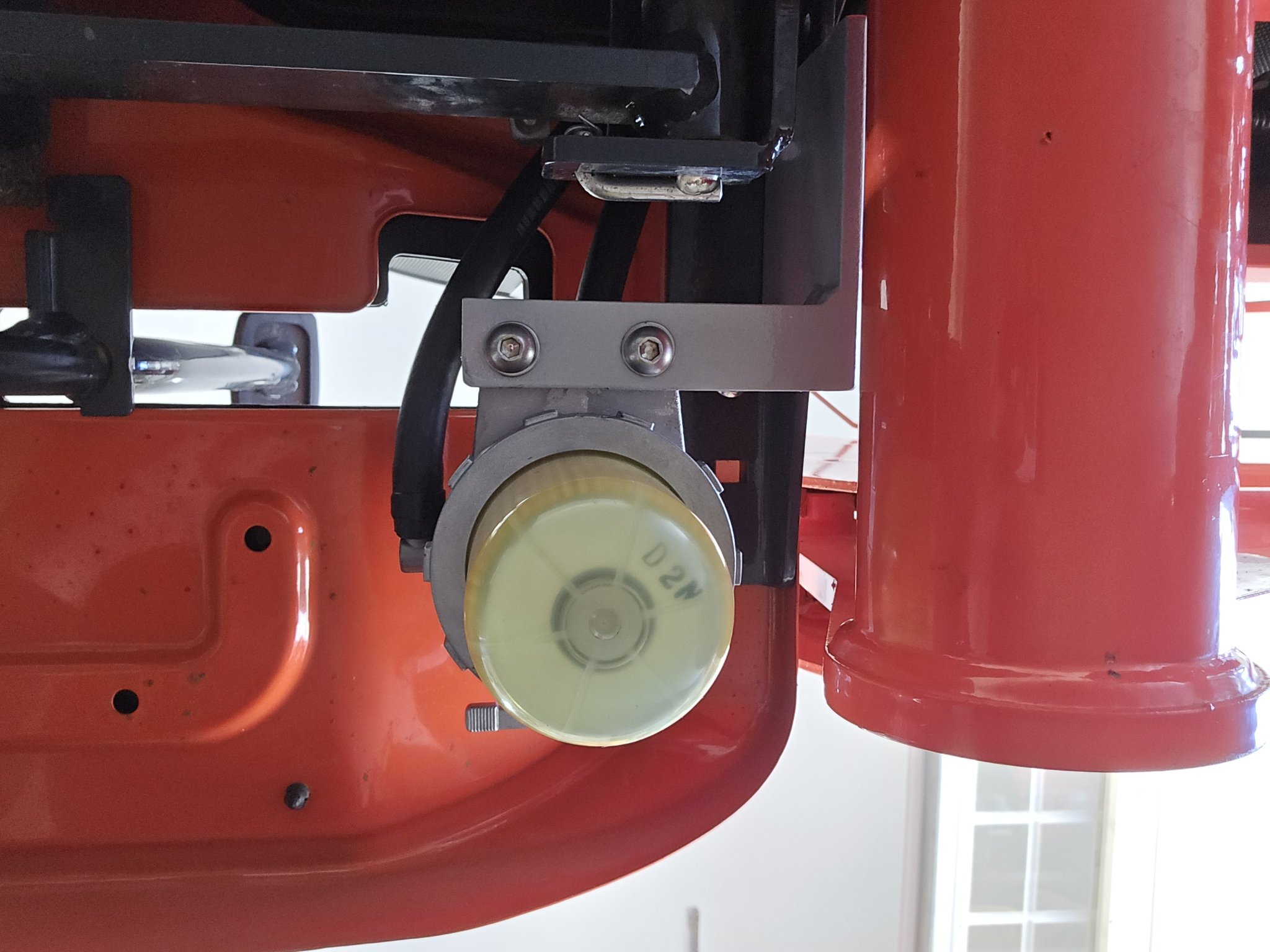

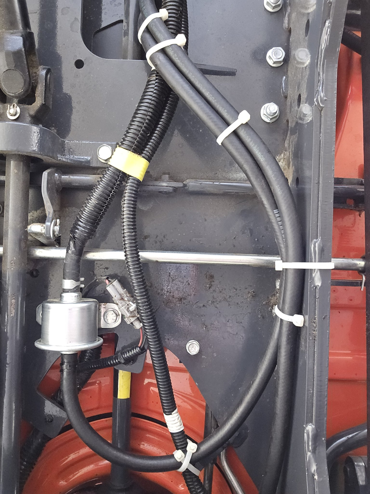

I've seen a lot of fuel filter mods, here's mine. I decided to mount the Kubota 15521-43018 filter housing behind the loader frame. The bottom of the filter housing is above the loader frame, so it should be well protected. The worst part of the install was removing the filter between the tank and the pump!

Looks good, but I'd still make some kind of shield. Thin metal under the unit and use a couple of the bolts showing in the first picture. That would deflect sticks from coming up and slapping it off the mount, and stranding you.

Thanks. I may do that in the future. My mower is on most of the time, but it only takes that one time.

Yes, this filter replaces the factory filter between the tank and the lift pump. From what I understand, the primary filter protects the lift pump, and the secondary filter protects the high pressure pump, for example, if the lift pump fails. I still have 2 filters, but both will be quick and easy to replace now. I'll have to look for that funnel. Thanks for the suggestion. I've been using a Mr. Funnel. I've got a "coffee strainer" in my fuel tank (which has trapped debris). I'm picky about where I buy my fuel. So far I've not had any fuel issues, I think because of my methods.
