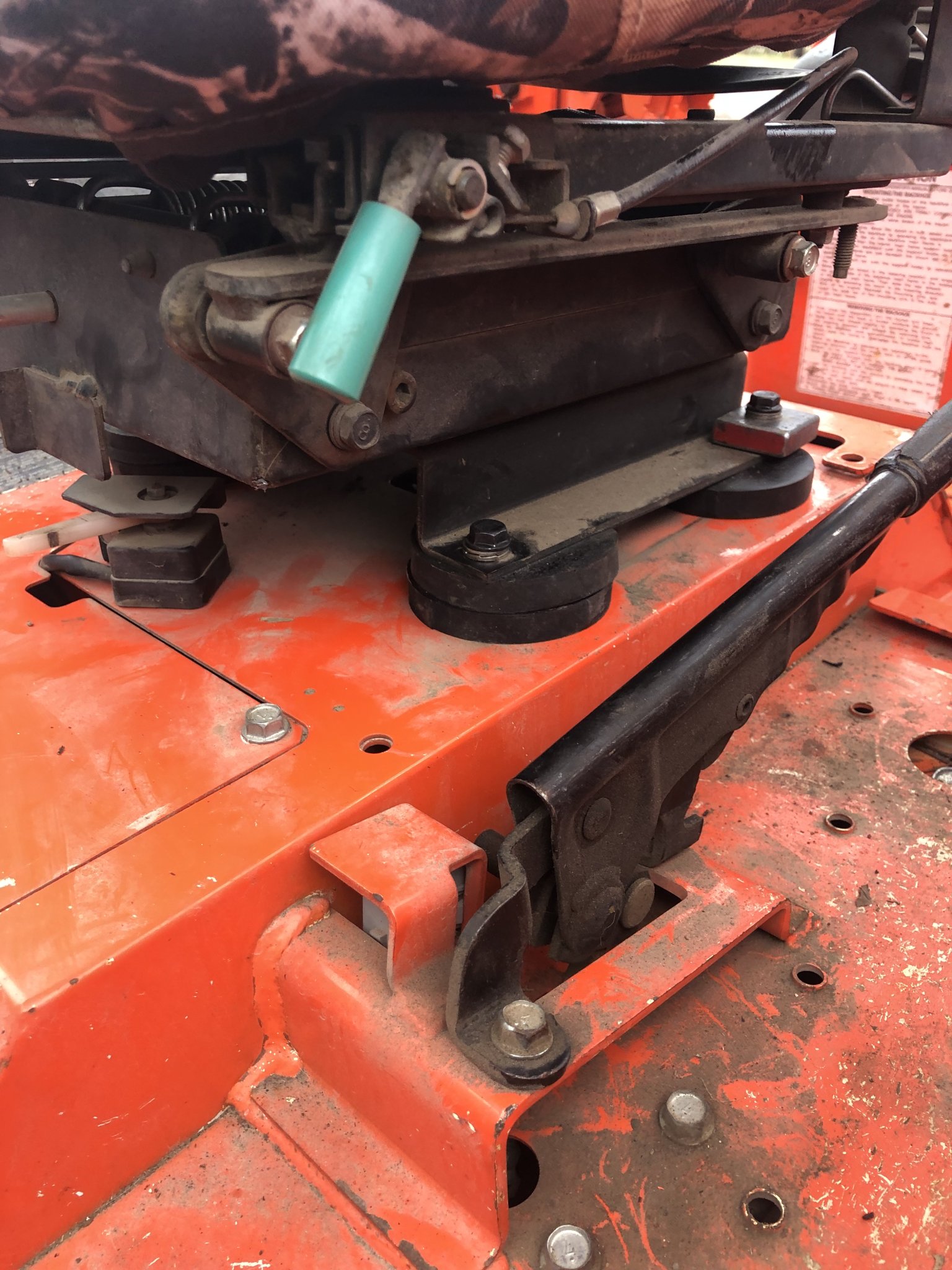

Sore back is no fun. Using a tractor shouldn’t be crippling.
Sitting position with the OEM spring seat was never right on my M59 particularly for big guys. Two modifications helped. First seat cover helped over the vinyl especially in the summer. Second rubber blocks under the mount and deck to raise and tilt back the seating position. Immediate relief on knees and back. Wouldn’t think small changes would make such a big difference.
Have orthopedic seat pad and heat grids to try next. Wished for a little heat for decades doing winter chores. Don’t have as many winter chores now but not as tough as I once was either IMG_2545.jpeg
