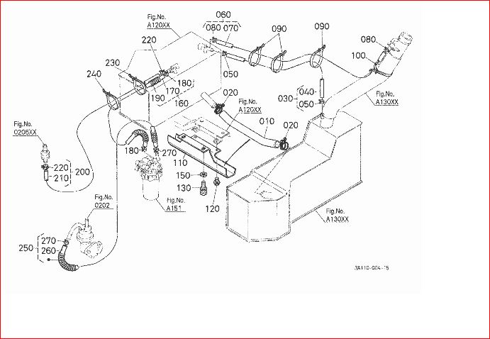

On your tractor you fill to the LH tank and that flows to the right hand tank.
If filling the left hank tank does not let fuel flow to the right hand tank it could be the crossover vent pipe, but considering there is 2 vent lines it's more likely the cross over fuel pipe, that's the first things to check.
Note: Pull the cover #110 and I bet the pipe / hose #010 is collapsed or compromised.
28,286
4,853
Removing #110 (cover) will get you to the crossover line #010 (fuel line).
#070 and #040 are the vent lines.
