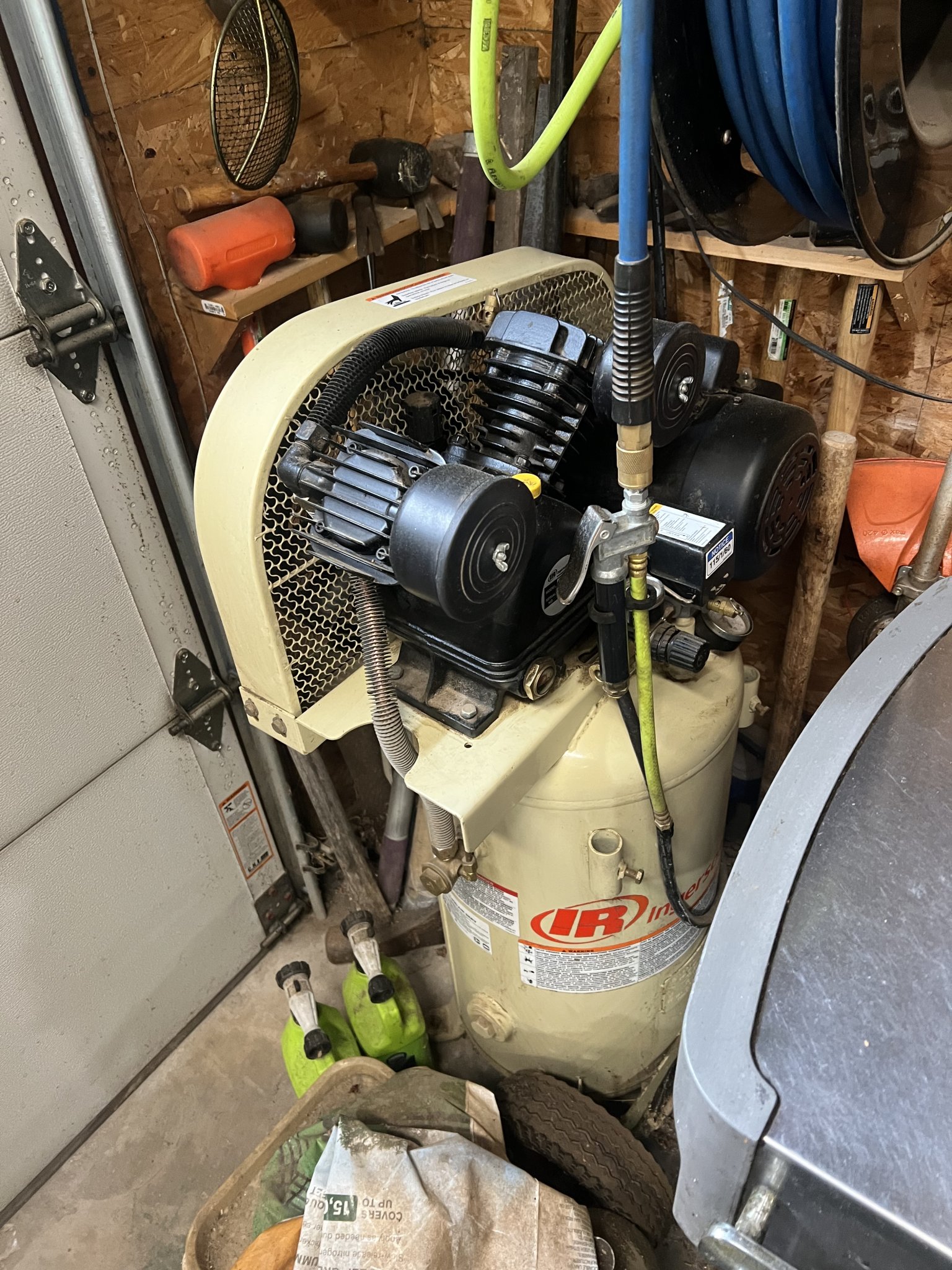

Years ago I bought an Ingersoll Rand P1.5IU Model 20-gallon 2-cylinder reciprocating compressor with the help and suggestions of folks on OTT.
I use compressor maybe 50 +/- hours/year. (winter/half the year is just tire inflations).
Owner's Manual recommends Oil and Air Filter changes at 12 months/2,000 hours whichever comes first.
In 6-8 years I've changed oil two or three times. Oil and Filters are clean and I check them occasionally. I drain it each spring and get very little moisture out of the bottom drain.

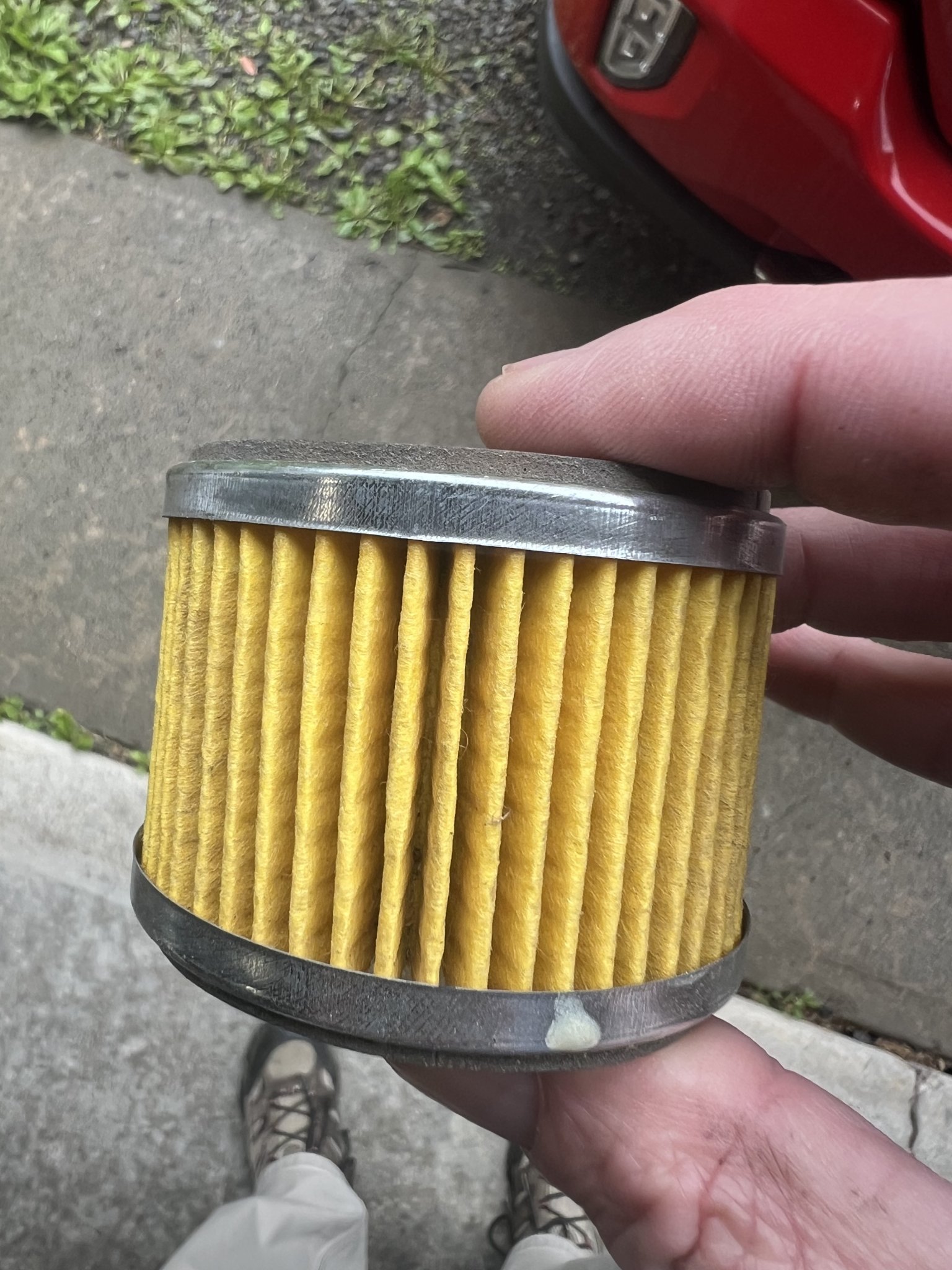

Air filters I have never changed at a guesstimate of 400 hours, but they look clean enough I didn't think was needed.

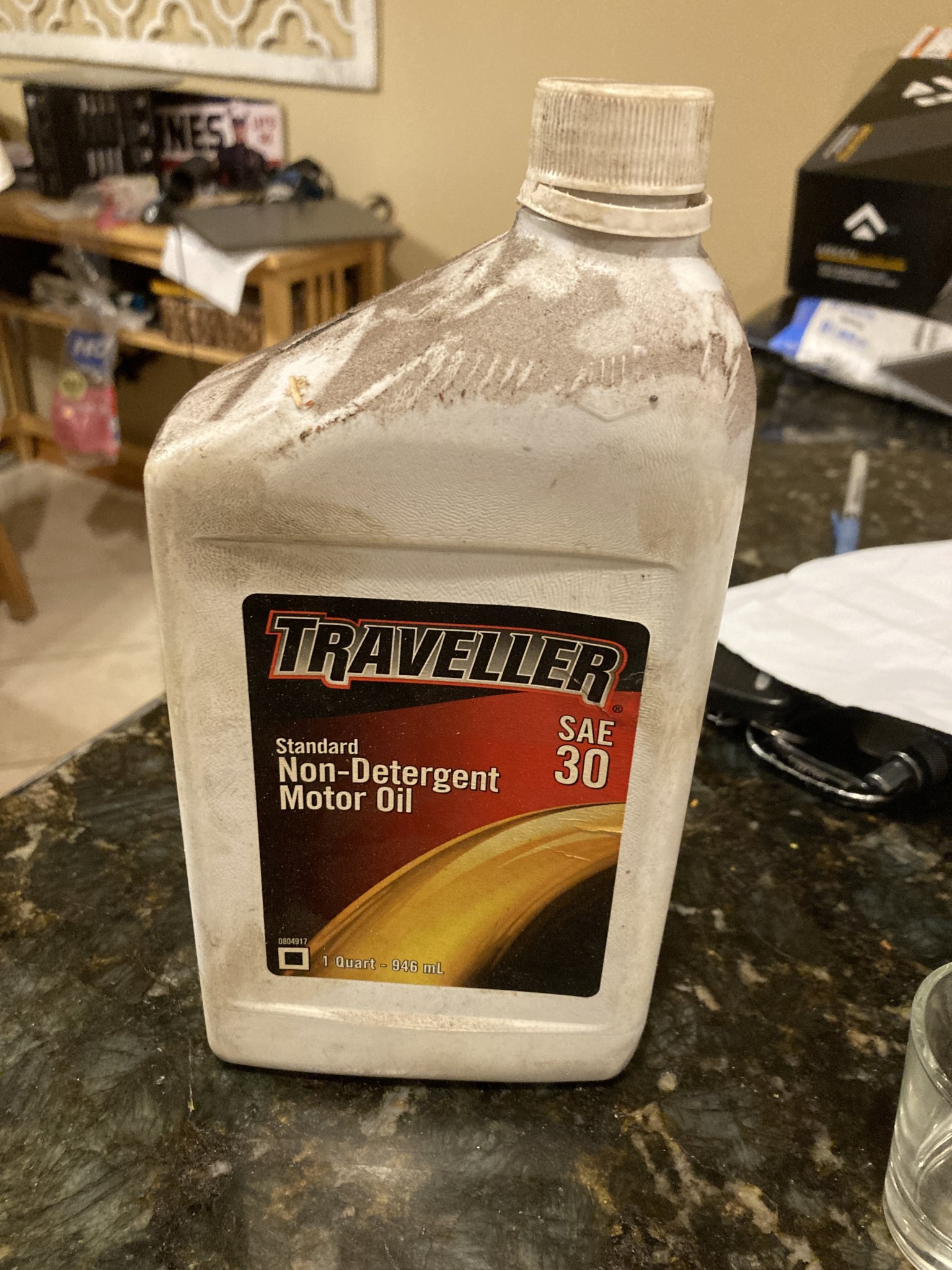

I used this for my little Quincy 24 gallon.
Two of the primary scientific/engineering reasons I decided to use it was ........because I found it, and it was free. (y)
I have no idea where, or when its from.
As you can see from the dust, it's from a while ago.

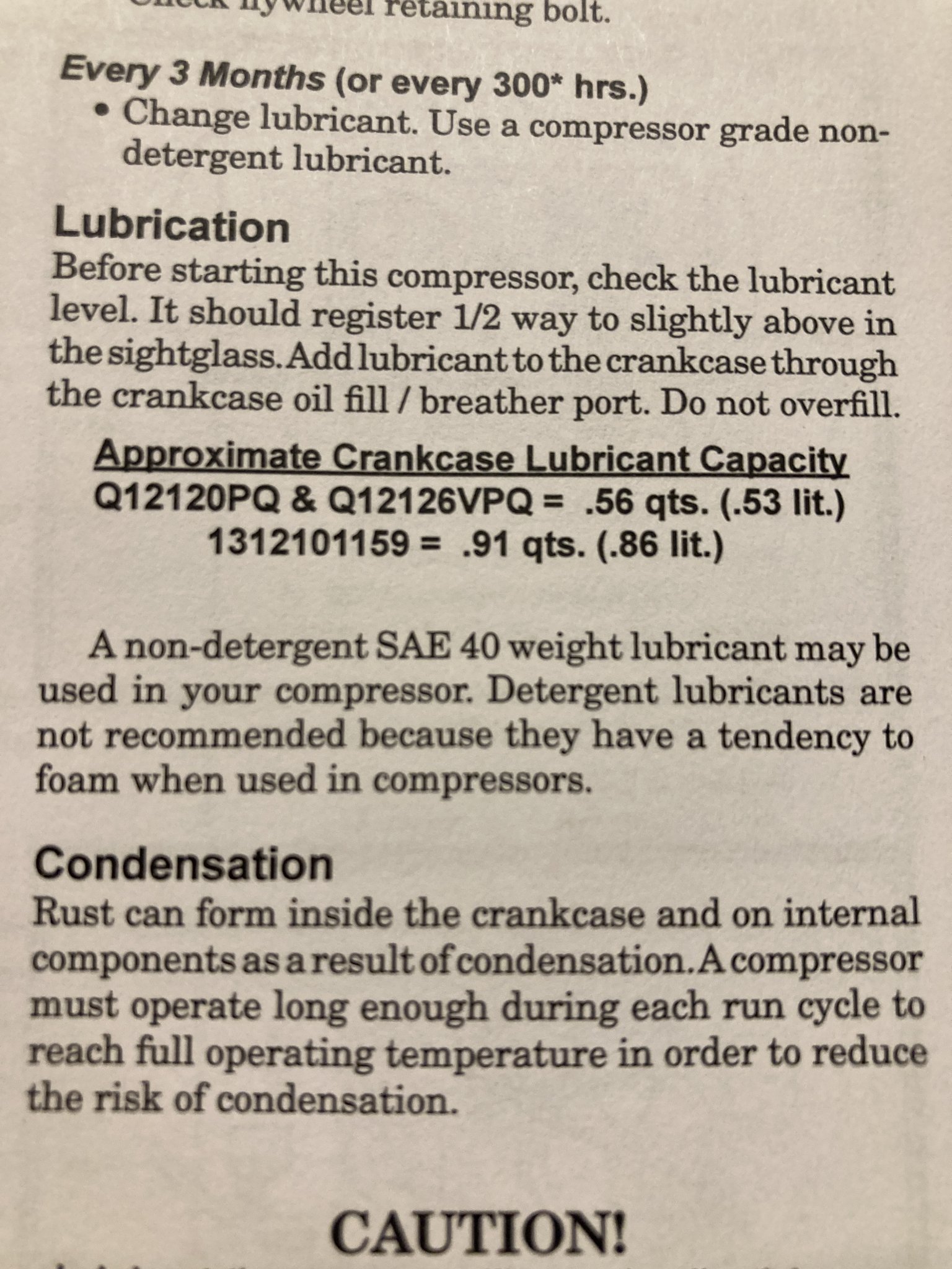

The owners manual was pretty ambiguous, so other than 40 Vs. 30 weight, it should be good nuff. This little compressor motor ain't nothing special, so I am betting it will be fine.
EDIT: Embarrassingly enough, my " strict service interval" for my compressors has always been "Now and Then".

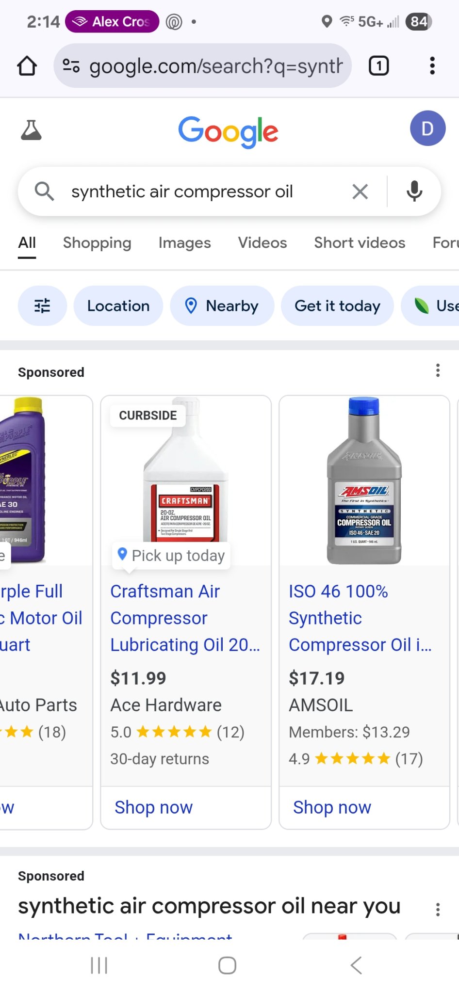

Just a quick internet search. You have craftsman air compressor oil that's good for their air compressors.
You also have amsoil.

I highlighted the petroleum based recommendations for my compressor.
I attached as others have the same or very similar compressors.
