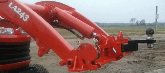

Hi y'all!
I'm a member of another forum that's overwhelmingly recommending the Tach N Go from MyTractorTools.com
For the most part, the reasons given are the built in 2" receiver, build quality, secure/slip free connection. However, nobody there really seems to actually have experience with the AI2 quick attach for comparison.
From what I've gathered by first hand accounts, and videos I've seen, the one Tony makes is ALSO a top notch product.
The one from AI2 is available for $525 or something along those lines with free shipping, but Jery's is $750 PLUS shipping.
Both quick attaches are about the same weight. The lack of a 2" receiver is definitely a strike, but AI2 makes a plate with receiver that I could buy, and still be the same cost or less than just the Tach N Go plus shipping.
Jery's Forks are a little bit lighter and a little bit cheaper, so that's a consideration. Anybody know if the forks for the Tach N Go will mate to the AI2 quick attach?
One other thing is I REALLY like the mini grapple Jery offers at MyTractorTools.com. I can't find good photos, but I think it uses the 2" receiver as part of the mounting for it, so I highly doubt the grapple from MTT will mate to Tony's quick attach.
Jery's grapple is $950 plus shipping so I bet I would never purchase it anyway. It's super light though, and the only practical option for me to have a "real" grapple on my BX.
A substitute I'm considering is "The Thumb" mounted on a set of forks from AI2 or MTT. The thumb is only about 100 lbs, still leaving me with plenty of lift capacity for brush and whatnot.
Anybody here have personal experience with BOTH the Tach N Go and the AI2 quick attach?
Can anybody confirm whether Jery's lighter forks will mate to the AI2?
Can anybody confirm for certain that there would be no way to make the mini grapple for the Tach N Go work with the AI2 quick attach?
It's hard for me to convince myself to spend the extra $300 or so for the TNG, if the AI2 is even almost as nice.
The tractor in question is a new BX1880, with the pin on loader, third function valve, and rear remote valves.
Many thanks!

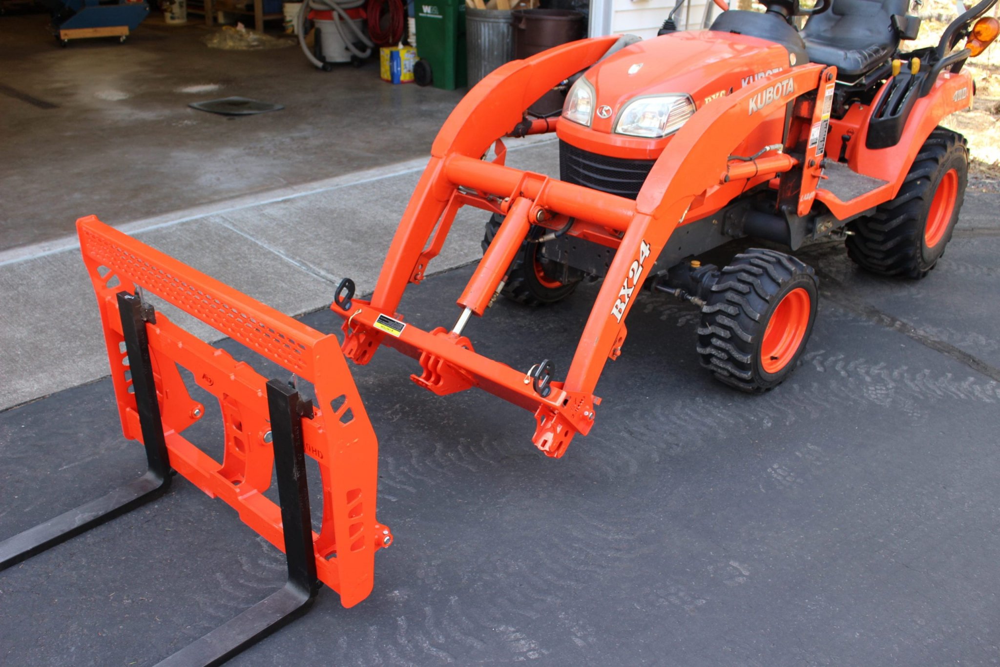

neither... SSQA adapter plate from EA, then buy whatever SSQA parts you wish.
you can get SSQA forks that are as light as 120 pounds, and SSQA grapple that is about 160 pounds. (disregard the mower deck)

I don't think that's the route I want to go, but I'll have to dig a bit more to rule it out completely.
That seems similar to the factory SSQA, which I passed on because it reduces my lift capacity by about 100 lbs. The weight of it paired with the added length it puts my bucket out were responsible. The EA does not appear to me to put the load out much further than the AI2 or Tach N Go so maybe it wouldn't be much worse. The adapter plate itself weighs about 20 more lbs than the other two. Most SSQA attachments I see are heavier than pin on counterparts.
This would also mean I can't use my factory bucket. The other two options allow me to still use regular pin on attachments but on a quick attach manner, and the EA doesn't seem any cheaper. SSQA attachments seem generally more expensive also.
I think the mini grapple was only about 100 lbs.

yes you would need a new bucket, I sold my old bucket for $100 then bought the new one, they are around $350. There are lots of light SSQA attachment options out there. On my LA243 loader I noticed no difference in lift capacity using the SSQA adapter. still lifted heaping scoops of topsoil ect. It might have moved the bucket out a quarter inch or so. The Land Pride SSQA grapple is 180 pounds. Earth and Turf SSQA forks 120 pounds. I was using the artillian grapple and the SSQA plate, that grapple weighs 270 pounds, and I did not run out of lift capacity.
I understand where you are coming from though, on the BX every single pound counts, that was my approach too. Personally, I didn't want to be tied to one proprietary system. JMHO YMMV

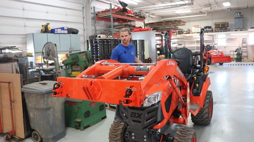

I have Tony's AI2 system on my BX1880. The reason I went with it is that nobody else at the time had a system compatible with the FEL stand stowage system with the remote latch system on the latest BX. Additionally, Tony had a very detailed video on the installation which is not as easy as on the older models. However, you only do it once. It works well with the factory bucket, the Land Pride 48 in. grapple (some bolt heads and nuts have to be reversed) and the redline pallet forks (got longer safety lock pins for ease of installation) but no permanent modifications were required. So, I am happy with my setup.
The only thing to mind is that there are two bolts that need to be properly adjusted during installation to hold the FEL stand fully retracted while latching. One of mine backed out (I must have left the lock nut loose I guess) and it got slightly bent. I readjusted and it still works fine.
The bolts appear around the 20 min. mark in Tony's video:
