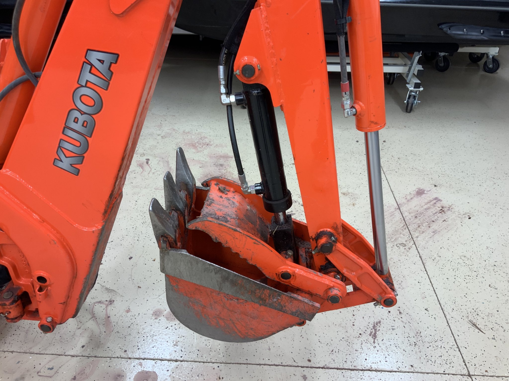

BH77 backhoe w/16” bucket and thumb

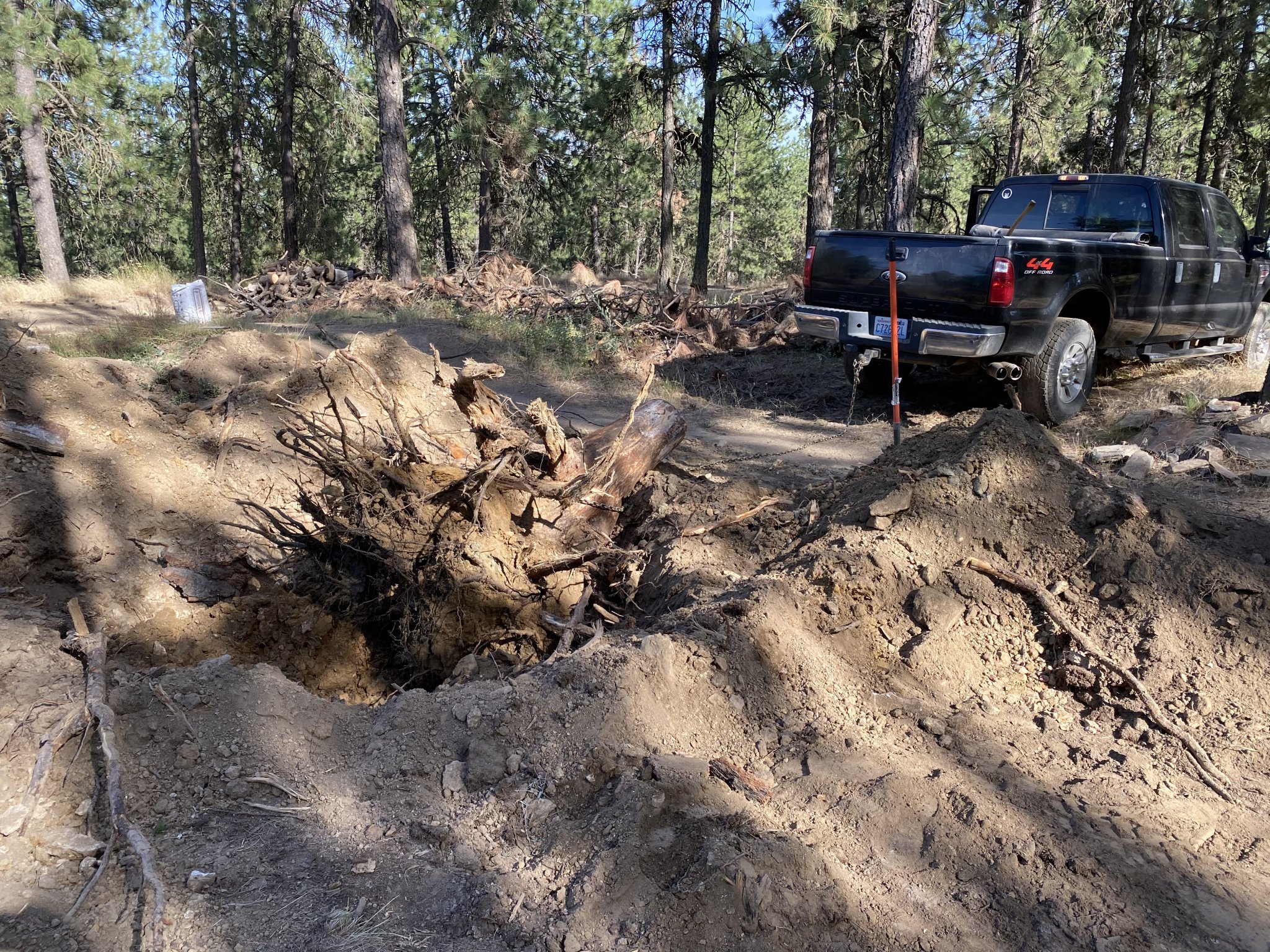

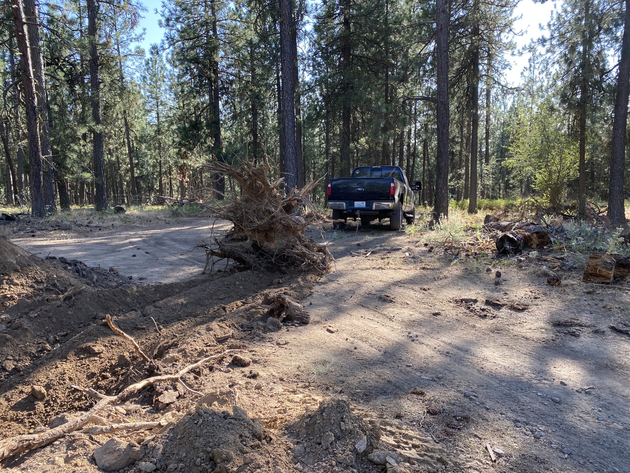

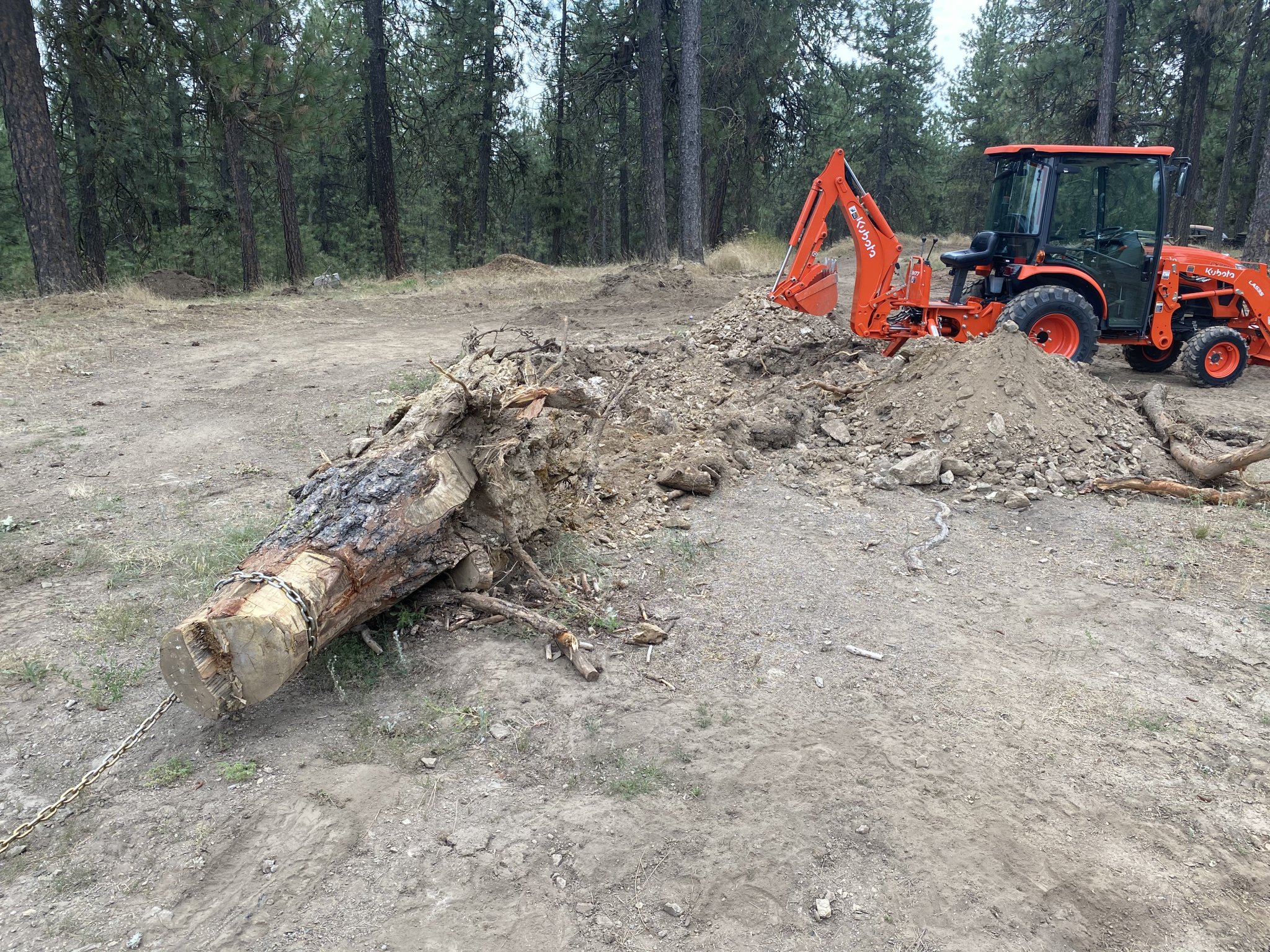

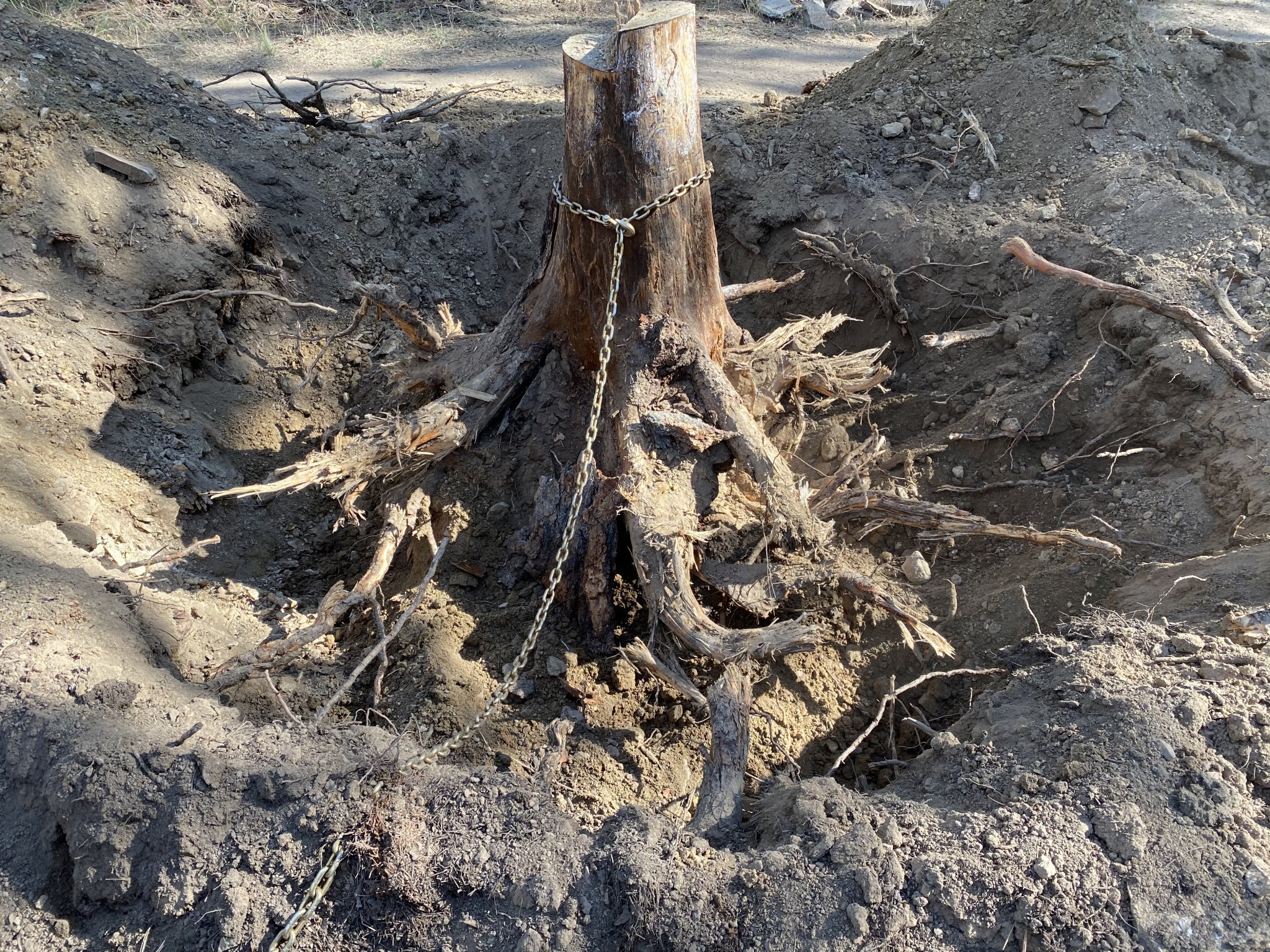

In the past week I’ve managed to put 26 hours on the tractor. This was spent grading some pads for trailers, digging up Douglas Fir stumps, and removing chunks of concrete buried in a field. The stumps varied from 6” to 36” in diameter, and a couple required breaking roots as deep as 5’. The 16” bucket worked great for the type of soil that I have. A root ripper from BXpanded would have come in handy, but only if I also had the quick connect, as I would have had to switch between them a couple dozen times.

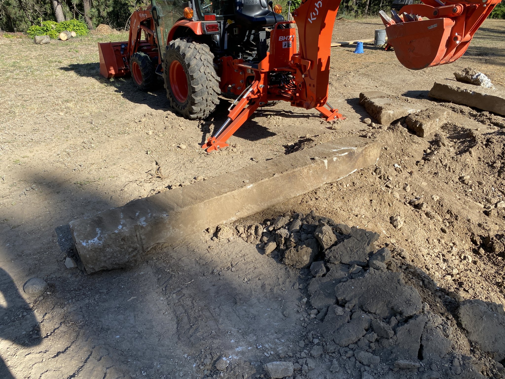

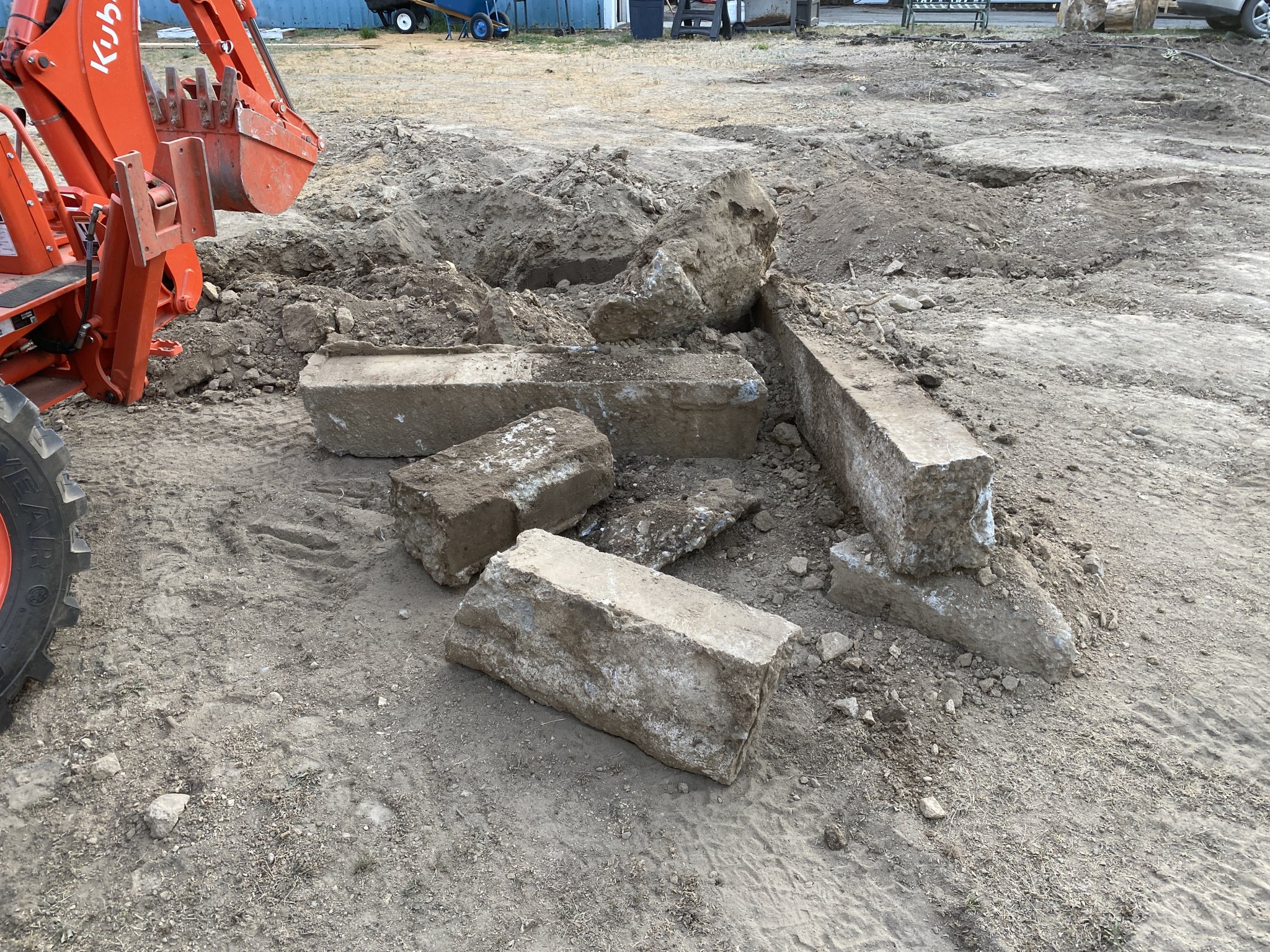

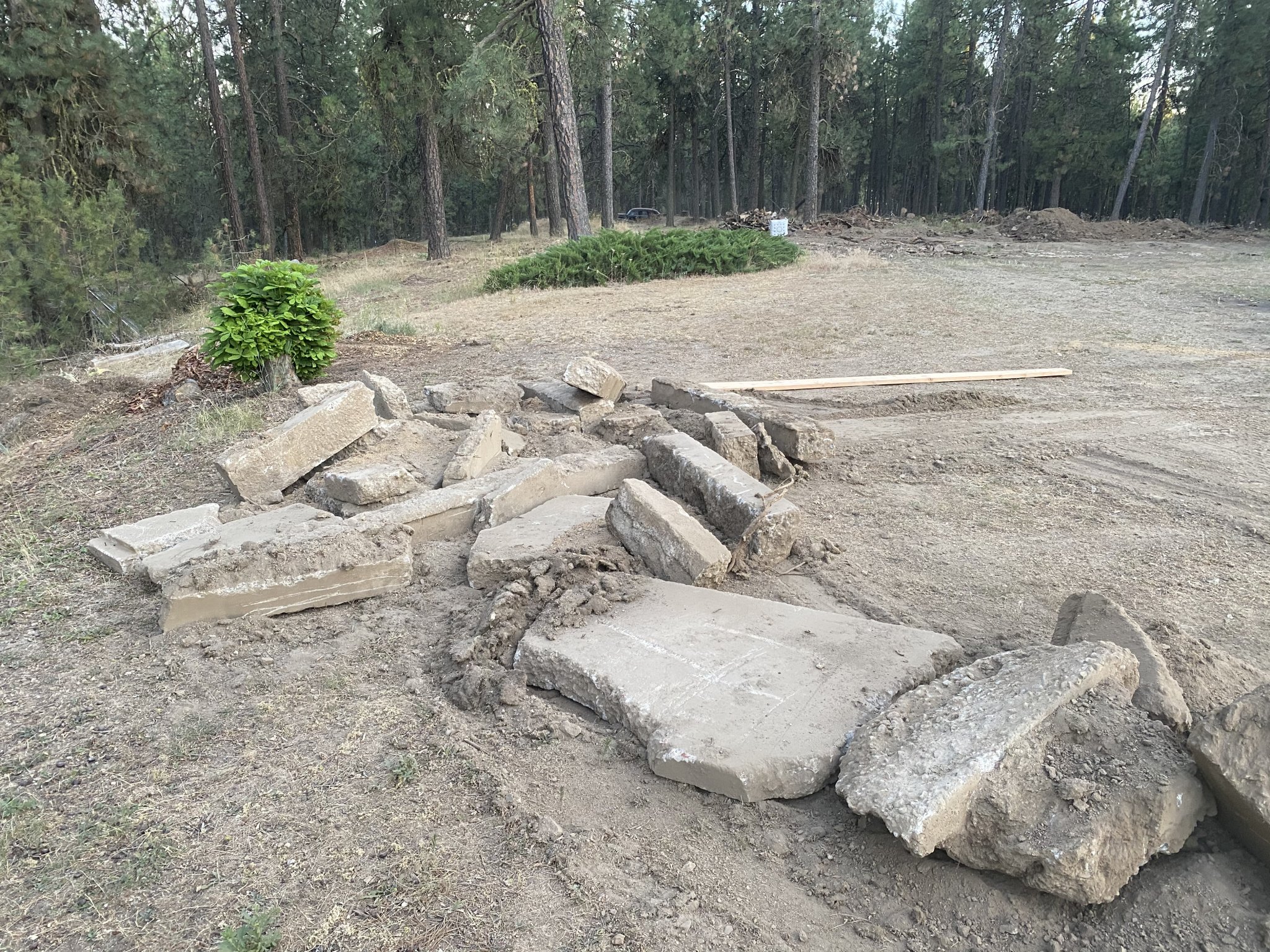

The concrete varied in size from chunks of 6” slab to 12”x12”x 6’ long foundation wall pieces. The BH77 handled it like a champ. I was actually shocked how well it did. The mechanical thumb worked great, and was indispensable . Hydraulic thumb would have been better.

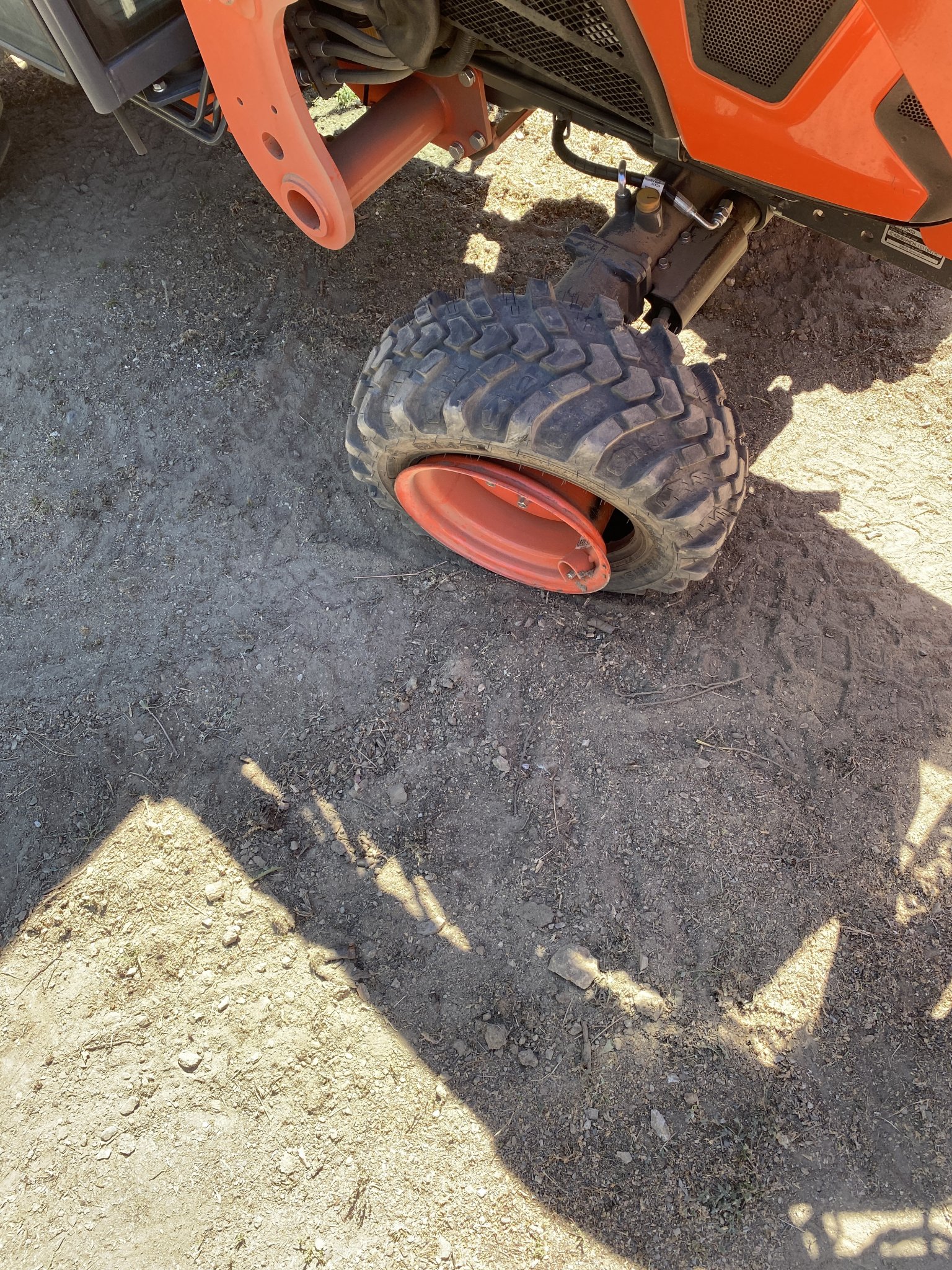

The week was not without its hiccups. The cheap hose clamp that holds the SMV placard mount to the BH77 broke the first day. Replaced it with a pair of SS hose clamps. Also, halfway through the week I managed to pop a bead on the right front tire. From what I can tell, I rubbed up against something. Luckily, I caught it quickly. No damage to tire or rim. Lifted the front end with the FEL, placed jack stands, cleaned the bead on tire and rim, used a ratchet strap around the tire to set the bead, and aired it back up to spec. After soaping the bead to check for leaks, I was back in business.

Put that 6.4L Powerstroke to work! Tractor is very nice as well.

Negative, that's a 6.4L. I'm a Ford truck fan and pretty knowledgeable at ID'ing them, having owned 4 Powerstroke trucks. (Although, sigh, currently driving a 2019 RAM 3500 Cummins).
From this angle, you can see the tailgate and tail light design - used from 2008 through 2016. However, the lack of a small body line on the rear tailgate which drops down under the tailgate handle means this truck is a 2008-2012 model year. The dual tailpipes mean the truck is a diesel, but this design was used from 2008 - current. 2008 - 2012 spans two generations of Super Duty, however. The 6.7L diesel came out in 2011, and all 2011-2016 diesel Super Duty trucks have a round badge on the door which states 6.7L diesel. However, all 2008-2010 diesel trucks had the 6.4L diesel which was identified by the fender "vent" plaque which you can just make out in this picture. Thus, this truck is a 2008-2010 Super Duty 6.4L Powerstroke.
Carry on, Ford spotter's guide lesson completed!
