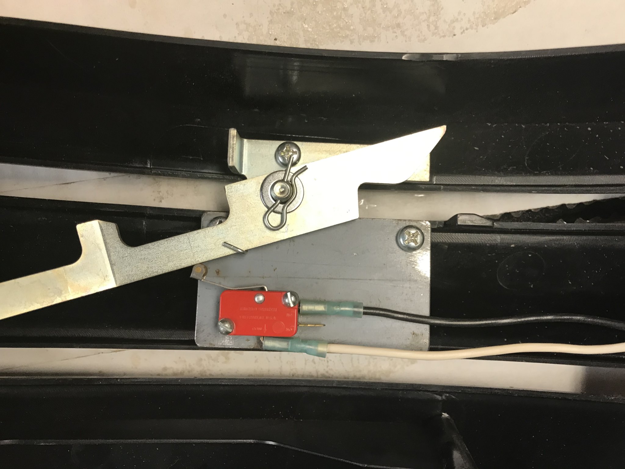

I decided to add an hour meter to keep track of the PTO hours so I can do a better job of maintaining my snowblower. It has a 4 hour interval for chain lubrication, and a 20 hour interval for greasing the drive shaft, and u joints. I already keep a maintenance journal to record all operating hours, but don’t run the PTO the entire time the engine is running so actual PTO hours are always a guess as to actual time running. Adding a switch to the PTO engagement lever will allow me to power the hour meter only while the PTO is running.
So far it has been a very easy to fashion a mounting bracket to hold the switch, and there is already a 12v aux. source at the rear of the seat area that I can use to power the hour meter. So with a small amount of wiring, and a few terminals, it will be complete. I have a 12v hour meter on order from Amazon, so as soon as I receive it I will install it in the plastic shroud around the levers that control the PTO engagement and transmission speed selector. Here is a picture of my progress so far

Well, my hour meter was delivered yesterday, so I spent the morning finishing the install. I didn’t get to locate the meter where I wanted to due to the inner fender having a profile that wouldn’t allow it, but it is still readily viewable from the sitting position. After cutting a hole, and a few more wire connections, it’s done. For the $15 investment and a couple hours of my time, I think it will be worth it. Oh, and I was able to move the warning sticker from the counsel to the window. Any, here are a couple pictures of the install.
