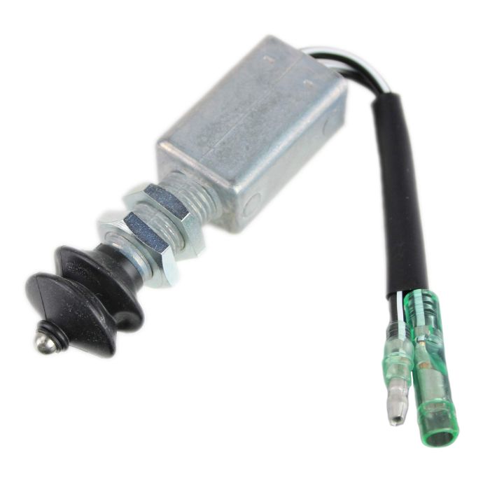

I'm looking to get some advice on how I could add a simple warning light to the dash of my L2501 that will let me know if my parking brake is on. There have been a few times I have accidently left the parking brake on and went to drive the tractor and I'm hmmm the hydrostatic is whining louder than usual and then I look down and say DOH! I see the parking brake is on. I've always habit of using the parking brake on previous lawn mowers. I always thought it would turn off the tractor without the parking brake enabled but that is not the case so I only set it now when I don't want it to move for whatever reason.
What would be a pretty simple solution? Maybe add a switch for the brake pedal or perhaps on the parking brake lever?

the L33## and related has a warning light.
If you are handy you could wire a E-6C080-31010 switch to a 1092C1-12V control panel light through a switched power source and for about $60 Bobs your Uncle.

Did two things to help remind my wife, I and others the brake was on.
First welded extension on the handle. Gives visual and makes setting the brake so much easier.
Second, added a rear motorcycle spring switch to the parking lever. Bracket and hole already under the dash. Had to drill a small hole in the lever for the spring. Wiring led clearance light. Purple for “parking” brake. Been reliably for almost 10 years and saved many arguments.
