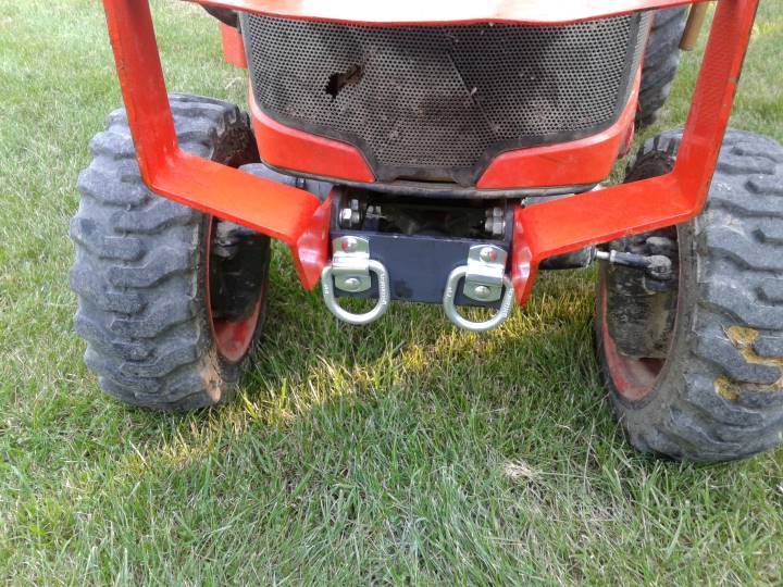

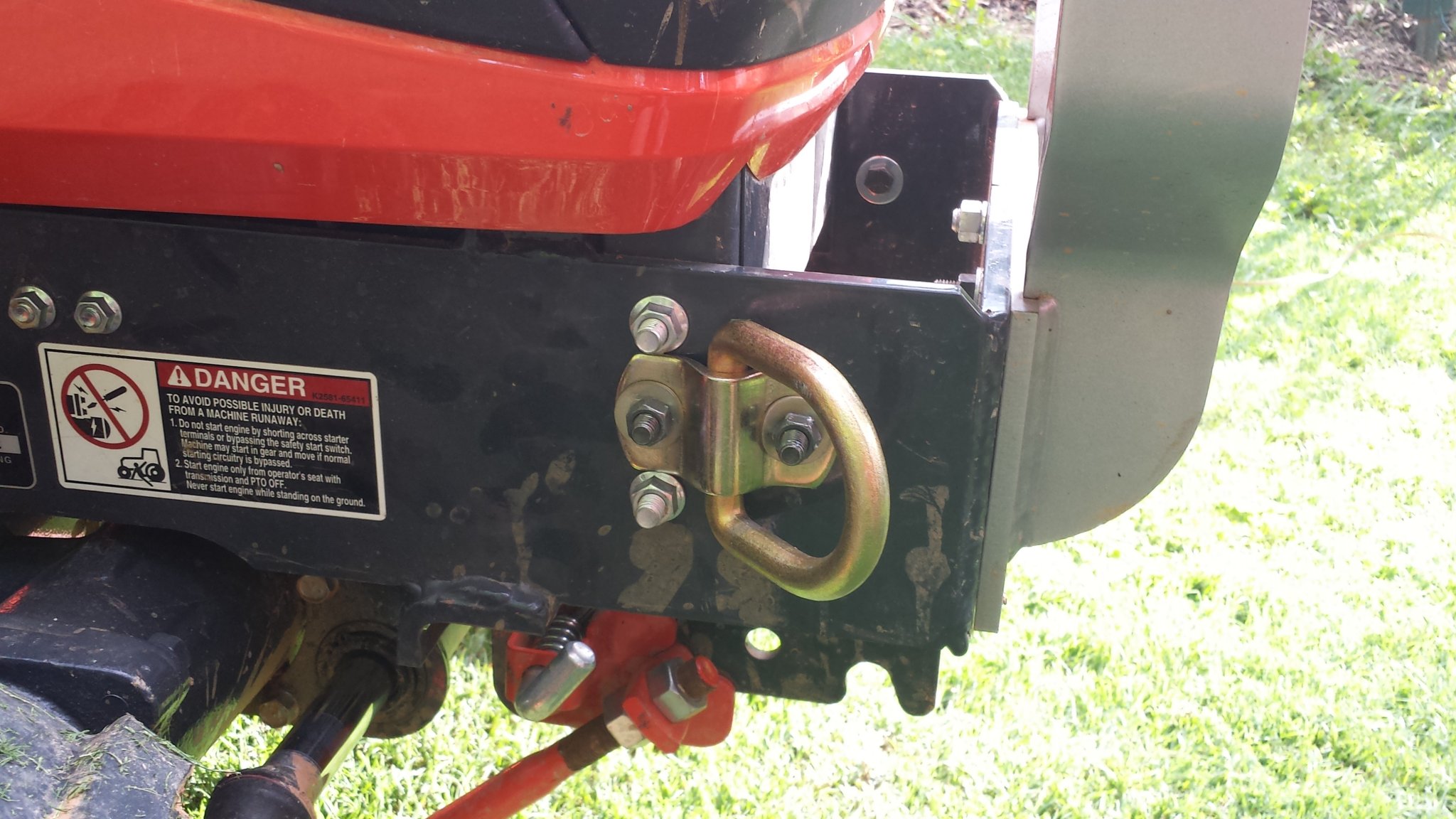

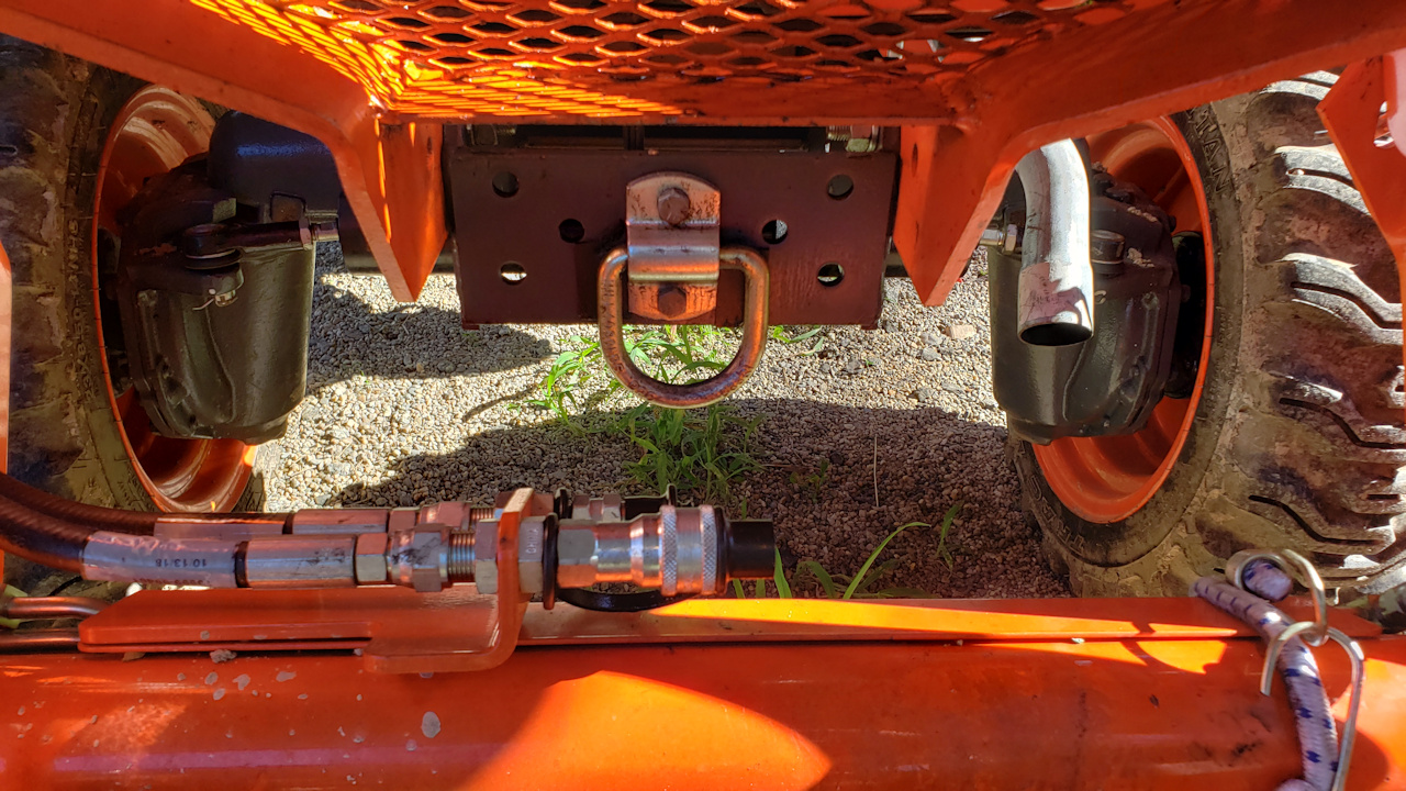

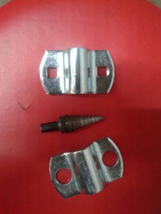

Added tie downs to B2650, should work on LX, possibly others. I purchased these D-Rings for the 2 inch hole spacing
The front is easy 3/8 carriage bolts and nylon lock nuts

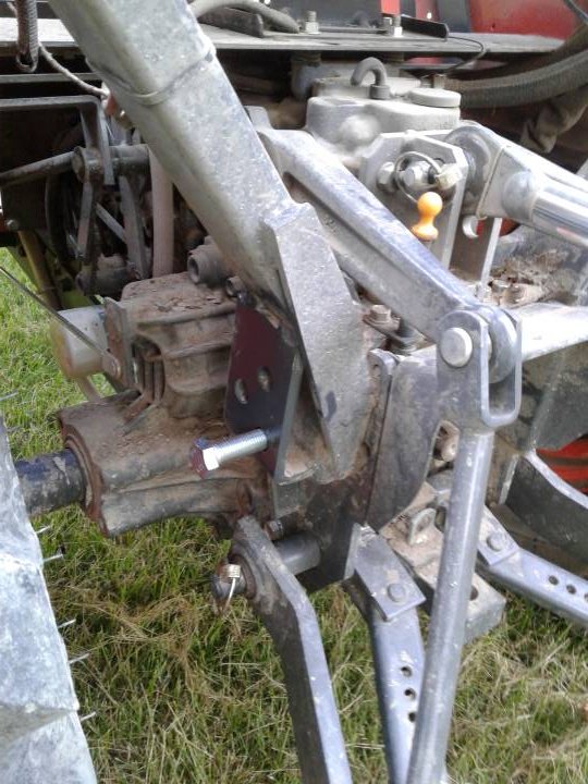

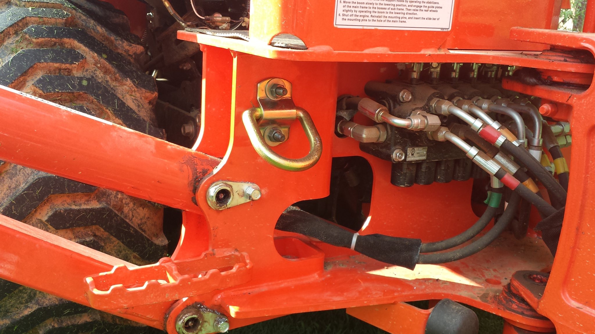

The roll bar has mounting holes (for backhoe frame??)
Used brush from gun cleaning kit to clean dirt from threads
Used a stepped drill bit to convert square holes into round holes
The metric mounting bolts are 16x1.5mm, 25mm long.
there is an interference of the points of the hex head and ridge of the bracket, guess the bolt won't accidently back out

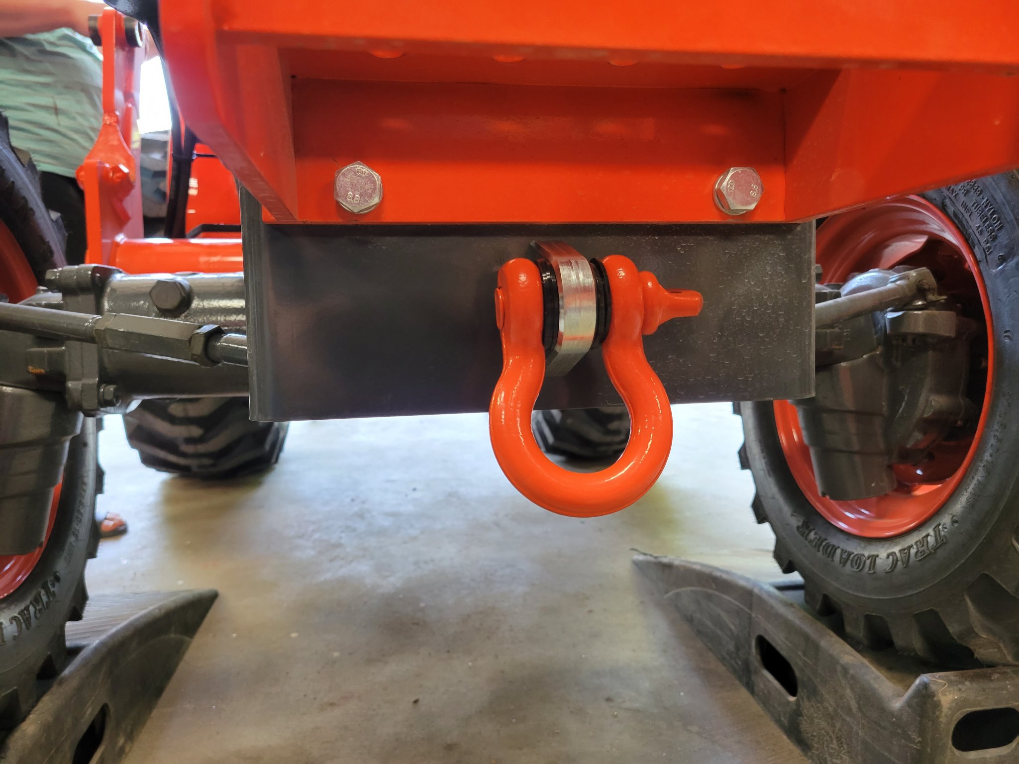

I did something similar on the front B2601. Used 1/4" plate and welded 1/2" 12,000lb D-ring to it. So much easier to chain down now.
