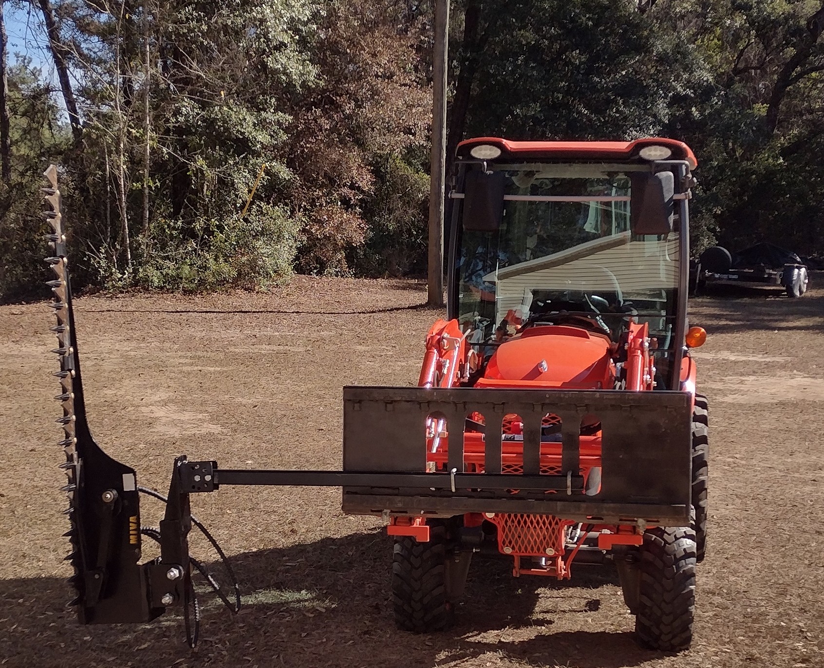

This is my latest hair brained idea. So far it looks like it might work.

I could use that!. Might want to consider making the mounting tube telescoping so you can move it out and in a few feet.
The ability to adjust it in or out a little was always the plan. It is pretty heavy and I don't want a bunch of excess hose so I don't think I will need to move it much.
I have changed my mount idea. I have a blank plate I made into light duty pallet forks I seldom use so I now plan to clamp the 2 inch tube directly to that. I hope it has enough hose on it to not have to add any.

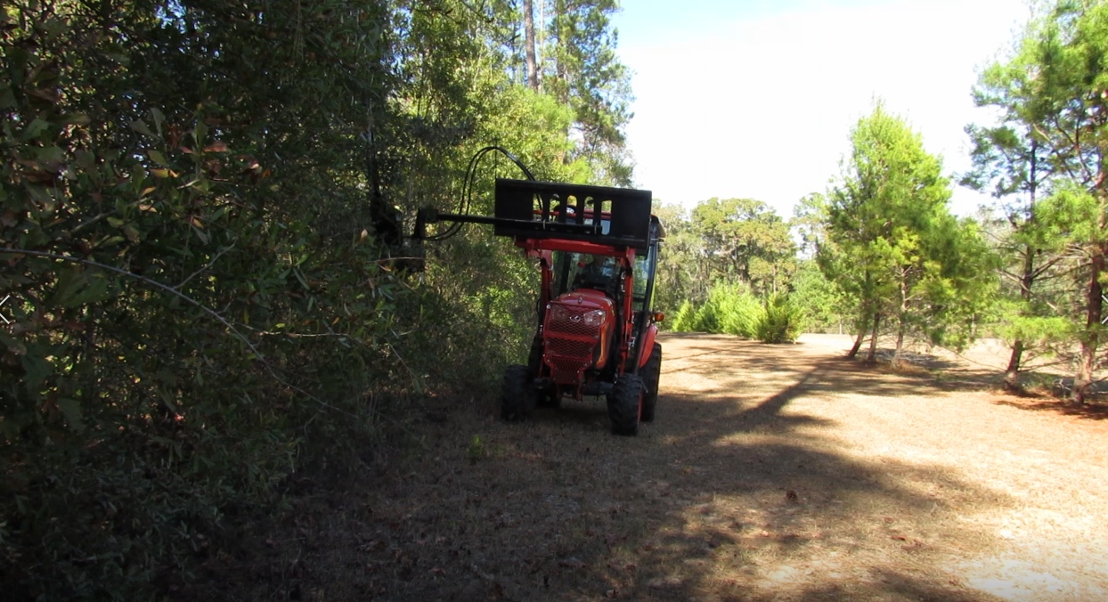

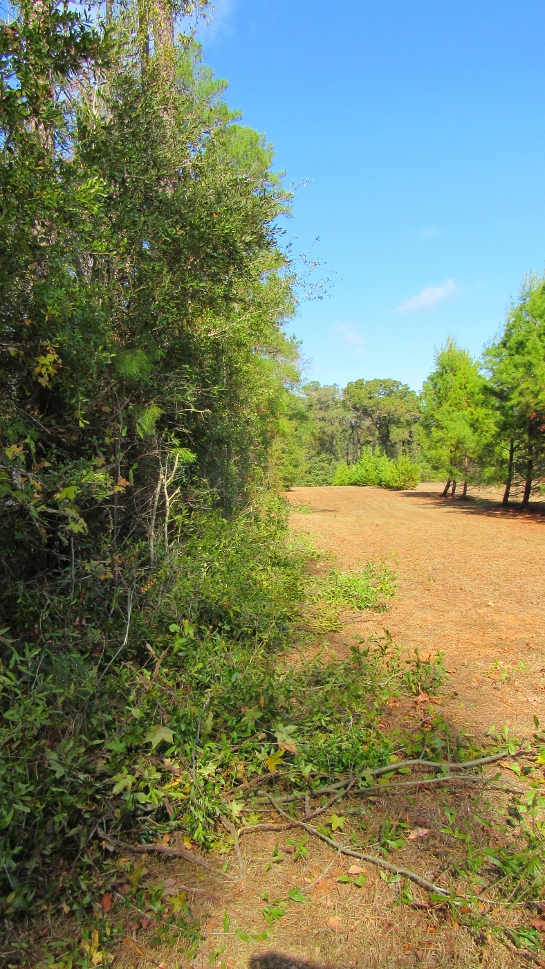

I decided to leave the mount as is and extend the hoses. The hoses are unique and can't be bought off the shelf but I have a Carquest in the next county that can make anything I want pretty much.
It works!

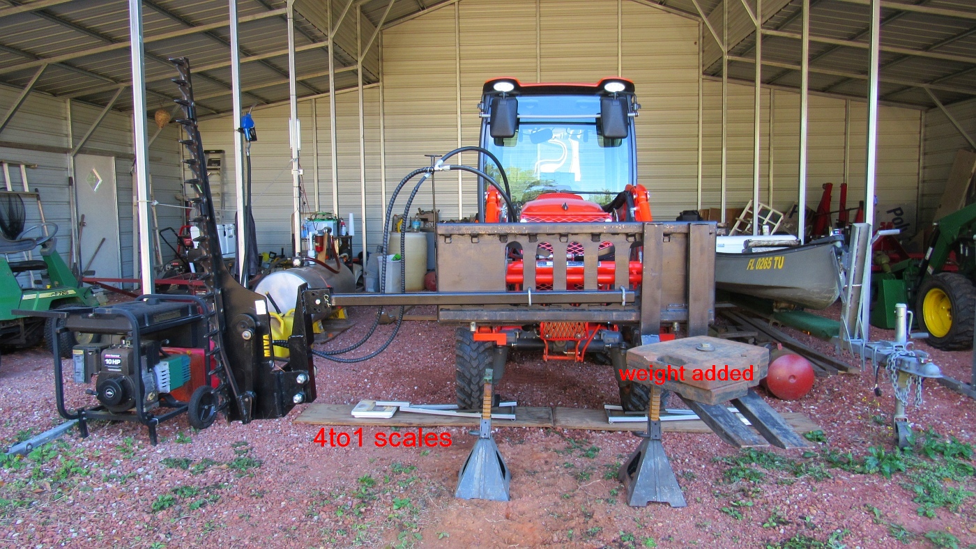

I did consider the weight hanging off one side. I weighed it and it only weighs 132 lbs even with the fabricated mount. What I forgot to consider is I run my tire pressures low for comfort and I didn't increase the pressure for this. The RF bead came off the rim when I tried to turn left away from the work. I had to put jack stands under the loader to lift it and pump the tire back up but the bead reseated easy.
I'm not going to try it again until I add a counter weight to the other side of the loader. Even at 132 lbs I am concerned about the uneven weight on the loader and tires.

I think a counter weight is an outstanding idea.
A 130 pounds, that far out, will certainly add a significant amount of torque to those forks.

I just looked up the specs on these 23x8.50-12 tires. They are rated for 1230 lbs @ 34psi.
I have some 4 to 1 frames for measuring corner weights so I think I will go all the way and try to balance the front end on it. I don't want something hanging that far off both sides and I have a couple of 100 lb suitcase weights so I think I will make a bracket to hang those on the left side of the loader and see how close it comes. I can probably make that adjustable so they slide in or out as needed.
Edit: With just the forks on the left side it is 84lb heavier at the right tire. I might get by with just one 100lb suitcase weight.
Thankfully this LA535 loader has the through frame torque tube design so hopefully it will hold up.
