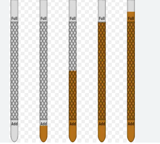

Where do you like your oil on the dip stick to read?
  • below min.
  • right at min.
  • between min and max.
  • right at max.
  • slightly above max.

regardless of peoples hate for oil threads... this morning I decided I would start a new one.
Most days the "old farmers club" meets at our local coffee shop (the kind the has waitresses not baristas) and that serves only the 2 approved forms of coffee in these parts (full strength or decaf) accompanied by the the only 3 approved sides (a slice of pie, a couple of eggs and maybe a couple of shingles with jam not honey).
Today's discussion was about oil changes and how much oil gets added to the pan.
It was unanimous that we all measure our used oil drained prior to refilling. The amount measured out guides the amount we pour back in.
The question then was on the dip stick, where do you like to keep your level?
Me, I tend to fill to the absolute full mark and admittedly sometimes get a smiggen above as often as I get a smiggen below. Hard to hit the exact full mark. Is this right or wrong?? I have no clue but it is what i have done since... well can't remember when I made my first oil change.
What say you about where you like to keep your fill levels or better yet argue what is best spot on the stick to keep your fill levels?

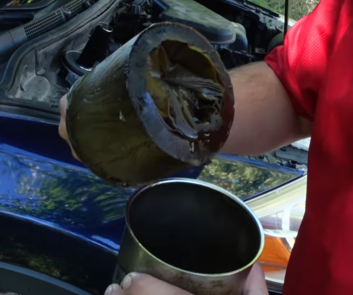

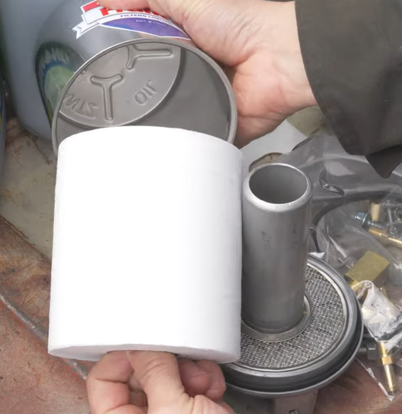

for those that don't know.... Frantz bypass kits use rolls of toilet paper inside a canister. oil flows through the roll of TP. The claim is never need to change oil again and engine will last longer with a continuous supply of ever clean oil.
the toilet paper cleans up all the crap that the oil is carrying.

I was driving a lot of miles each week. I changed the TP roll every other weekend. I really don't remember how frequently I changed the oil, but it was never dirty.
Guys want to argue about the idea of TP dissolving and plugging up the oiling system. As an experiment, lay a layer of TP out flat and put a couple drops of water on the paper, then do the same thing with motor oil. Totally different results.

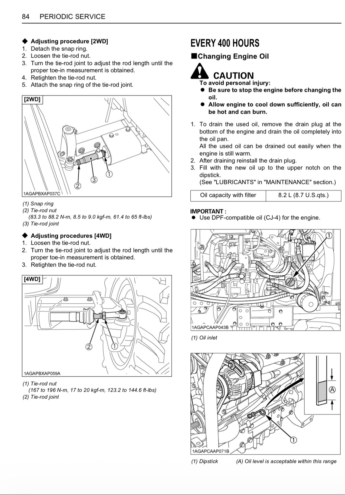

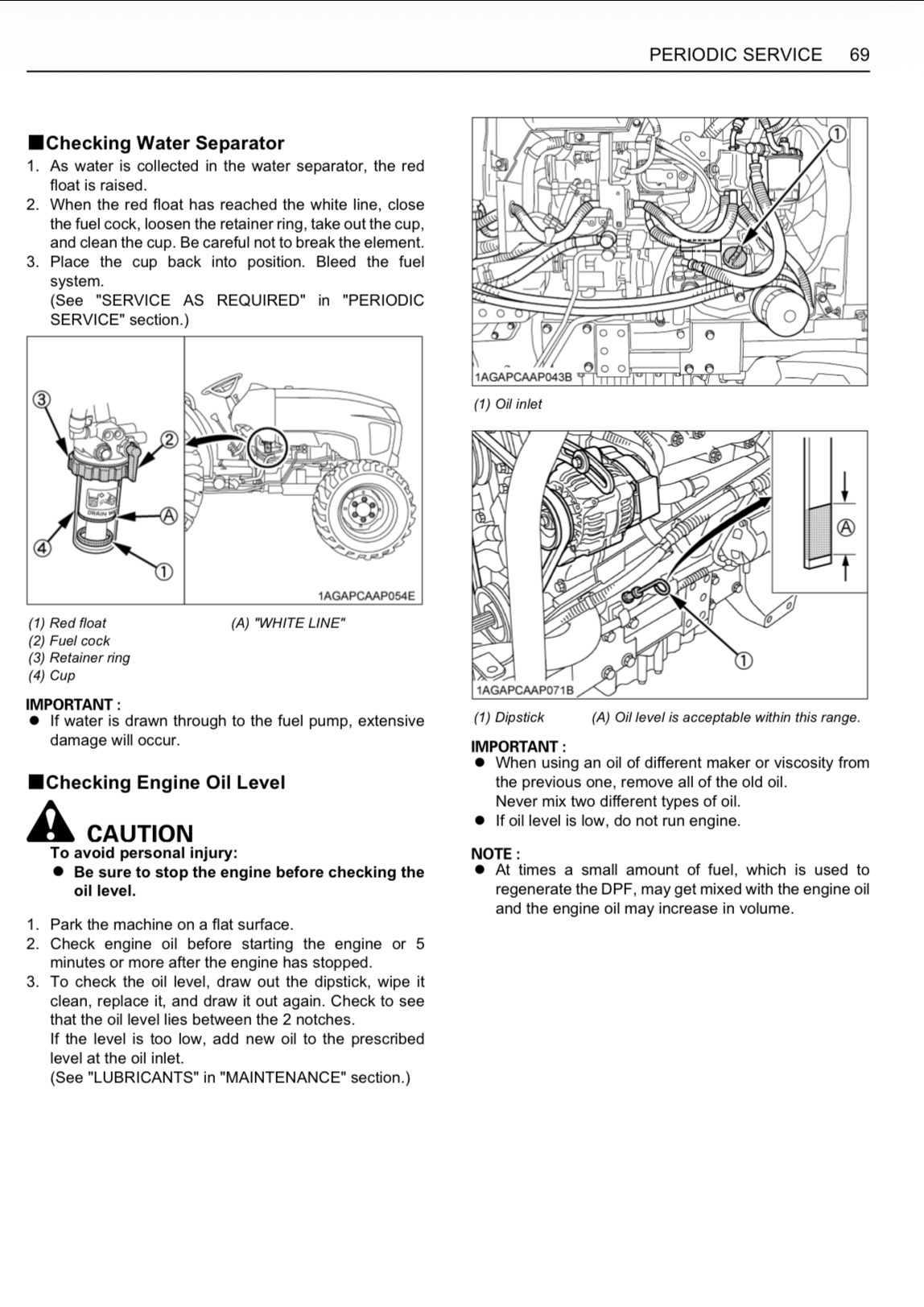

My L4701 is the first, and only, Tier 4 common rail diesel I’ve had to maintain. I don’t claim to know everything about it. I do know it’s quite a bit different from the 60’s and 70’s diesels I’ve dealt with in the past so I lean heavily toward following manufacturer instructions.
Kind of interesting to me what the OM for my L says about oil level. Under the “Daily Check/Engine Oil” section it says to make sure it’s “between the notches”. Also says the DPF (regen) process might increase the oil level slightly. Never seen that happen, but duly noted.
IMG_7349.jpeg The section on changing the oil says to fill to the upper notch on the dipstick. So I take it you’re supposed to fill it to start off with new oil right at max. After that, just make sure it’s within the safe operation range.
So I guess my SOP to keep it right at max is more a personal preference rather than a requirement. From a logical perspective, there’s no point in an operating range if it’s truly unacceptable to be anywhere except the top of the range. Also, at not quite 600 hours, so far it hasn’t lost any oil. I’ve never needed to add any in between changes to keep it at the max mark. IMG_7348.jpeg
