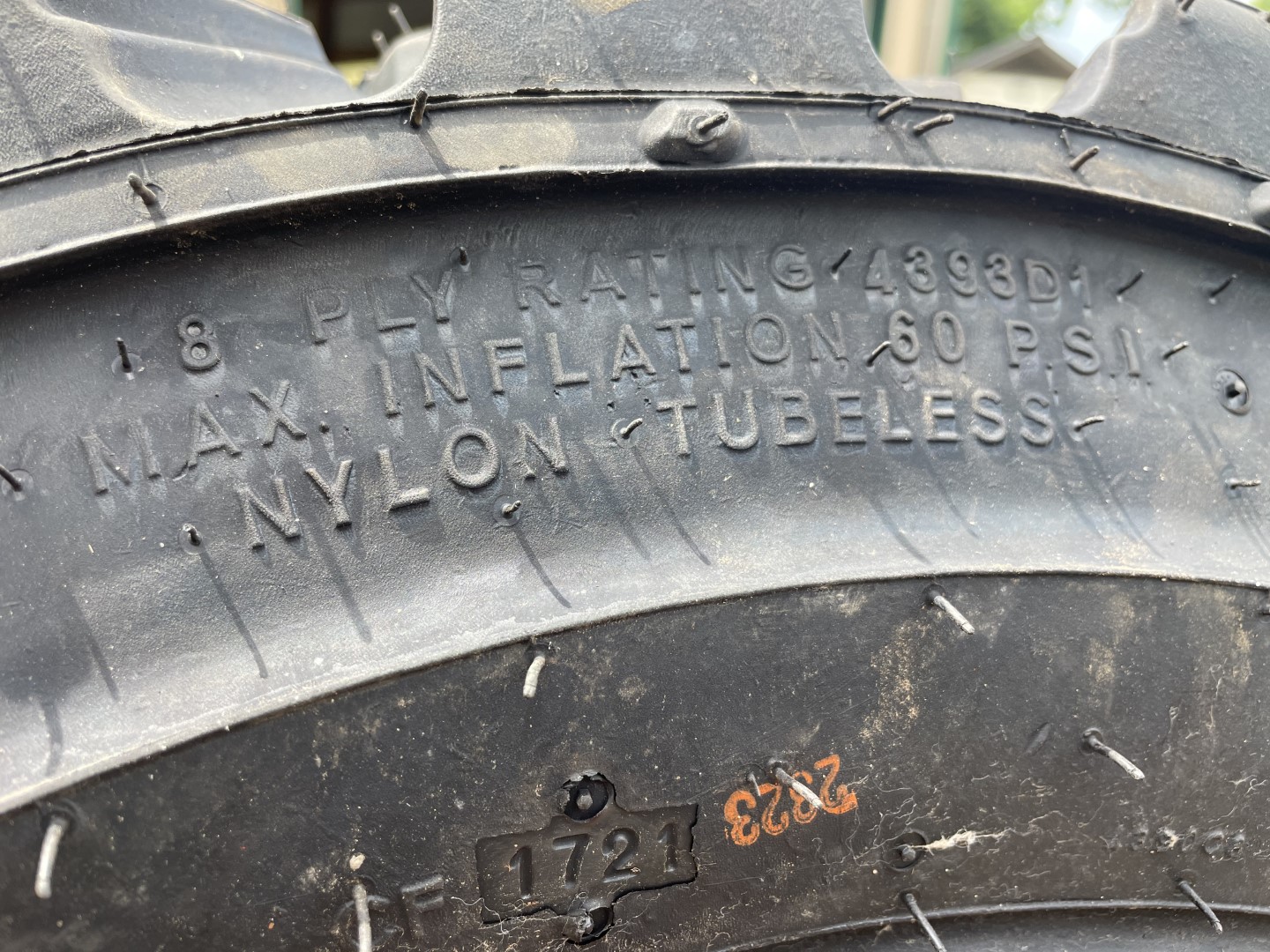

When I had to replace my front tires on my L4330 5 years ago due to age rotting and leaks, I went with 8 ply Titan Skid Steer (SS) tires for maximum weight rating.
According to Titan, it has a load rating of 4,140 lbs each per their spec sheet. https://www.titan-intl.com/-/media/Skid-Steer-Tires.pdf
