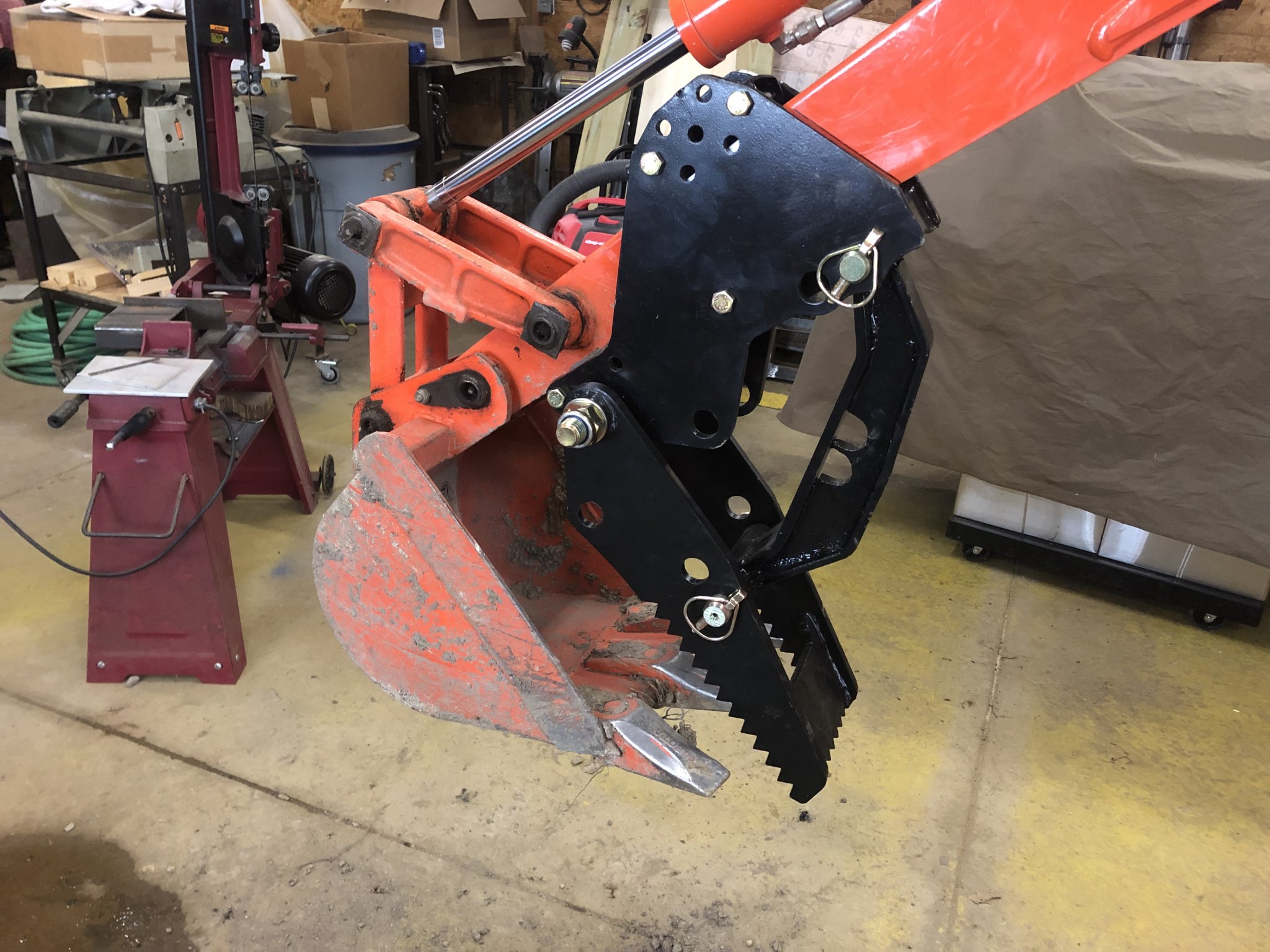

I had the Titan thumb on my BX24 for a while before I built my hydraulic thumb. The Titan thumb needed a few modifications just to fit. The most obvious issue is that the inside width is 1/4” wider than the stick so I made shim plates to fix that. When the bucket is curled all the way out, the bucket linkage hits the thumb by the cylinder. I cut the thumb for clearance, made a new channel piece to fit between the thumb side plates and countersank the holes for flat head screws. The fitting on the bucket cylinder was very close to hitting the thumb. The whole thumb would slide on the stick so I was tempted to weld it on. To me, it wasn’t worth the effort to end up with a poorly fitting piece in the end. Ended up selling to a friend who was gonna weld it onto a different small backhoe of some kind.

The 7blacksmith thumb looks identical to the Titan thumb I had. Probably made in the same China factory.
This picture was taken before all of the modifications.
