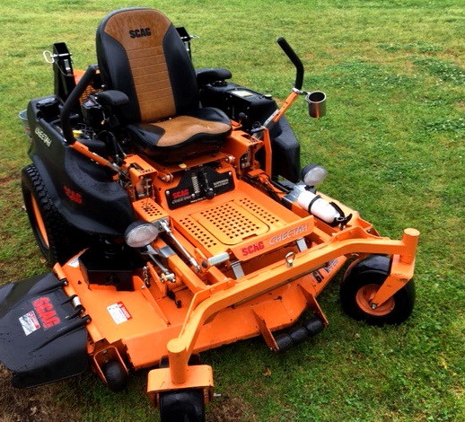

Hah......well that's an entirely different matter and goes sharply up the difficulty scale, if She's anything like my Wife. ;)
I have part of one pasture (about 5 acres) that I actually mow with my Zero Turn (deck up in transport position) simply because its faster than my tractor and does a better job.
I'd say it literally knocks half the mowing time off. Of course, I wouldn't mow 30 acres of pasture with it....but in some places, its just the ticket. Especially paddock areas up around the barn, down fence lines that are near the house, road frontage, etc....
Probably sacrilege to post a non-Kubota product, but its almost the right color. :)

@Flintknapper, if I had that Zero Turn I'd be posting pics of it as well! Nice machine(y)

That Scag is a very nice looking machine. We have a Cub Cadet steering wheel version. It tracks better on the hills and slopes we have on our property. That Cub has had a couple of summers where it was down more than it ran. That's the primary reason I would like a good, reliable finish mower now that I have a tractor with enough power to pull it again.
