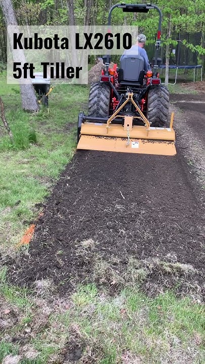

I run a 60" tiller on LX2610 with no problem at all. I believe that width of tractor is 54" and closer to 59" with the oversized tires.
