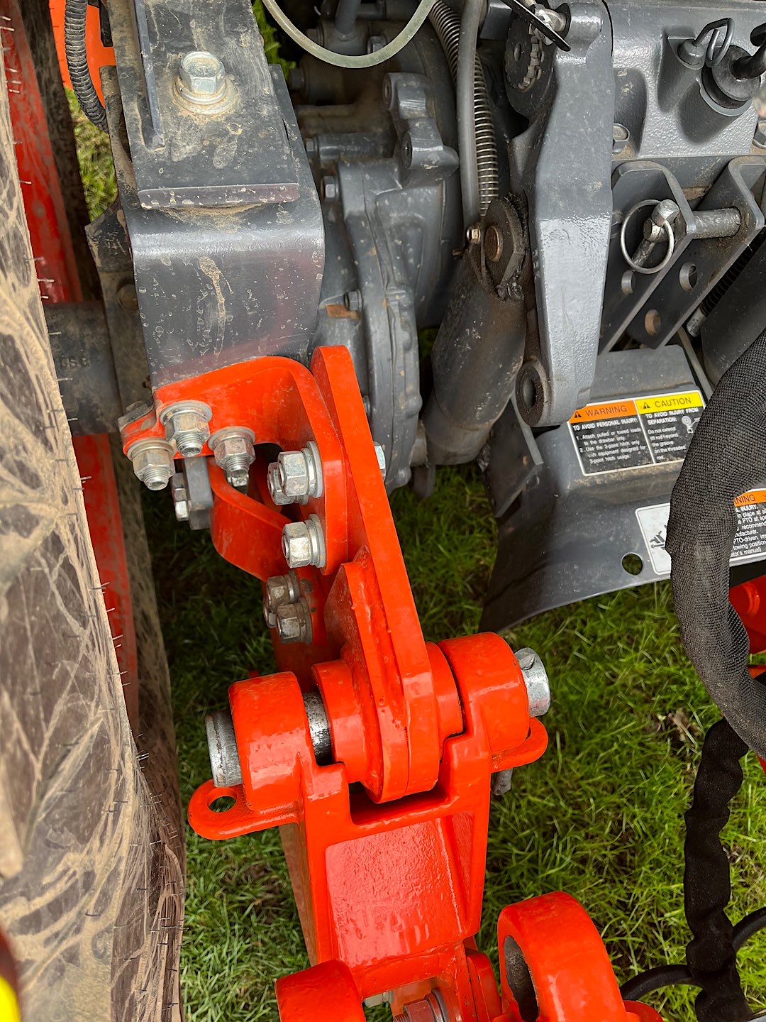

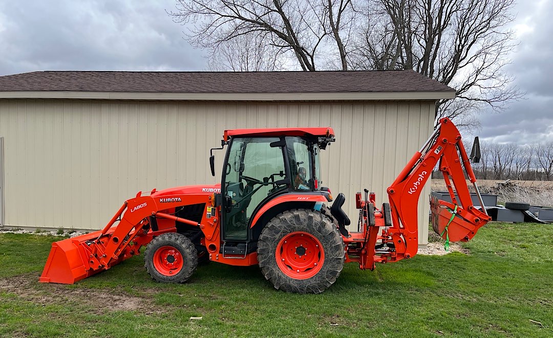

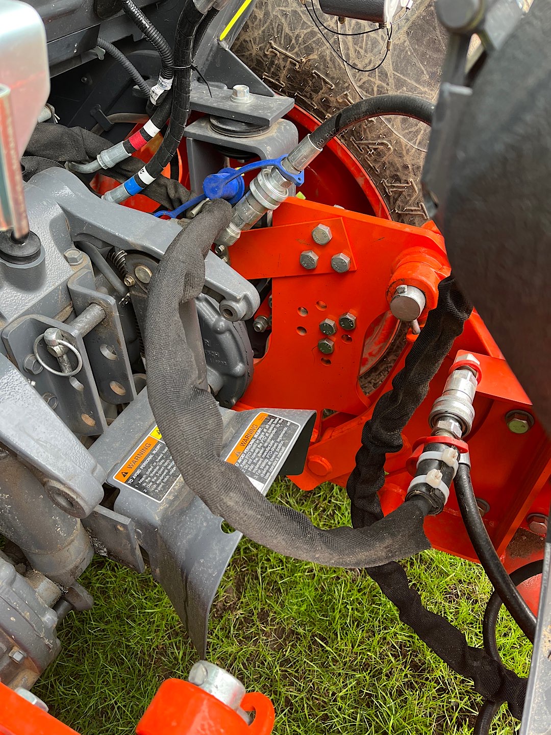

Assuming the dealer used the spacers. I've gotten used to backing up hills that are steep. I haven't had any problems but I have noticed if I have forks on the FEL instead of the HD bucket w cutting bar, I'm too light on the front and it tends to move too much when using the BH. Kubotafreak took his spacers out. I will take a side shot of mine w spacers and maybe he will without - to give you an idea.
When lowering or raising outriggers I stand between tire and outrigger, same if moving boom/dipper to line up the QA bucket. I feel it's safer in case I was to inadvertently move the boom and hit myself (if I was in front of the stabilizers, just IMO).
Having a shorter overall length could be advantageous though.
Good luck.

Here’s my side shot and pics of the mounts.
