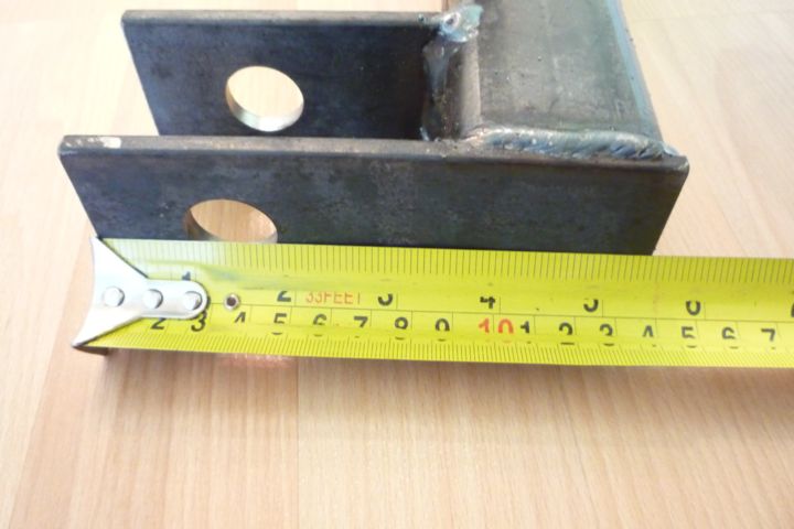

I'm too lazy to draw you up a plan, but here are a few pics with a measuring tape, if it helps.
I'm sure that the measurements could be adapted or adjusted depending on what you have laying around, but this one is 31-1/2" outside edge to outside edge on the bottom beam and the vertical bar is 18-1/2" tall from the top edge of the horizontal bar (20-1/2" from the bottom, which is where the tape was held in the picture).
This isn't the only way to build this sort of thing. I saw numerous ideas and designs online before I decided on this one, and what you have laying around for material may actually make a better design. I just used, as GWD suggested, the basic dimensions off of a few of my 3-pt implements for a rough outline, and made sure the pin diameters were correct when drilling the brackets before welding them on (3/4" top link, bottom links 7/8" diameter).

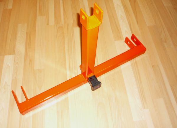

Hi Chip
I'm afraid I have to go with GWD on this one, I looked at one at a common equipment supply store here in Edmonton, and they have draw bars for ~$32. The downside is that I would then need another ball (another $10), and the drawbar, without any add-on stabilization, would rotate in the side link mount holes. I suspect they are more meant for use with a hitch pin and trailer tongue with and upper and lower plate to it, not a ball hitch. As well, this way I can use the same Class II hitch that my wife's little SUV takes, and plug other things into it.
Finally got paint on it the other day - I don't know about you guys but I LOVE this color!

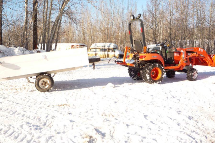

Warm day here, finally got a chance to fit the trailer on. Have I mentioned lately that I love this shade of orange?:D
Now I just need to find my good 7/8" side link pins, they're here somewhere (had to borrow the tiller's pins to try this out!)
