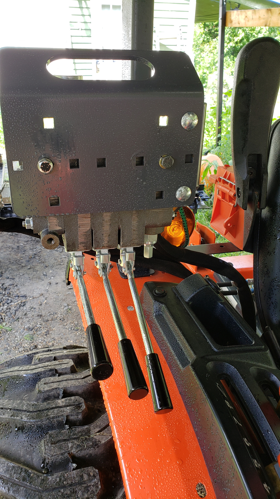

I have a top and tilt on my machine with the LP QH. I never leave the seat. I have 9 attachments that are all QH compatible (I modified a few to make them compatible).
It doesn't matter which one I am dropping or which one I am picking up, Unless it needs PTO I never leave the seat. Another beauty of the T&T is the attachment really doesn't need to be on flat/level ground, you can pick them from a lot of different angles.

I only use the QH on about half my implements due to different "standard" pin locations. I always have to use the top link pin as none of my attachments allow me to use a hook with any ease. The hydraulic top link is nice to have but is a PITA with a cab when I have to fine tune positions and I'm off the tractor.

... The hydraulic top link is nice to have but is a PITA with a cab when I have to fine tune positions and I'm off the tractor.
To me that seems odd as I never need to adjust it when I am off the machine.
IMO the ease of "picking" 3pt attachments is only a single reason to have a top link. The biggest benefit I get from it is being able to change that angle on-the-fly. Doesn't matter if I am raking over a crest or into a valley, rototilling up or down, box blading etc. You can do a much better job if you can change that angle on the fly.
Another big benefit is the ability to maximize lift when loading/unloading or when you need some quick clearance. Adding the tilt cylinder is the icing on the cake for a quality job.
