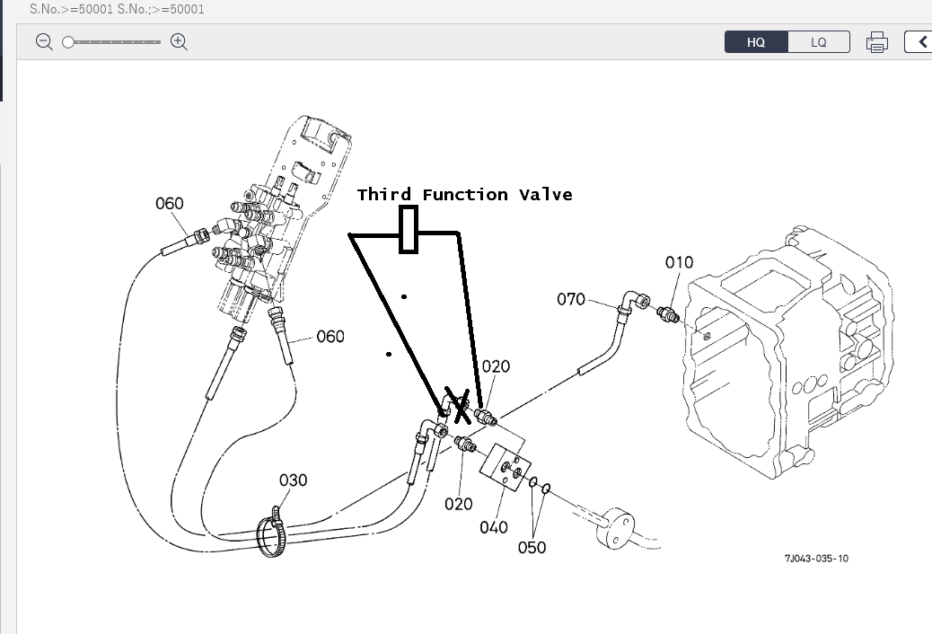

I am not clear on exactly what you installed so I can't provide a diagram of it. Here is your loader plumbing - two lines going to the hydraulic outlet block on the side of the tractor. A typical third function kit would be plumbed in as shown in my marked up parts diagram:
  1. Disconnect hose #60 at hydraulic block and reconnect it to P or IN port on third function valve
  2. Run a new hose from T or OUT port on third function valve back to open port on hydraulic block
That's all it takes.

OK '- I looked at your other threads a day or so ago. The plumbing is the same simple circuit as I diagrammed. Power beyond feed from the loader valve to tractor gets moved to IN on the 3rd function valve block and the outlet from the 3rd function block goes back to the tractor.
I will look over your other thread to see the specifics of what you did.

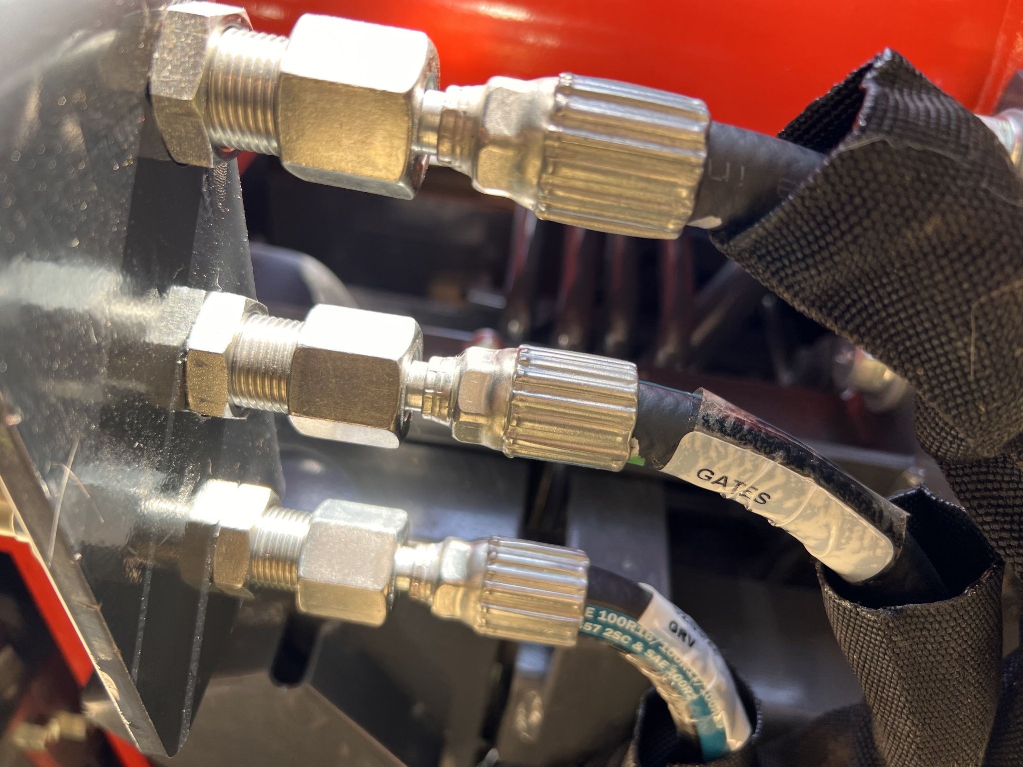

I found the problem. Wait until you see how easy it was to get this messed up.
Inlet hose is orange, that one I got right or nothing would have worked. PowerBeyond is Green hose. Outlet is grey.
left to right is supposed to be Orange, Grey Green. Looks correct, see the green?
Pull back the sleeve and its a different story.
Marks are not very big.
Looks like I have to reverse those two lines.
