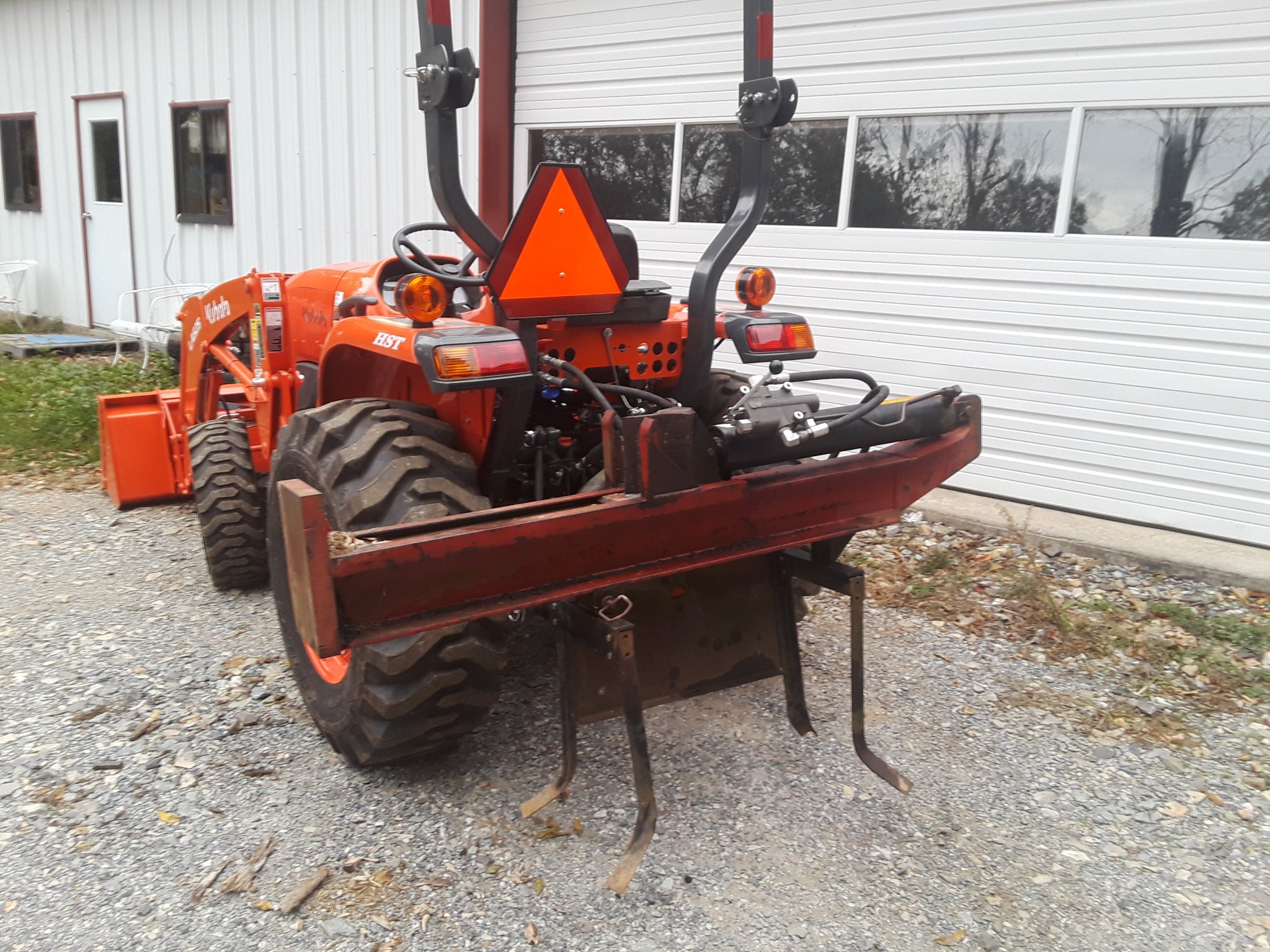

A set of rear remotes would be the place to start. Pictures of the splitter hoses and valve would help also.

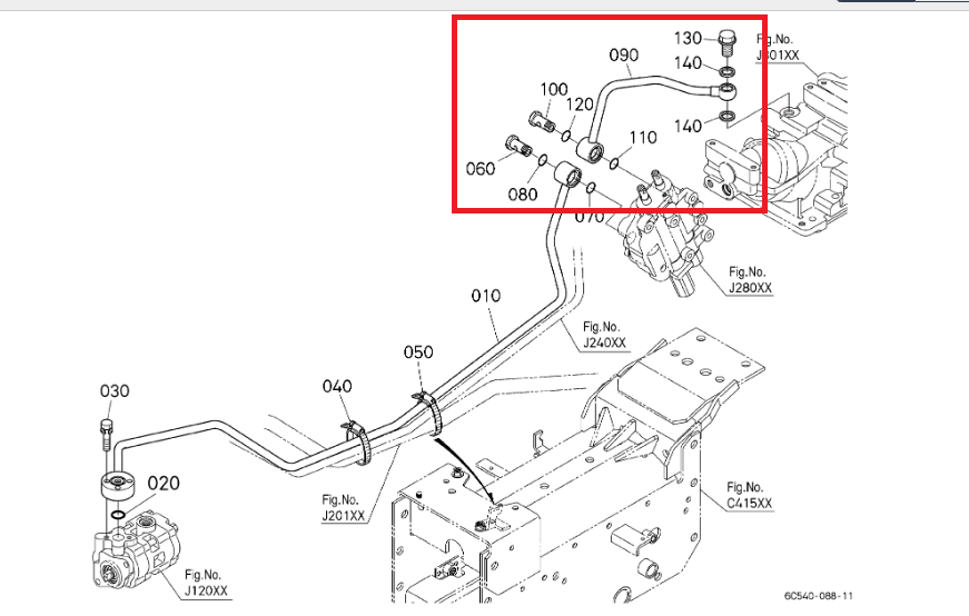

You simply need to reroute the power beyond coming off the loader valve to the rear and back again to the hydraulic cover. Assuming you do not have factory remotes its pretty simple:
  1. Remove the power beyond pipe number 90 in this diagram
  2. Using a banjo to male JIC fitting and bolt number 100 connect a hose to the port on the loader valve and run it to a femakle quick coupler on the rear. This is pressure supply out for the splitter.
  3. Using another banjo fitting and bolt number 130 connect a hose to the port on the hydraulic cover and run it to a male quick coupler on the rear. This is pressure return from the log splitter.
  4. I am not positive but I think those two banjo joints are different sizes so remove and meassure them both to determine what size adapters to buy.
!! WARNING !!
  • To connect or disconnect the couplers you MUST turn the engine off.
  • When the log splitter or another implement is not connected you MUST loop the male and female quick connects together.
Simple as that. If you wanted to get fancy you could add a 3 way selector valve to the lines going to the rear that would allow you to connect and disconnect without shutting off the engine and eliminate the need for looping the lines together when the outlets are not in use. That is what I did for the log splitter outlets on my L3901 and it works beautifully.

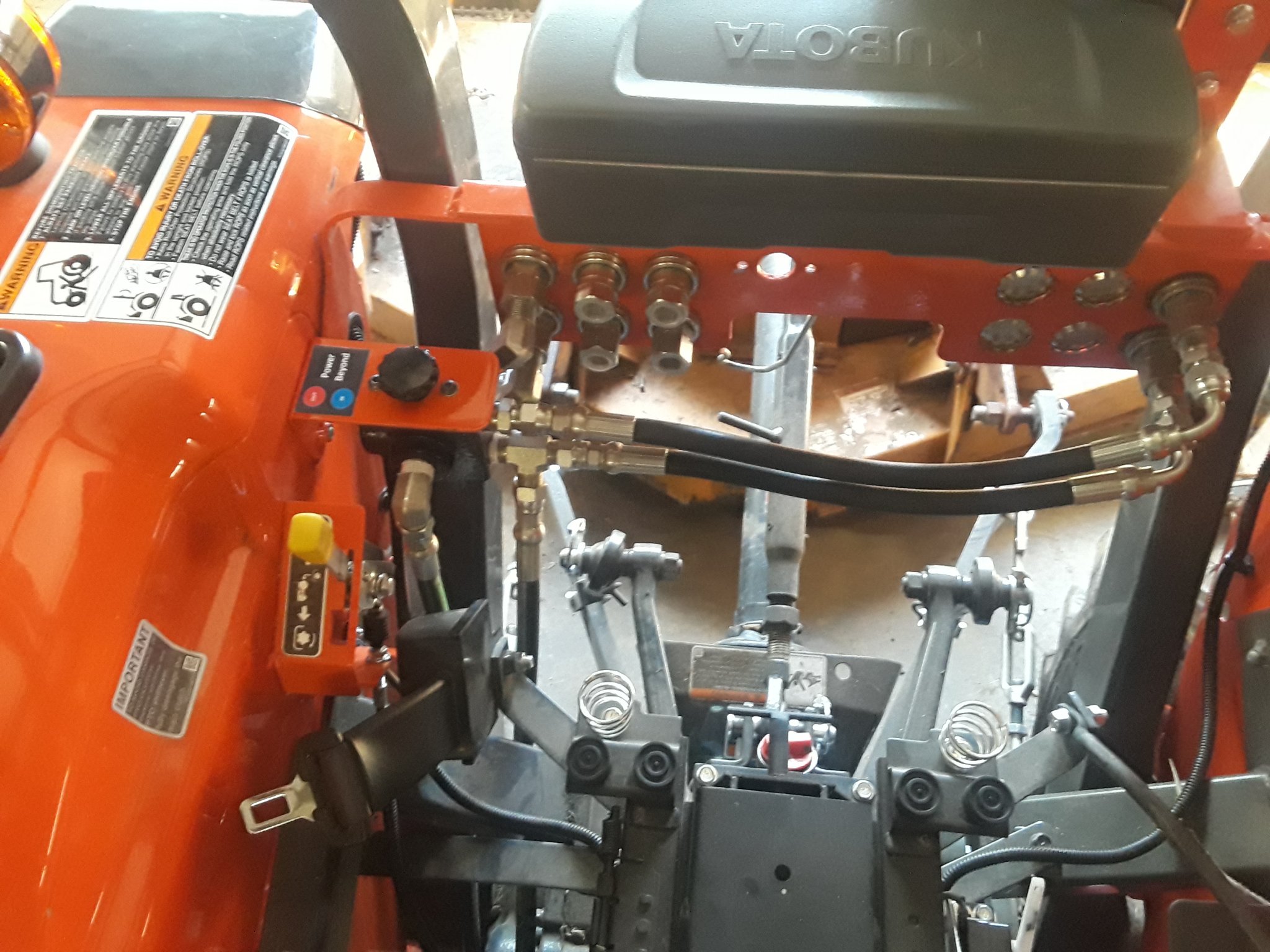

Just FYI here is the push-pull selector valve I used for the outlets on my tractor. Its just one hose in and two out.
  • When you push down (no implement connected) input flow goes out to the tee and back to 3pt.
  • When you pull up (implement connected) input flow goes out to top outlet, through the implement valve, and back to the 3pt tee via the bottom outlet.
Easy-peezy.

I made the rear outlet mounting panel (better picture below) and its custom to the L01s. There is not much to them - just some holes for the sleeves on the couplers which are retained using snap rings. That is standard panel mount setup that gives you easy one hand push/pull connection of the implement hoses. Its my prefered way of mounting outlets. Simple enough to make a two-holer for log splitter outlets using a hole saw and some 1/8" thick sheet steel. Just need to find a place on the rear to bolt or weld the plate on.
The selector valve I used is a Prince SS-1A1D that I purchased from Surplus Center. I have used quite a few of them on the hydraulic kits I sell. You could mount it to the rear of the tractor oand put the quick connects right on it if you wanted. You would not have push/pull hose connection but its simple and convenient to operate while standing next to the log splitter. As you can see in my mounting panel picture I originally had mine mounted on the right side next to the bank of outlets but the plumbing runs were so short the hoses didn't have enough flex so I decided to move it to the fender.
