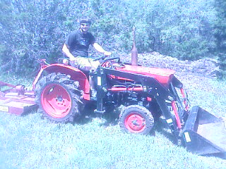

Our family just recently purchased a Zennoh zl 1501 with a 2cyl diesel. I believe it is the 18 horse model it says 15 for the pto. The previous owner said it correlated to a Kubota L 185 and I was wondering if this was accurate. I was also wondering if anyone knew how much weight the 3 point on this tractor can lift.
Thanks Guys

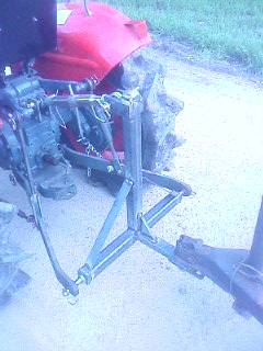

Thanks for the info. I am building a traler hitch to move around all our trailers and I wanted to make sure it could handel our goosenecks. It sounds like it will from your post. I also do have a front end loader attached so I think it should be enough to couter balance. If not I can always go grab a load of dirt.

That would be a good idea if I had thought of it and wasnt almost done with the hitch. Also we have a 2 wheel drive and I would be worried about traction with some of the trailers. I will see how it goes, I may end up doing one of each. I will let you guys know I am planning on finishing the hitch tomorrow and I will post the results.

From what I can tell in the pics that's some clean looking welds. Nice work, I would say that it's nice enough to be painted orange. I love to see a bead that looks like a stack of dimes on their side.

On another note thanks for the compliment on the welds. I have been welding for about six years now and it is always nice to be complimented on your work. I just did a quick spray can job to keep the rust down, but I am seriously considered painting it orange. I tried to lift the trailer with the FEL but I had no weight on the back of the tractor and it picked the rear tires up. My next projects, besides some general maintenence, I think will be to make a pto powerd welder or a balast box that I can put a ground engaging 3 point implement on. I will either do that or look further into balasting the rear tires or wheels somehow.
