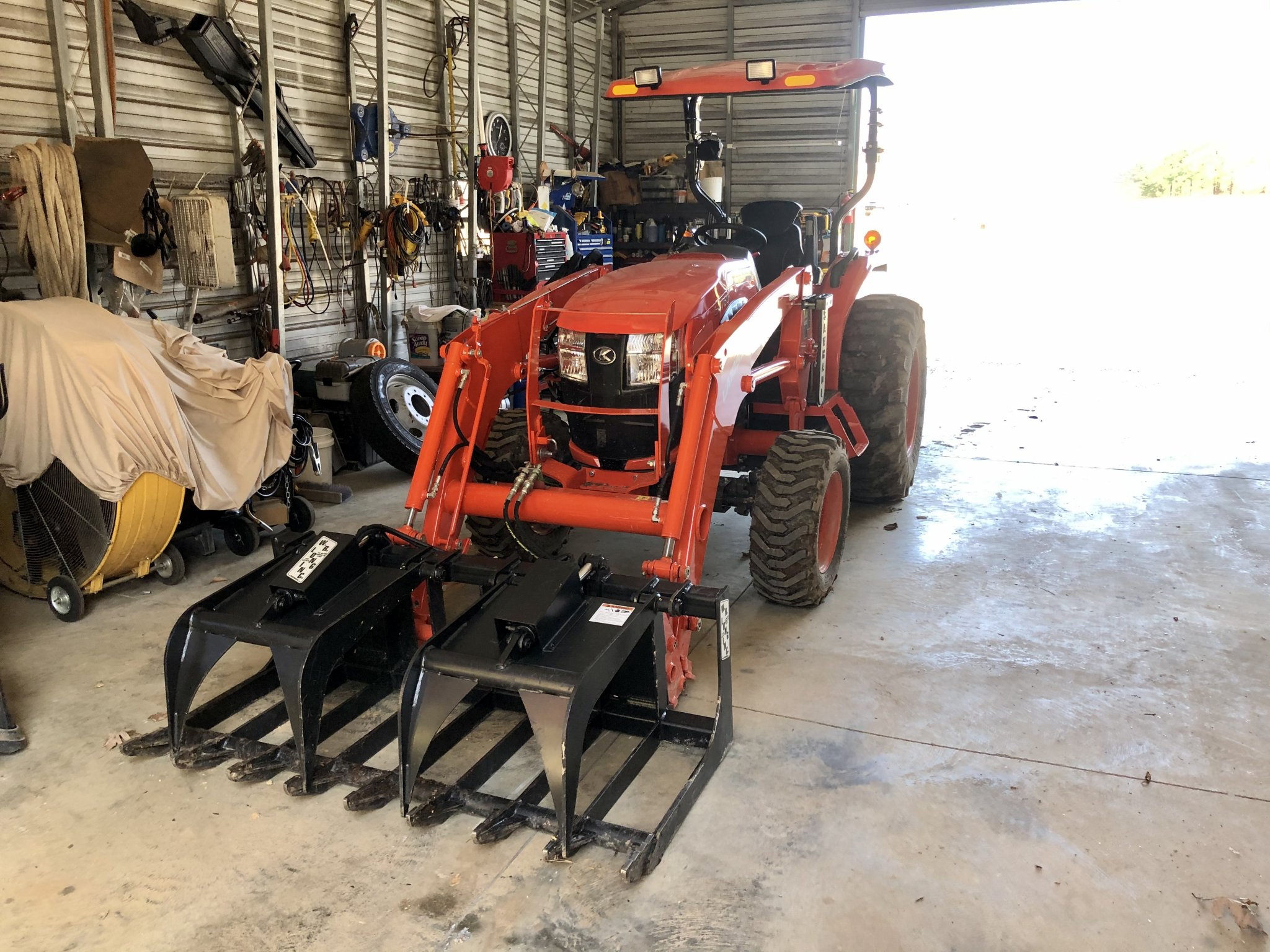

I have a 72" MSI with teeth that weighs close to 700lbs. With just loaded tires that bucket owns my 4760. With the Kubota ballast box loaded with gravel approx 900lbs and the loaded tires, it works very well for digging, grading and carrying large loads of materials. As a way to clamp on and move stuff the 4 in 1 works but my 66" root grapple works much better.
