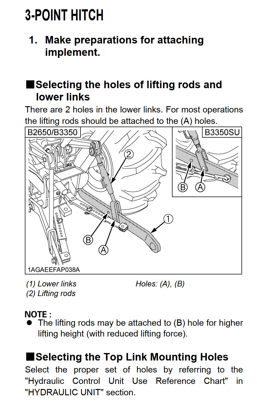

mine does the same thing...it lifts the arms at "1" but if I'm attached to an implement (which I always am) the implement wont lift off the ground until position 4 or 5 depending on the implement. That's because of the height of the lift points on the implement (they are higher than the lower link arms in position 1-4).
This is most noticeable when I have the rake installed, it's lift pins are pretty high off the ground.
If its a problem for you, you can always move the position of your lift arms in closer to the tractor (it will lift the implement higher). There should be another pair of holes in the lower lift arms that are slightly closer to the back of the tractor. Details should be in your owners manual.
here it is....

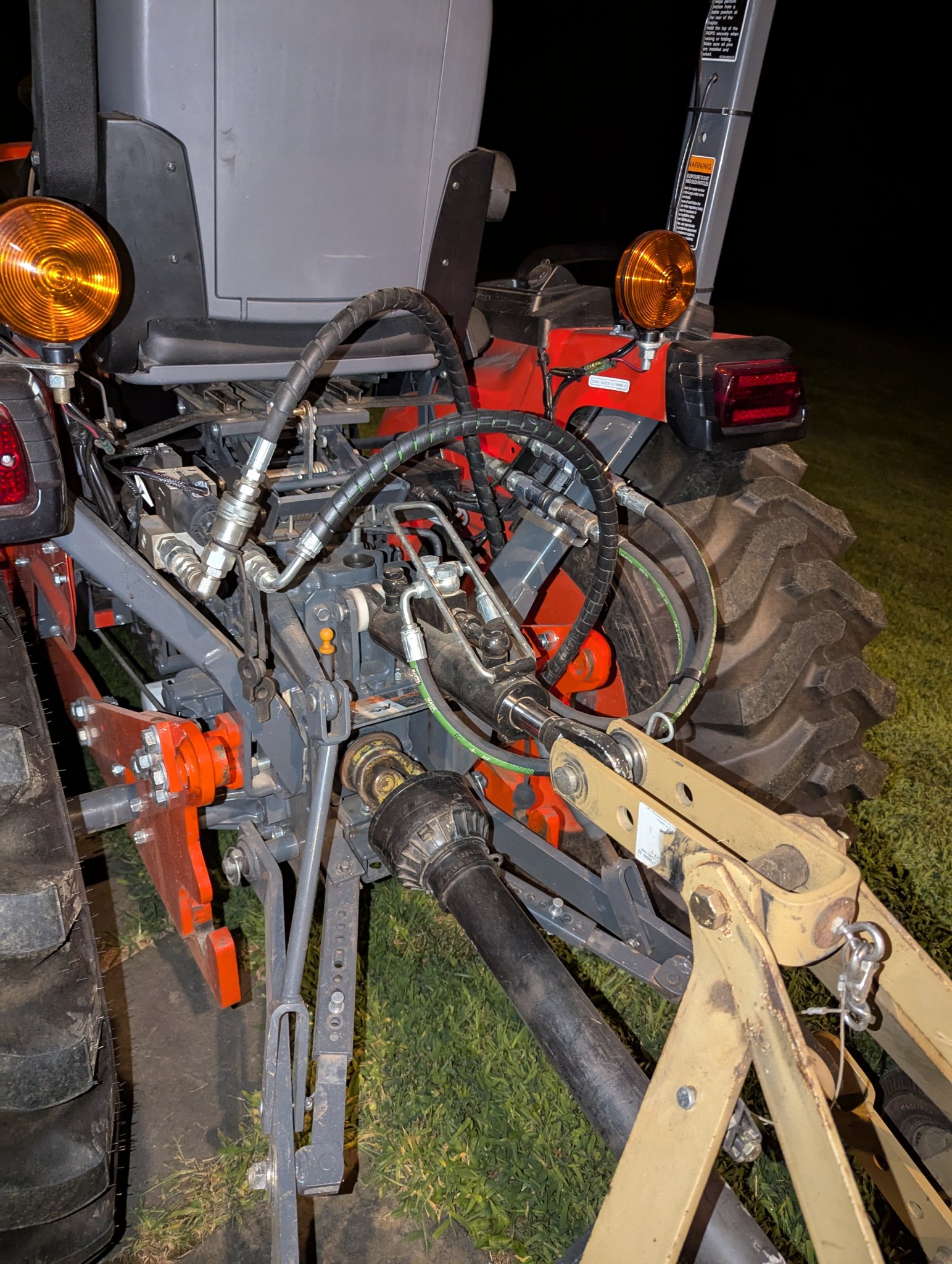

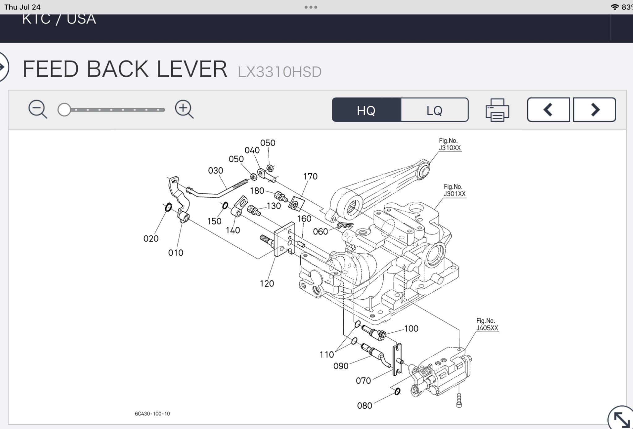

@Bonj
The illustrated parts list shows the feedback rod (#30) on the rear right hand side. It should be attached to a tab that will move when the upper short arm moves. I don’t know if that is what you are saying but here is what it looks like.
