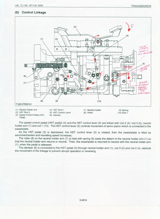

With engine OFF make sure the pedal pivot is ok and free to move.
The diagram below is page 3-M16 from the L48 WSM showing the various linkage parts. There are 10 items to check, when I was figuring mine out I added arrows to the drawing showing the direction things move to go "forward".
With engine OFF look for anything restricting motion. Lever 5 should be vertical in neutral and swing both ways with spring-return to center. If needed disconnect lever 10 from 5 and verify 5 swings equally about 35 degrees CW and CCW.
Let us know what you find. Best luck, Dick B
