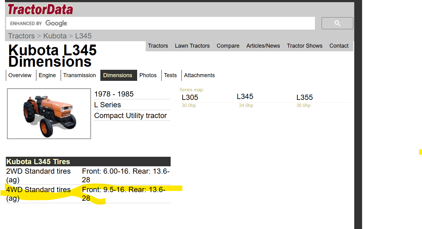

Front tires look much larger than the stock 6.00-16s. And, the LF tire is a Carlisle, so it's been replaced too. Looks to me like LF has been replaced recently. But, lugs on that tire are fairly torn up, so it's been used (a lot?) in 4WD. I'd check rolling circumferences before driving it in 4WD on a grippy surface (like pavement).
Rears should be 13.6-28.
Easy fixer-upper. I would probably have paid at least $4000 or $5000, at auction.

Yessir, rears are 13.6/12-28. Fronts are 9.5 16's., listed on sidewall as 9.5-16 or 240/90-16. They both match with RH front being very new.

He can NOT switch to 6.00-16s that would be the wrong size.
He has the right size tires on it now.

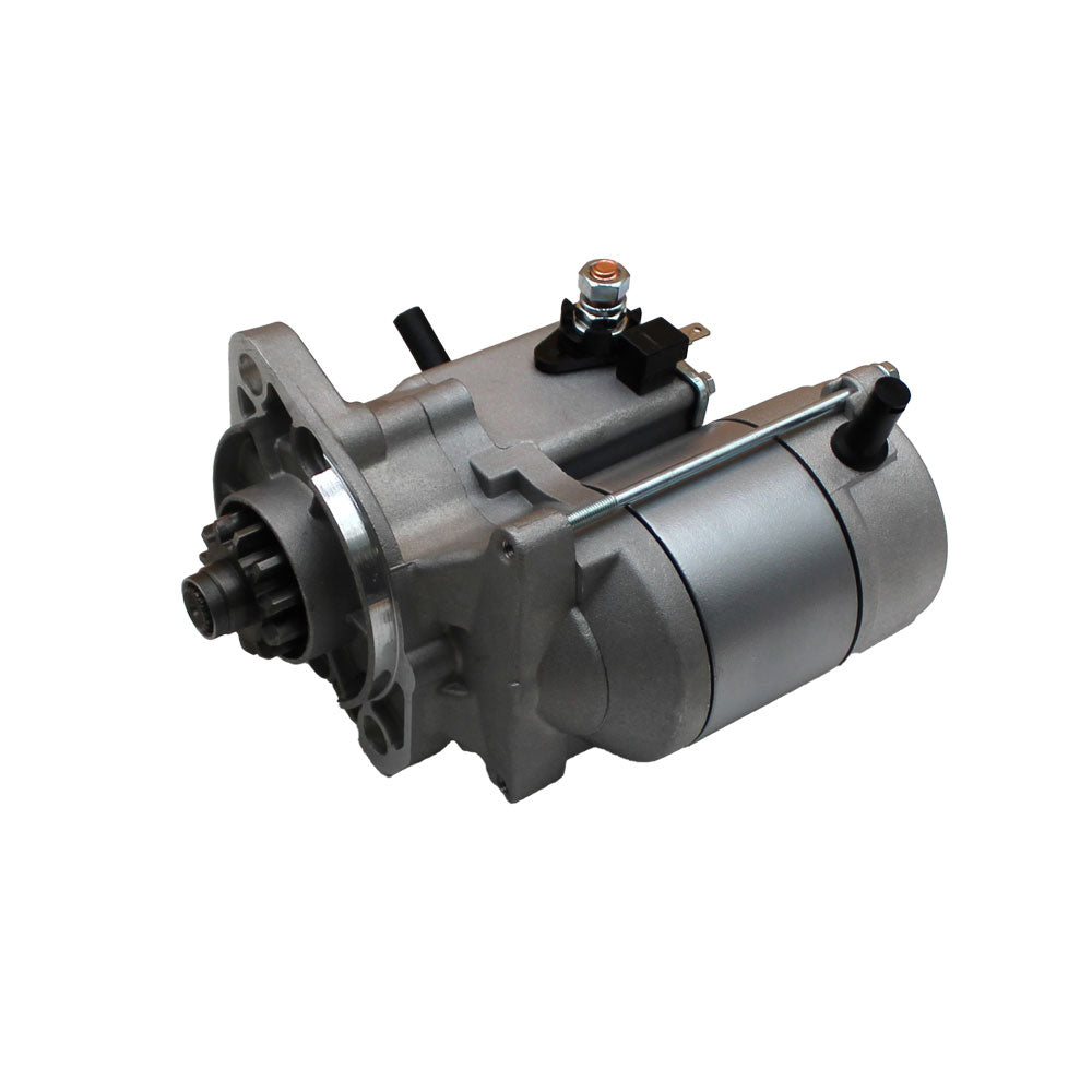

I'm wondering if i need a new starter (which would have a functioning solenoid). From Messicks and an earlier conversation with my local Kubota parts counter it appears the solenoid is discontinued, but the entire starter is still available. Wondering if this would eliminate this "extra" part. Would make sense that the previous owner jerry rigged this to avoid this $500 part.

You can probably get a rebuilt starter from some local starter repair shop. There may be some available online.
But the wiring is now probably somewhat hacked up.
I looked at the illustrated parts list and the starter is part number 15601-63010 (but you need to verify that is correct). The illustration looks nothing like the pictures that come up searching for the part number!
You would be far better off getting an aftermarket starter.
$183.99
The start circuit is super simple it will go from the ignition switch, through a switch on the clutch and then to the starter solenoid.
$183.99
I missed this post.
Someone could not have bypassed the solenoid, as that is required to engage the bendix (gear Drive) for it to start.
What they have done is added a second solenoid that is more than likely feeding power to the first solenoid.
You can very easily check the starter and the starters solenoid and jump it like you are doing to the top solenoid.
Just jump from the battery cable on the starter to the small solenoid terminal.
