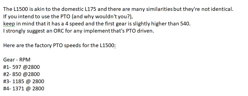

It has the 4 speed PTO and just wondering if anyone knows the speeds of these?
Not sure where I got this, was a Word file (apologies if you are reading this!)
L1500, I would ?think? would be the same.

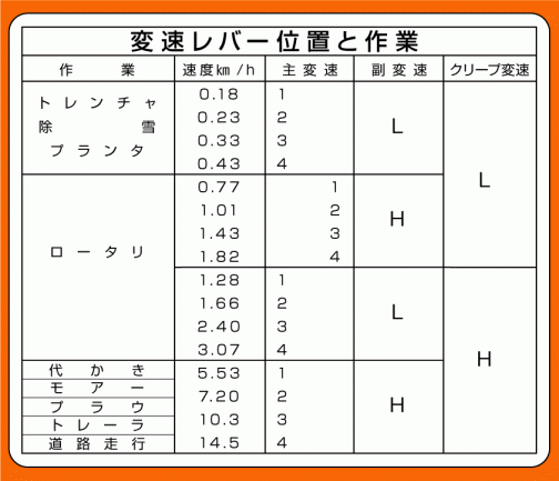

I have no idea what this is but my notes say it is for the L1500 also (in km/hr);

What's an ORC?
Over running clutch. It is a one way clutch that allows the implement to wind down with out turning the PTO and pushing the tractor into the fence, barn, etc.
