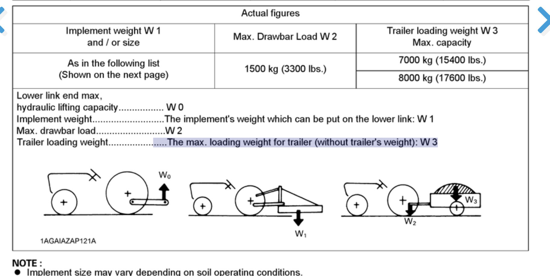

long time lurker, first post, We have 250 acres in middle TN, I was looking to buy an M5-111 to pull a 15 foot bat wing for mowing and buy a dump cart for pull river rock from the hollar up to use on the roads or pads. I was looking at trailers like this European style. Looking at Kubota's owners manual it looks like the tractor is only rated to pull 13,200 lbs. So if these trailers are 8000-9000lb empty it would be a complete waste. The M6-111 is only rated for 17,600. What is your guys thoughts? I need to come up one hill and then its flat ground for moving the rock around.

European models are built heavier and are built to be roadable, thus they have a higher haul rating.
Best option would be to drop the size of the trailers your looking at, load them light, and use front and rear ballast on the tractor.

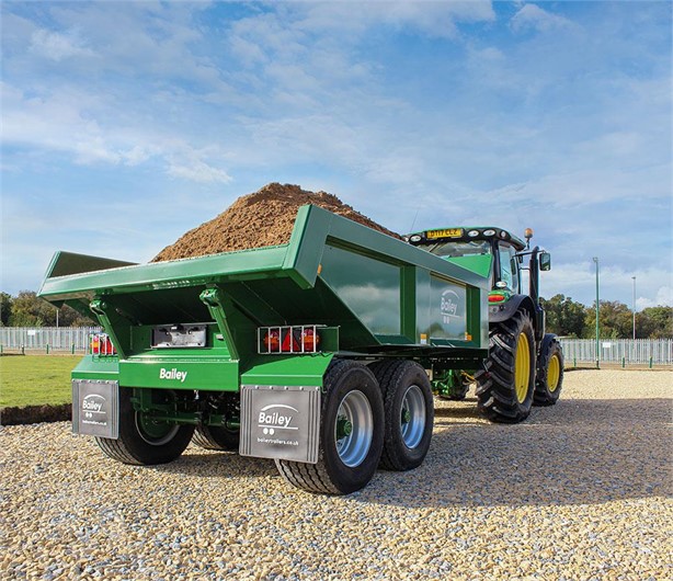

That thing looks like a beast! A dump truck bed with a trailer tongue attached.
I like the fact that it's painted instead of powder coated. Makes the finish repairable.
