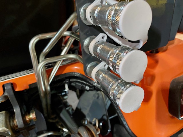

I am a newbie with tractors and am looking at a BX on a used dealer lot to do mostly mowing and other light duty tasks around my new to me property. At some point, I might be interested in a FEL and wondered what the plumbing requirements are if I buy a BX without one? A dealer has a BX2350 for sale with no joy stick but has hydraulic ports. Would it be as simple as buying a FEL and then a joy stick control valve assembly and bolt it on? Or does it need a hydraulic pump as well? I tried reading threads discussing this, but was just confused in the end.
I am new, so can't post a picture of the machine I am looking at but hope you get the idea.
