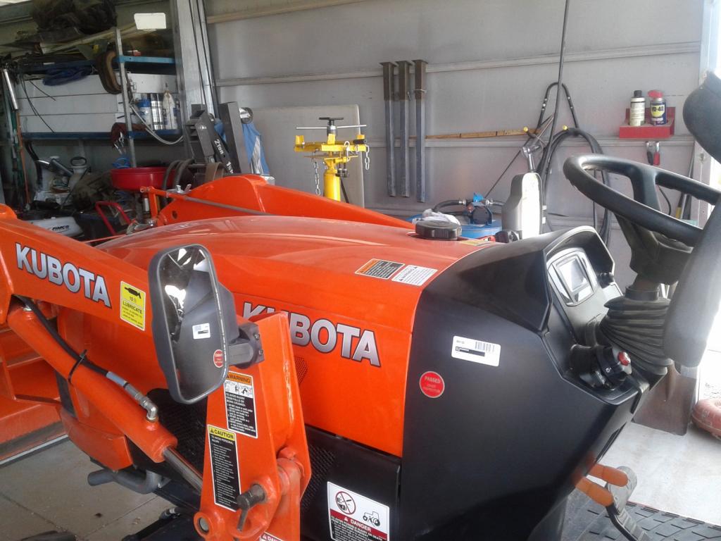

I have provided a picture of the top & tilt units that I would provide for an L3560. 2 1/2" dia cylinders with 1 1/2" dia rods. Just something for comparison. ;)

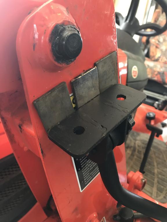

Thanks NIW for fixing my bad @reference. I have 2 Kubota rear valves and notice that there must be a slight fluid leak as I see oil soaked dust on the valve assembly. I plan on cleaning it up and looking for a leak and perhaps tightening the assembly. I wonder if torque settings are in the Work Manual? With my finish mower I float the Tilt because I have the optional Floating Top Link kit on my Quick Hitch. It allows the mower to follow terrain in the direction of travel where the Tilt float allows side to side movement. I have never dug into the dirt with this setup.
