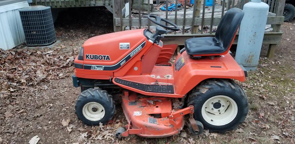

I thought I was told it was a B2900, but looking at the tractor itself it is indeed an L2900. I know it is the GST as it is written on the side of the tractor.
In terms of the battery, the battery is strong. When the starter does engage, it turns over really well and has been starting the tractor without any problem to -20 Celsius [-4 Fahrenheit]. My thought is that the control wiring into the ignition relay is the issue because of the lower voltage. I'm guessing that with less than 12 V the relay is not making a full contact to close the circuit?
I am not a mechanic so I defer to the expertise on here.
