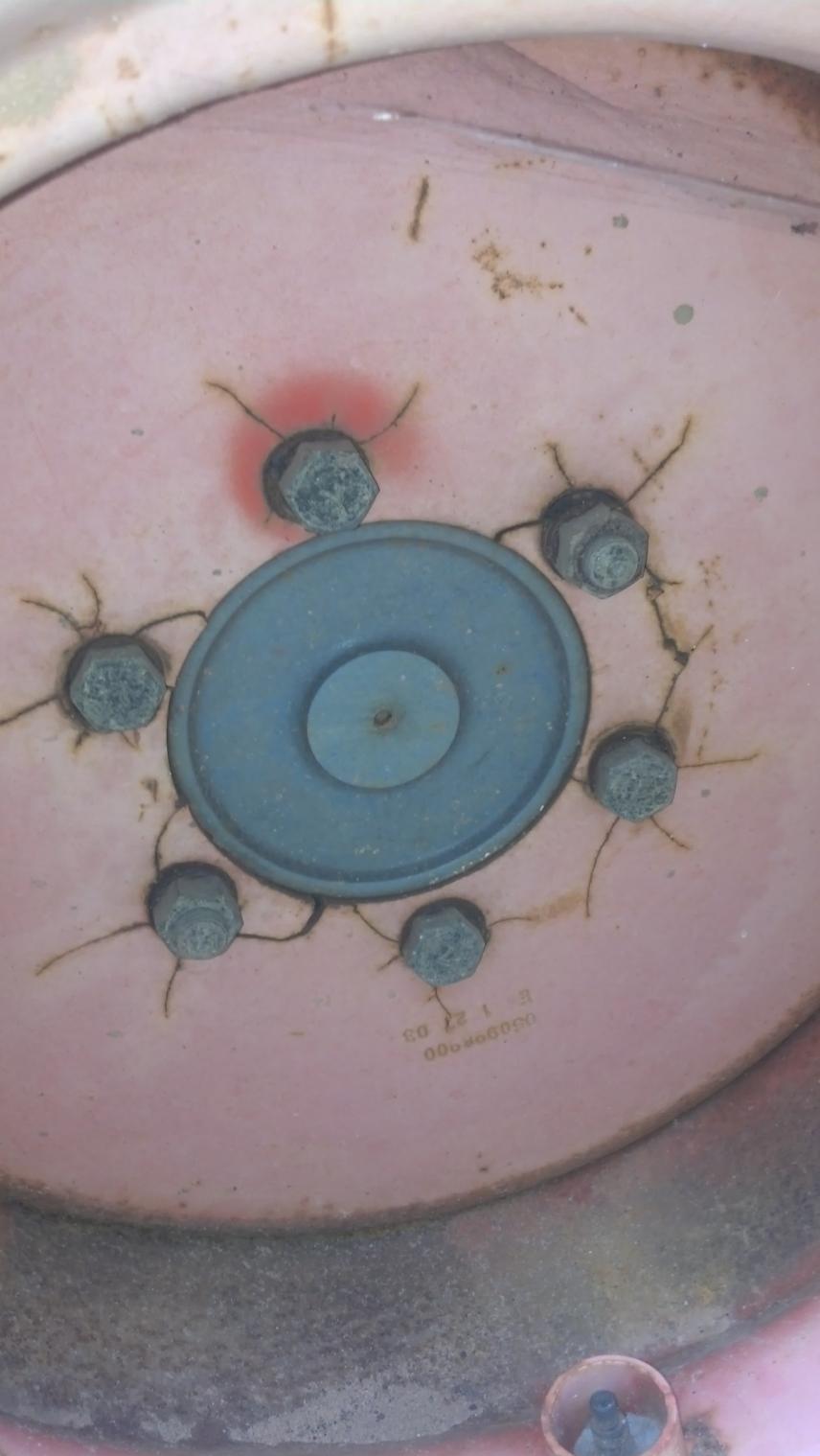

Kubota L35 (right rear)... Been looking like this for as long as I've known this tractor. Sometimes will make popping and cracking sounds... Why is it doing this? Was it abused? Wrong kind of steel used for the wheel? I've never seen anything like this... :confused:

I would guess the rim will fall off once all cracking goes completely around bolts. Were bolts over tightened or liquid rust the rim outward, just a guess.

Can be brittle iron but usually if a rim was ever ran loose the holes get wobbled out then upon retightening the nuts or mushroomed holes do not seat properly and start the cracking, this is pretty common, I see it on trailer rims a lot. Time for a new rim...........quickly before it falls off and tips you over.
Excessive side loading will cause this as well. Guys who pull goose neck or fifth wheel trailers and jack knife heavy trailers while maneuvering or backing into tight areas and side load the rims more commonly aluminum rims see this quite often.

a temporary fix is to use a washer to fit the lug and tighten really well, but is only temporary.

Hi, the reason the rim is cracked is probably because it wasn't torqued properly when it was installed. You might be able to take it to a rim repair shop for an estimate or just get a new one. Before you install the new rim replace all the studs and nuts, be sure the mounting surface (brake drum surface) is free of rust or other imperfections and that the surface is flat. It wouldn't hurt to use a little never seize on the threads, try not to get it on the rim and nut tapers as it will give you an improper torque reading and you will proably over tighten it. Hope this helps Barry

i agree it was loose at some point, now it needs to be junked or repaired.
I had one that wouldn't tighten due to the hole being worn and the nut bottomed out before the taper of the nut would contact the wheel, i was able to find some larger nuts and grind off some of the taper to make them work.

Just lovely... I also noticed that this wheel doesn't look exactly like the wheel on the other side... No idea which one is "supposed" to be the correct one for an L35. Could be either or both... I guess I can call my parts guy and see how much for a new wheel and dis-mount/re-mount the tire... dang it! :eek:

There are several online sources that sell wheels for fairly inexpensive prices.
What size tire / rim combination does it have?
I would also suggest that you change the lug bolts / Nuts at the same time, they look to either be wrong style for that rim or heavily worn.

I would peel/sand/grind back some of the paint near those cracks, and I think you will have your answer. That's a spooky looking wheel in my book, and the possibilities are not pretty.
Is a L35 a TLB? Using the 'hoe to reposition the tractor can put lateral force on the wheel if not picked off the ground, or using the hoe without stabilizers down firmly when digging to an uphill, or preferred side? If that side is not the OEM wheel, maybe it was done to two wheels over the years? Just a theory.
