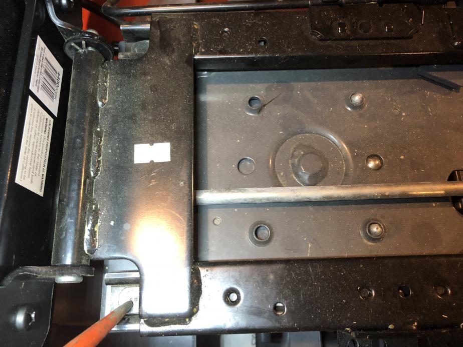

check to see if you have all 4 mounting bolts for the seat slide bracket.
pic below showing location of the left front bolt (tip of center punch). There are 4 on the bracket (one on each corner)

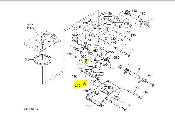

Check to see if this is it. Part number 32160-18440, called cushion. Listed under "seat" in the parts list.

Yeah looks like that's going to have to be how I go about this. I don't remember the warranty details, I'm literally a couple days past 1 year from them rolling it off the truck here. If nothing else maybe they can at least give me a part number. I expect it to be cheaper and faster to source it myself anyway. D2Cat, I don't think that's it unless it's been replaced/upgraded? I couldn't find anything similar to it on Messicks either and not know wth it's called complicates the search, lol. Thank you for the help, though. I guess if something had to break or fall off the damned thing, I'm glad it was this... Whatever it's called. I'll check with the dealer tomorrow and see how helpful they're willing to be.

Alright, emailed service department and they came back with the same part D2Cat did. Replied with the one Wolf gave me and asked for confirmation. Forwarded it to my sales rep and he said it would be covered under warranty. Hope that's the last thing I'll need it for... Thanks again guys!
