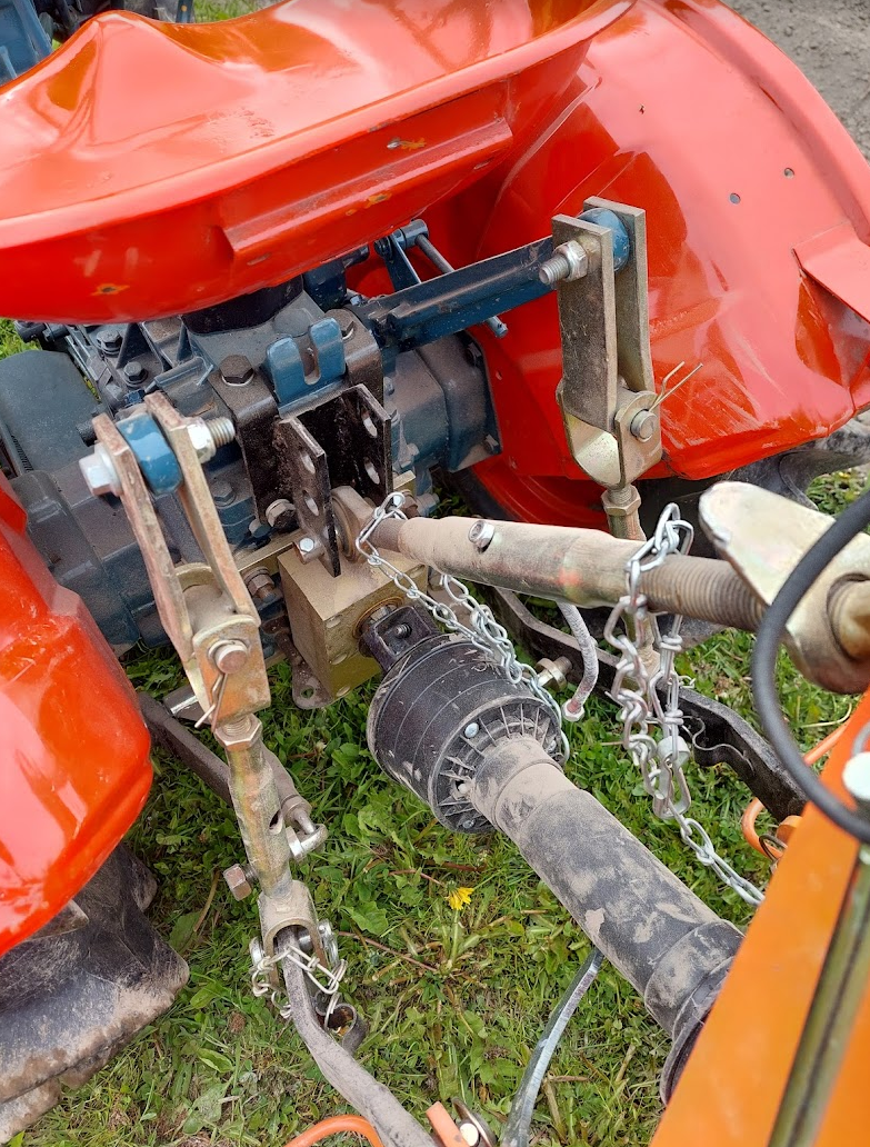

I'm not finding small enough PTO shaft for rotary tiller and flail mowerfor my kubota. I live in Finland so it's a challenge for finding small accessories. The smallest shafts with shearbolt start from 25kW. Usually that's not a problem, but would the shear bolt be too strong to shear before the b6000 stalls if the tiller gets properly jammed?
The space between tractor and implements are also quite small.
Now I have Kramp T10 shaft without shear bolt and I'm afraid to go tilling with it, used it with the flail mower mainly now.

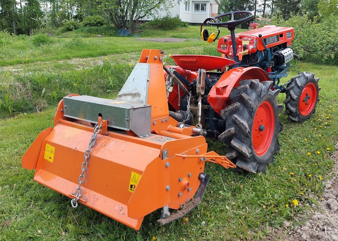

Mateng TL85 tiller and NEFL95 flail mower.
Slip clutch would be a good consideration, as it could be adjusted, I'll check out those if there are small ones available. But first I'll have to check the implements if there are shear bolts already in those.

The original B6000 tiller connected slightly different than a normal three point tiller.
It used a different lift linkage and a constant velocity joint to get it done.
I take it you already have a adapter gearbox on it, to change direction and spline count, and that adapter which shortens the distance even more.
One option if available locally would be a quick hitch as that will move the tiller back a distance, making it easier to get a PTO shaft to fit.

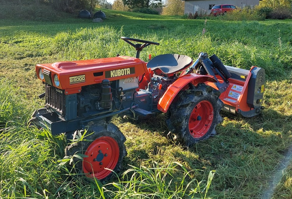

Pic of the machine with tiller and mower if anyone is interested to see the darn thing..

That's the cleanest B6000 I've ever seen!!
