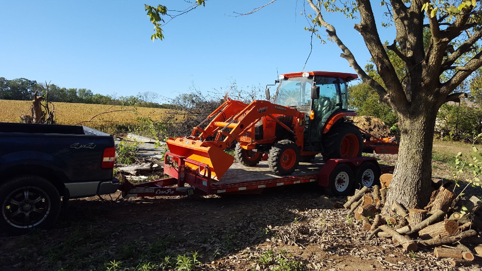

Ok, I'm wondering if any of you have trailered a L3560 using a F150? The 3560 with FEL and cutter should be right at 4000lbs and then another appx 1800 with trailer. So...5800lbs-6000lbs...my 2018 F150 says max tow weight is 9000lbs That seems heavy to me for my little V6 but thats what the manual has. I have trailered my Honda Pioneer 700 and I know its back there but its only about 3000 pounds w trailer; the L3560 would be double that weight. Anyone trailering a L3560 & bush hog with a V6 F150?
Yeah, I know I need a F250 or similar...Anybody have an extra $70 grand for a new truck?

I have the 2.7L Eco Boost and it does have the tow package. All the specs say 8500-9000 MAXIMUM, and I emphasize MAX. Still seems like a lot to me. While not extremly hilly here in the valley, there are quite a few hills in the immediate area, and within 15 miles or less in any direction, I would be on the Blue Ridge....and thats probably going to be mostly a '"no go zone" for me.
Max Tongue 1160lb
Weight Dist 11500lb
Max Carrying 5000lb
This is what is on the hitch, so there is a bit of confusion to me with such discrepancy on those numbers. I need to look all that up.
Its a Ford hitch

Right. Technically, your max weight for conventional trailer would be 500# tongue weight. As Fordtech mentioned, that is the limitation of that factory installed hitch, not the truck itself.
It sounds like your rig should do just fine. Honestly, I wouldn't worry much about it. You'll feel it, but those turbo's really shine when pulling in hills. Especially, when mated to the 10 speed. Put it in tow/haul mode and carry on.

So that’s what is stamped on the female side that came with your truck?
tongue weight, is the weight on the ball attachment point of your trailer. The downforce weight that you drop on your truck. You can lighten or make heavier, by moving your tractor back or forward on the trailer. You will feel the difference. You want a few hundred pounds toward, not a “light” tongue weight.
Weight dist. Is max pulling/towing weight. Usually more than your truck is capable of pulling. ( legally rated at)
Max carrying is everything in and on the truck. Passenger weight, fuel, junk in the trunk, and tongue weight.
So 4 people750lbs, fuel 100 lbs, a quad and ice chests1200lbs, 600 lb tongue weight towing 5K trailer. =Safe to go down the road. PROVIDING tires are rated for weight (both truck and trailer) hitch pieces are rated where you need to be, and trailer balanced well. Every link in the chain matters. A crappy ball, that fails, and your trailer passes you will ruin your life and maybe someone else’s too

That's the tough part about towing with a cutter on the back. You really need a long trailer to balance the load especially when using a half ton truck.
