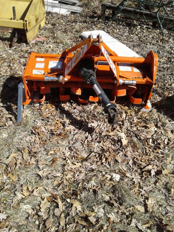

I bought my 5' tiller from Rural King. King Kutter brand, but listed as a Rural King model. They have 48" models that should work on your machine. I don't know where you are though.

Do you use a quick hitch? If so I recommend the 5' tiller. Rural King/King Cutter has 2 4' tillers. One model appears to be QH compatible and the tiller is offset (to the right???) The XB model needs to be modified for the QH.
I had to buy longer lift pins and used washers to space them out (added QH bushings. Top link, moved bushing to front hole and separate bolts in rear holes. You will need to size the pto shaft also.

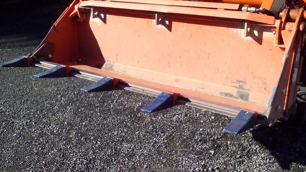

Made my own tooth bar with replaceable teeth
Used bobcat weld on bucket adaptors. These are welded to 100mm x 10mm flatbar. The whole unit slips on and off in a few minutes.
These are really effective in heavy clay and for big tree roots.
