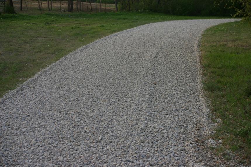

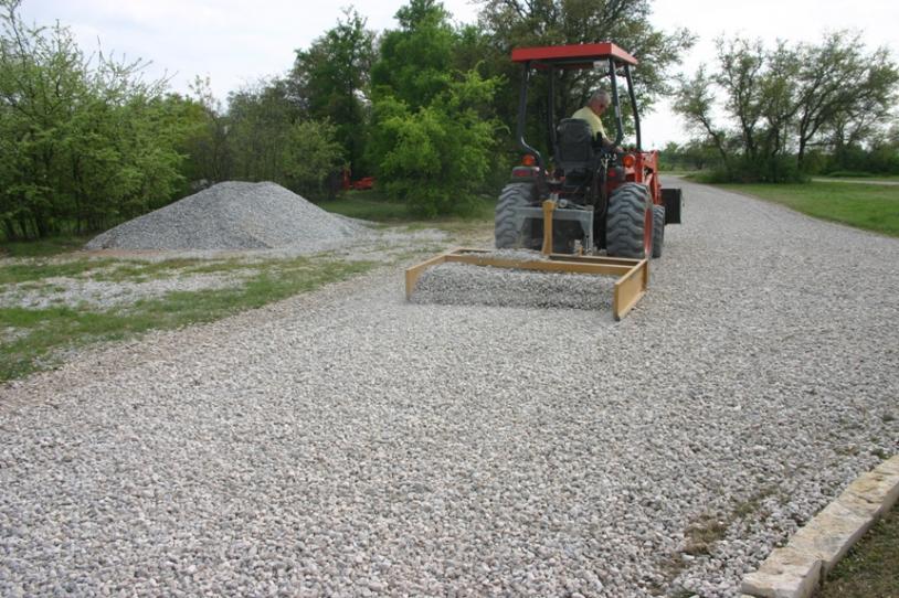

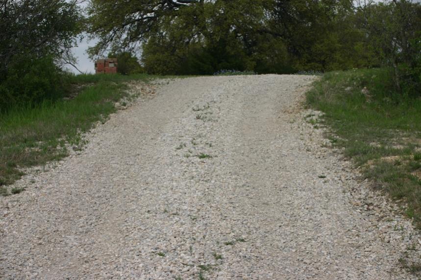

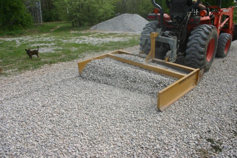

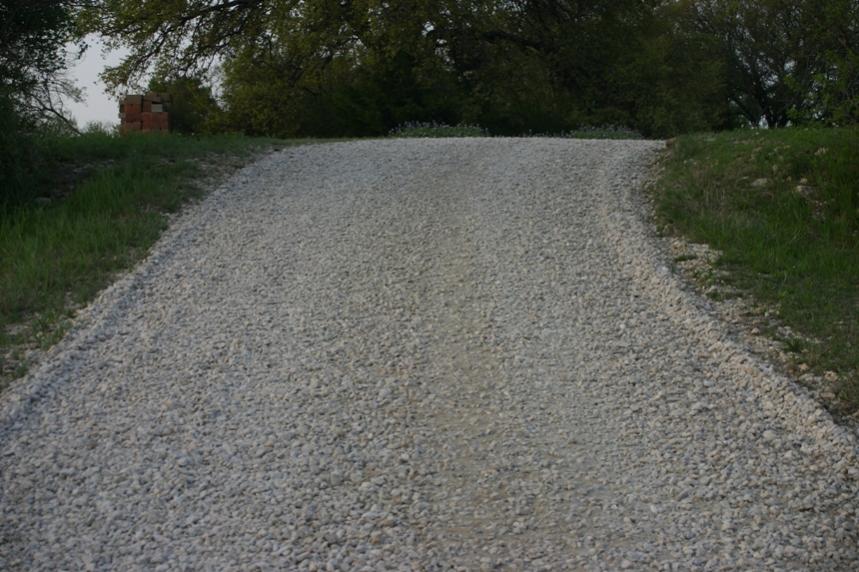

Marty, Sorry for taking so long to reply. My blades are 3/4" below the bottom of the skids. I finally got to grade my road a week ago. It took me a while to get the pics downloaded and resized. But here they are. The first one shows what the road looked like before and the last two are of the graded road. In the past, I ran the tractor over the road to compact the gravel, but I didn't have time on this occasion. The pics in the middle are of the grader-blade in action. You'll notice I installed a wing that sticks about a ft. past the front of the blade. I installed it to keep the gravel from rolling around the front and spilling out where I didn't want it. Let me know if you have questions.

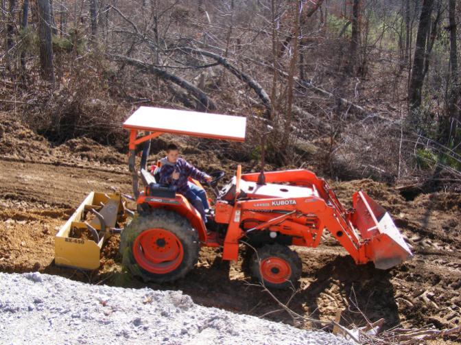

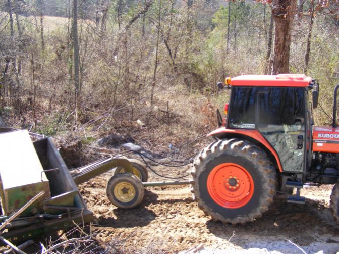

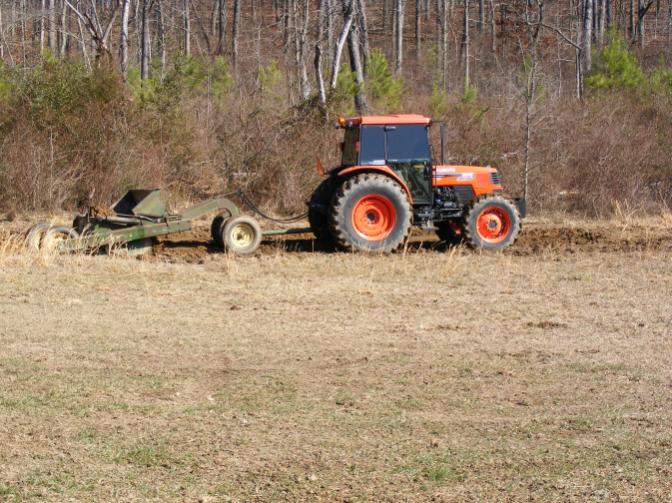

A few pics of a project last year. I filled in behind my house for a new shed to go in. I had about 500 tandem loads of waste material hauled in and we put almost 700 loads of dirt with my dirt pan. My box scrape did fine.
