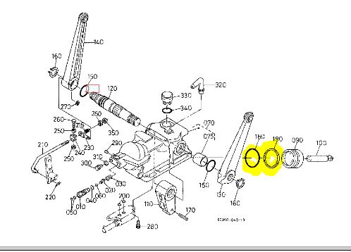

First for the good advice. I get it, not a good idea to leave weight and mass, hanging in midair. Recipe for a disaster and I'm not a big fan of disasters.
Second, I'm inclined to leave it alone. But... I do have a little ocd. What's involved in replacing the rings?
These are like Piston rings?

They are probably o-rings. I think the o-rings will have backer rings also
