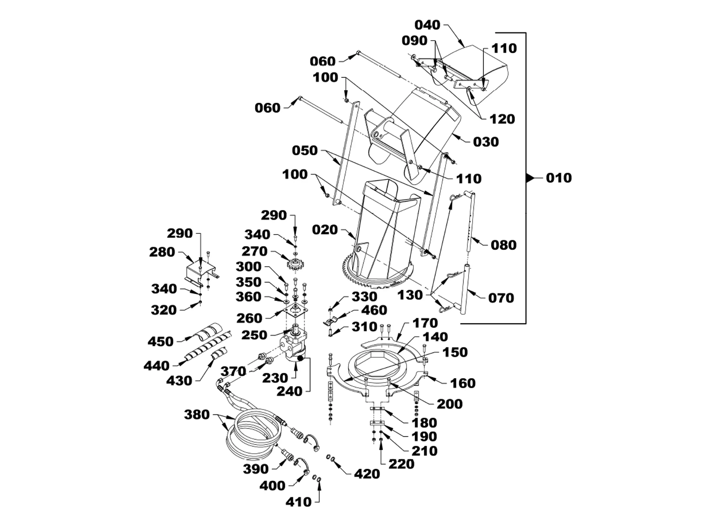

Greeensvillejay is on the right track. Look at this breakdown of the snowblower, and pay particular attention to part #80. Make sure that it doesn't have a broken bolt (part #170). You will have to remove the snowblower from the machine to check this. Then check the same mating part on the K Connect for the same problem, and report back what you find.

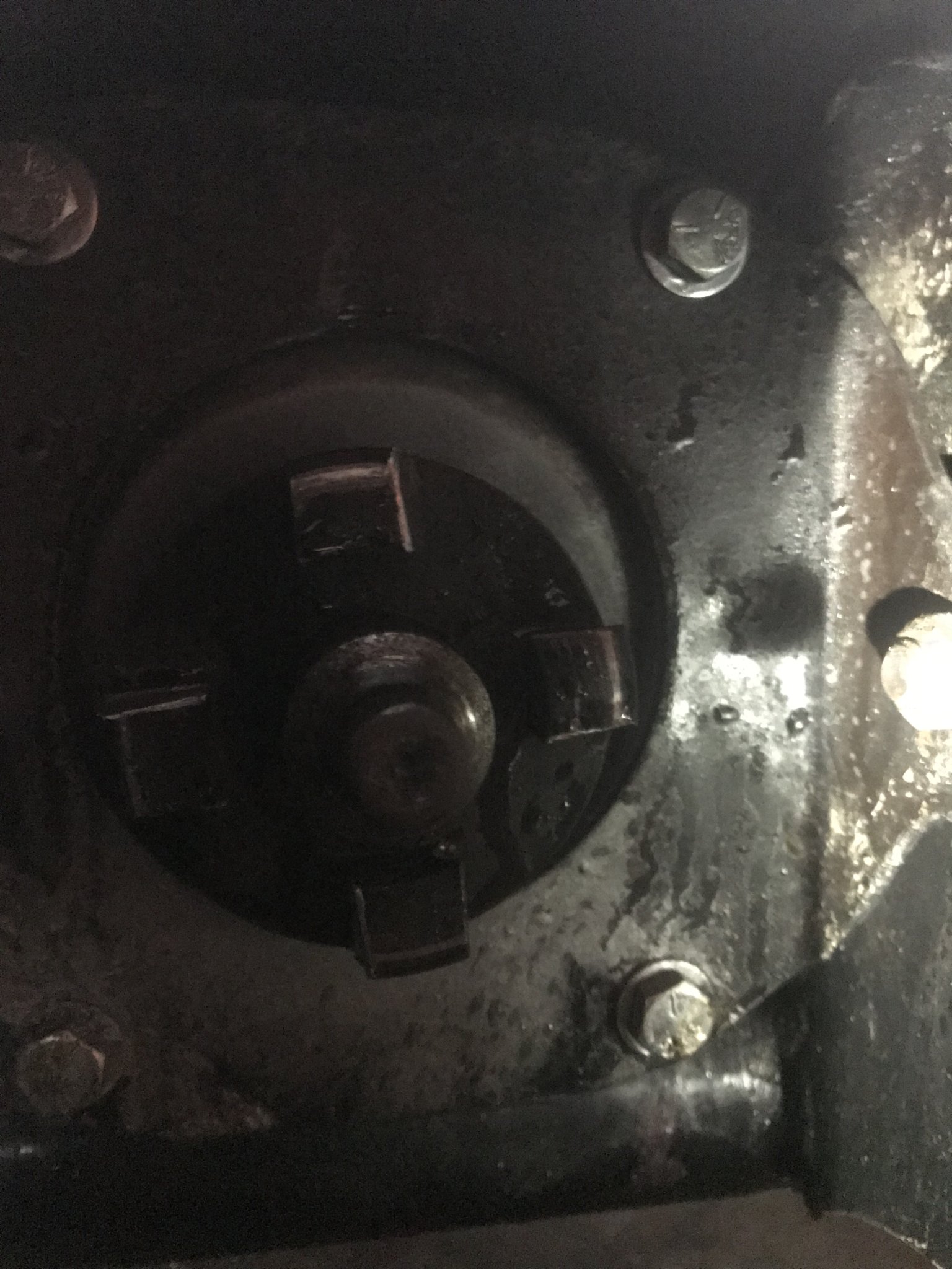

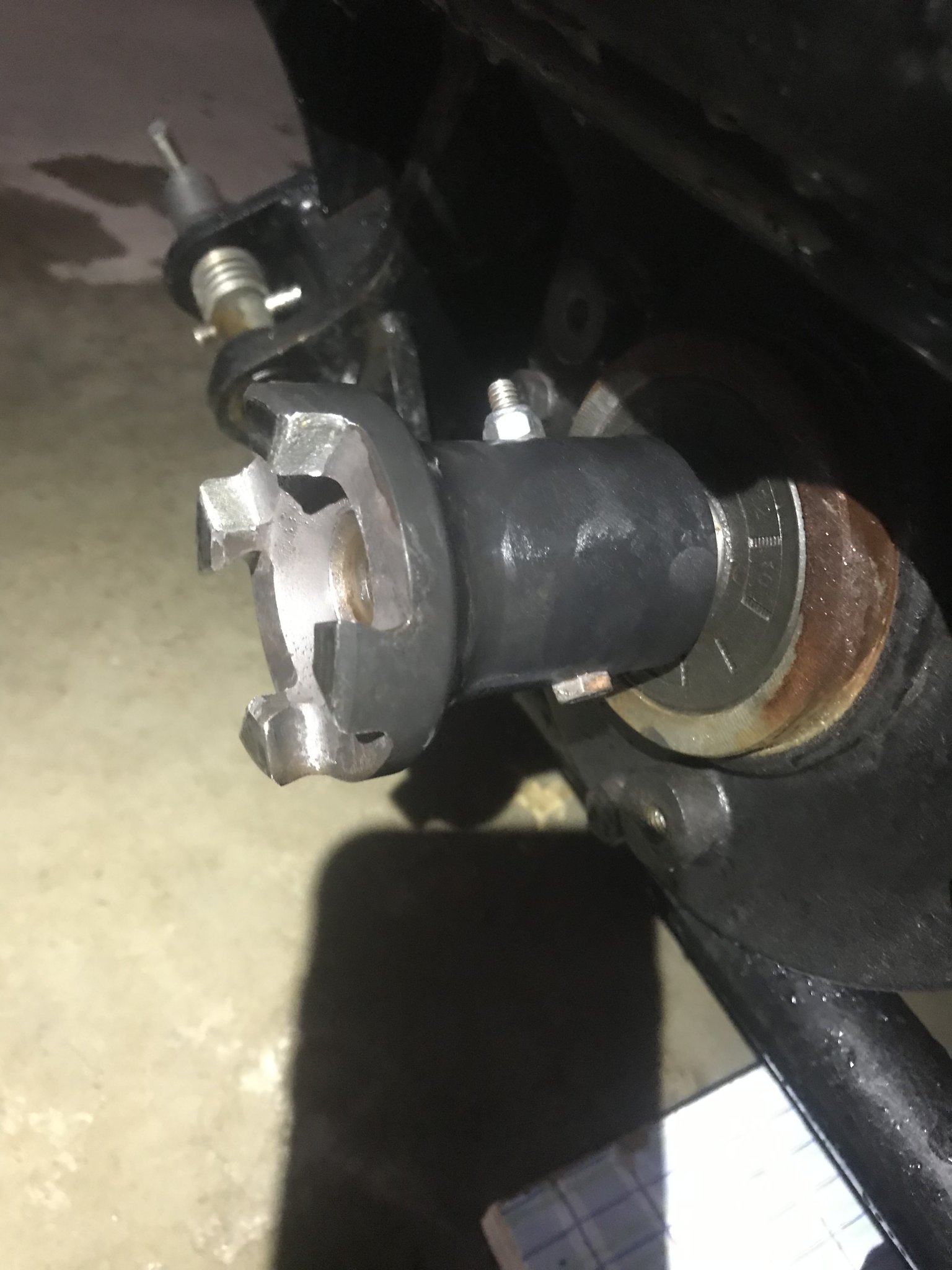

The part that moves around, up down, right left, is the way it is supposed to work. Your second picture of the mating coupling appears to be worn, but the picture is so dark that I can't tell for certain. There is no doubt in my mind that the first picture shows the coupling with wear on it. I don't know if that wear is excessive or not, but I can tell you that the part is made of hardened steel and shouldn't show any grey area.
You didn't say how old your snowblower is, so it might or might not be covered under the warranty.
This thread might give you some additional insight into your problem. https://www.orangetractortalks.com/forums/threads/lx2940-quick-hitch-manual.60868/#post-595685
I did enlarge the picture that you posted in post #9, and I tried to lighten the contrast, but a better picture would be helpful. From what I can see, it might be worn, but this is merely a guess on my part based on a picture that is difficult to read. If you can get us pictures straight on and from the side will help to determine the condition.

This thought just came to me. Did you check the shear bolt on the fan, or just on the augers? Easy to check, with the tractor off, key out of the ignition (normal safety warnings), reach into the fan, and try to turn it. If it turns easily, then the shear bolt in the fan is broken. It is part $260 in the diagram below. This is a common part available almost everywhere that sells bolts. BOLT HEX GR 5 PL- BOLT HEX. 3/8"NC X 2" LG GR.5

I agree that the coupling looks very worn. Mine is new and the design of the coupling has angled mating surfaces that draw the coupling together when turning force is applied. If there is enough wear in the entire assembly it could easily slip and cause noise. I think these two pieces should be replaced.
