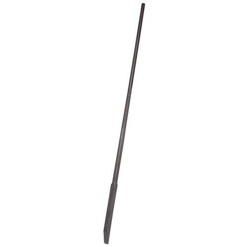

I use a five foot rock bar. Been doing it this way for 30 years after a truck mechanic showed it to me as a young helper.
Lay the bar on the ground with the end lined up with the axle end. And 90 degrees to tractor.
Put a board or something under the outboard end to raise that end of bar up about an inch or two.
Roll tire onto bar getting highest lug lined up (best you can). Tire is more or less balanced and Center on bar. And close as possible to axle end.
Then one hand holds (balances) top of tire as other hand raises bar (class 2 lever) and moves it left and right slightly to get that top lug aligned.
Put a nut on it, move bar around to get a 2nd one and down hill from there.
The block under the outboard end you ask? In order To get your fingers under the bar with a heavy ass tire sitting on it!
