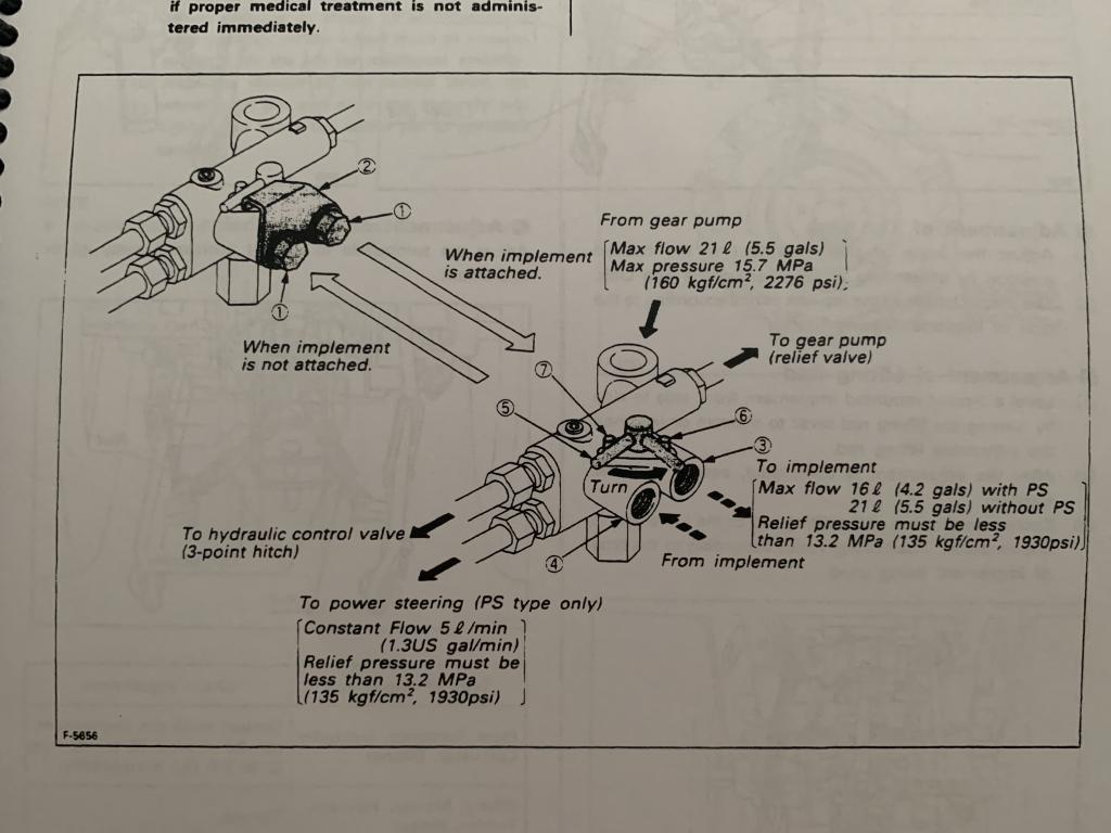

I’m looking into adding two rear remotes to my B1750, cheaply. I can make my own hydraulic lines and mounting brackets, and was planning on digging through the tractor scrap yard for the shuttle valves.
My hydraulic knowledge is all industrial, I don’t fully understand the power beyond circuit. My tractor does not have a power beyond port, just a supply and return. If I find the valves I like but they have a power beyond port, can I just plug it?
In your opinion, what would be the best valve setup? Hydraulic top and tilt are high on the wish list, so at least one with float.
32,851
8,337
Power beyond is made by the added spool valve.
No you can't plug it, it needs to be piped back to the feed for the three point.
You will need to add a return to the system as you don't have one right now.
The only thing the system has is suction and power, no return.
