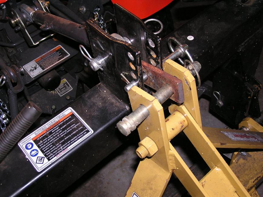

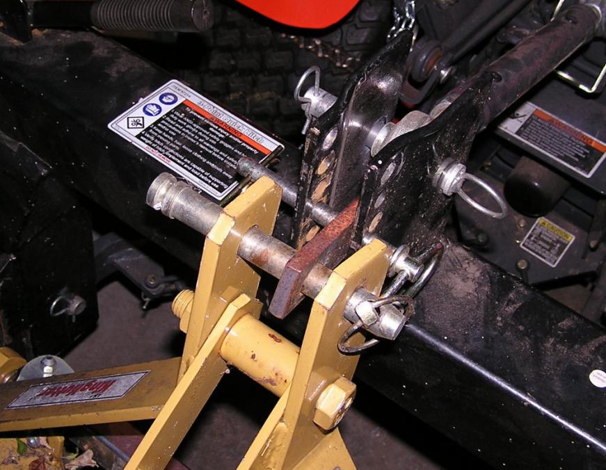

There is no usual need for the hook that comes with it for most equipment. See attached photos for a simple method with strap steel. You can see there is plenty of adjustment for heights of different attachments.
For most of my attachments I don't bother with the exact diameter for the pins at the lower two places and don't seem to have any trouble with that sloppyness.

One more reason for not using the top hook. Look at the rear plow thing in photo above. The hook would have to be juggled into the opening under the pin and then re-attached to the holes in the QH and then might not fit well.
Actually, the top hook of the QH is supposed to attach to that lower bolted connection point, (the one that looks like it just holding the 2 sides of the upright together) not the normal top link point. That's why it is sleeved to fit the top hook. No juggling required.

RBA:
Maybe so. However, the "King Kutter" rear blade guys didn't seem to know there is the QH with a top hook and so the spacer pipe OD is somewhat larger than the opening of the hook. Also, they slant the vertical bars such that they tend to interfere with the top "plates" of the QH, making an easy from the seat connection not that easy. Regardless, the QH makes the connecting up much easier than the methods needed without the QH.
The photo is of the BX and its blade. I have a larger blue tractor with a larger blade at my cabin. That "King Kutter blade parts are so slanted that there would be even more interference. I'm thinking of getting out the torch and change that blade's parts.
